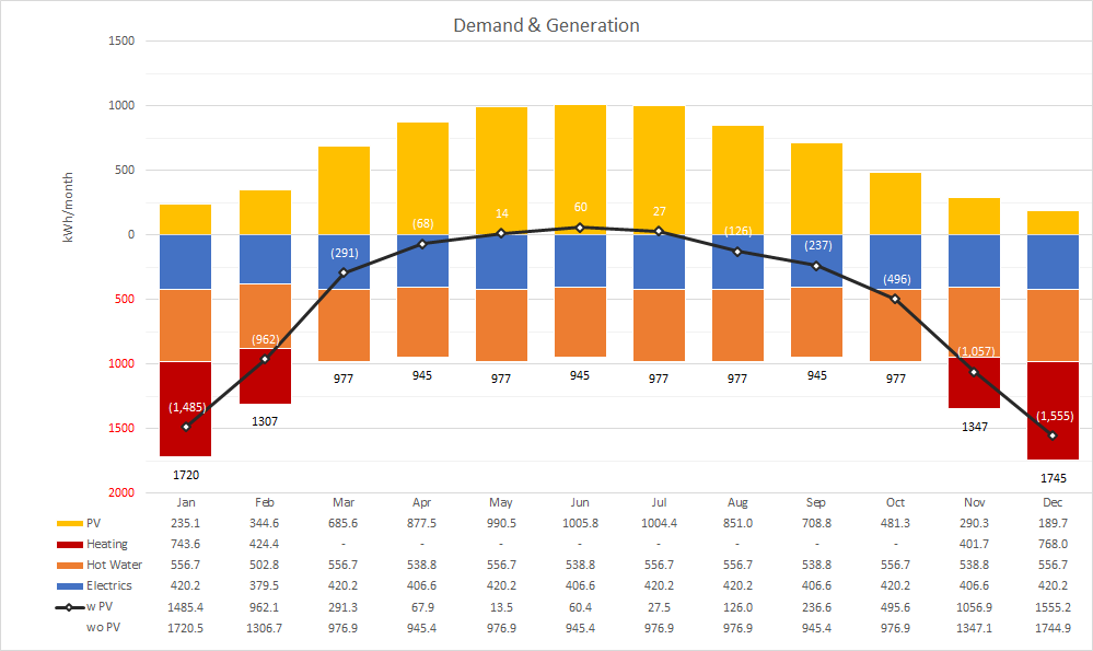

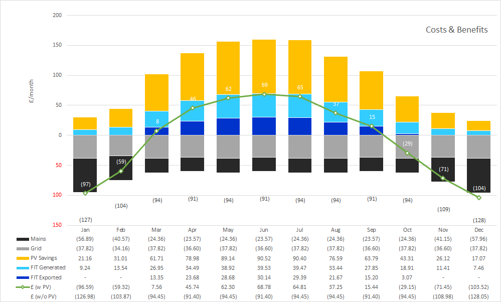

It has taken me a long while to be convinced that PV was economically worthwhile, but now that we have the energy model near complete for our house it's become a no brainer. So I thought I'd share my findings.
This assumes a FIT installation with Generated and Exported rates of 3.93 and 5.03 p/kWh for a 9kW system. I've not yet tried the cheaper installation of a non-FIT version which is often quoted as a better alternative. Perhaps I'll have a go at modelling and comparing that too in the near future.
I've made my Energy Model available for anyone interested; get it here.

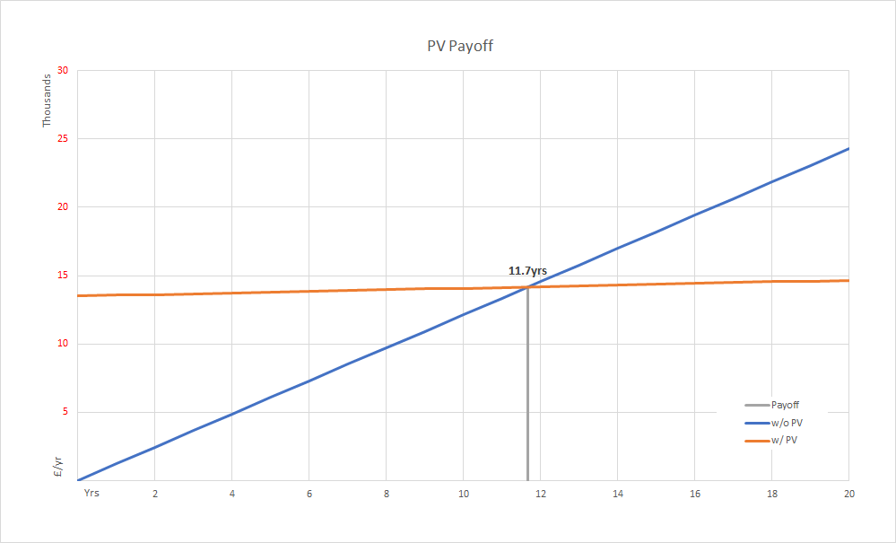

The following charts show the quickest return to payoff of the PV system and lowest annual outgoings. Had to use Mains Gas for Heating and DHW, through these can be toggled to electricity in the model.
It is a no brainer, but then I paid in another FIT cheque yesterday for the winter quarter and that was £150, more than it cost to heat the house through all this cold weather by a significant amount.

I maintain with today's low FIT you need to WANT PV and be happy to spend the capital as just another part of the build.  Otherwise if you look at it purely as a money exercise, the big question is "what if we sell before 11.7 years?"  It will by that measure have been a "bad" investment.
Fair point! We're building to stay, so the assumption wasn't when we'd leave, but how long it'd take. But you're right, who knows how long we'll be and whether we're investing in the next home owner!

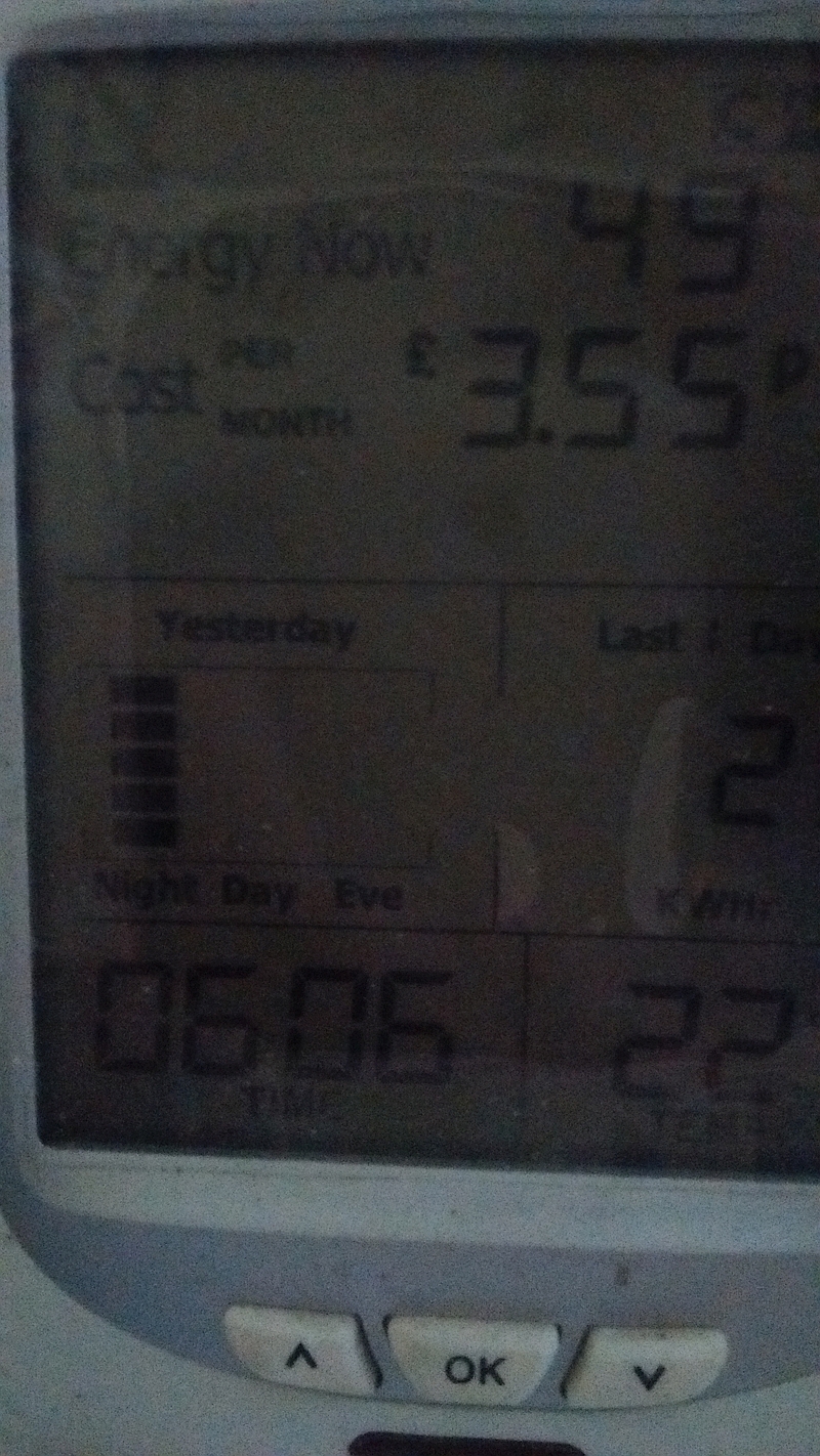

For the last two days I have used less than 0.5 kWh during the day rate period (since I have got my new DHW cyclinder).
So I would be better off getting a couple of kWh of storage as the unit cost would be 17p/kWh.
Having said that I cam currently using about 25 kWh/day, so I have a bit of tinkering to do on the DHW temperature and heat losses, and the one night storage heater I am using to get my usage back down to my target of no more than 10 kWh/day.  I have been a bit lazy about this, this year.  The secondary cylinder lagging is going back in place today.
