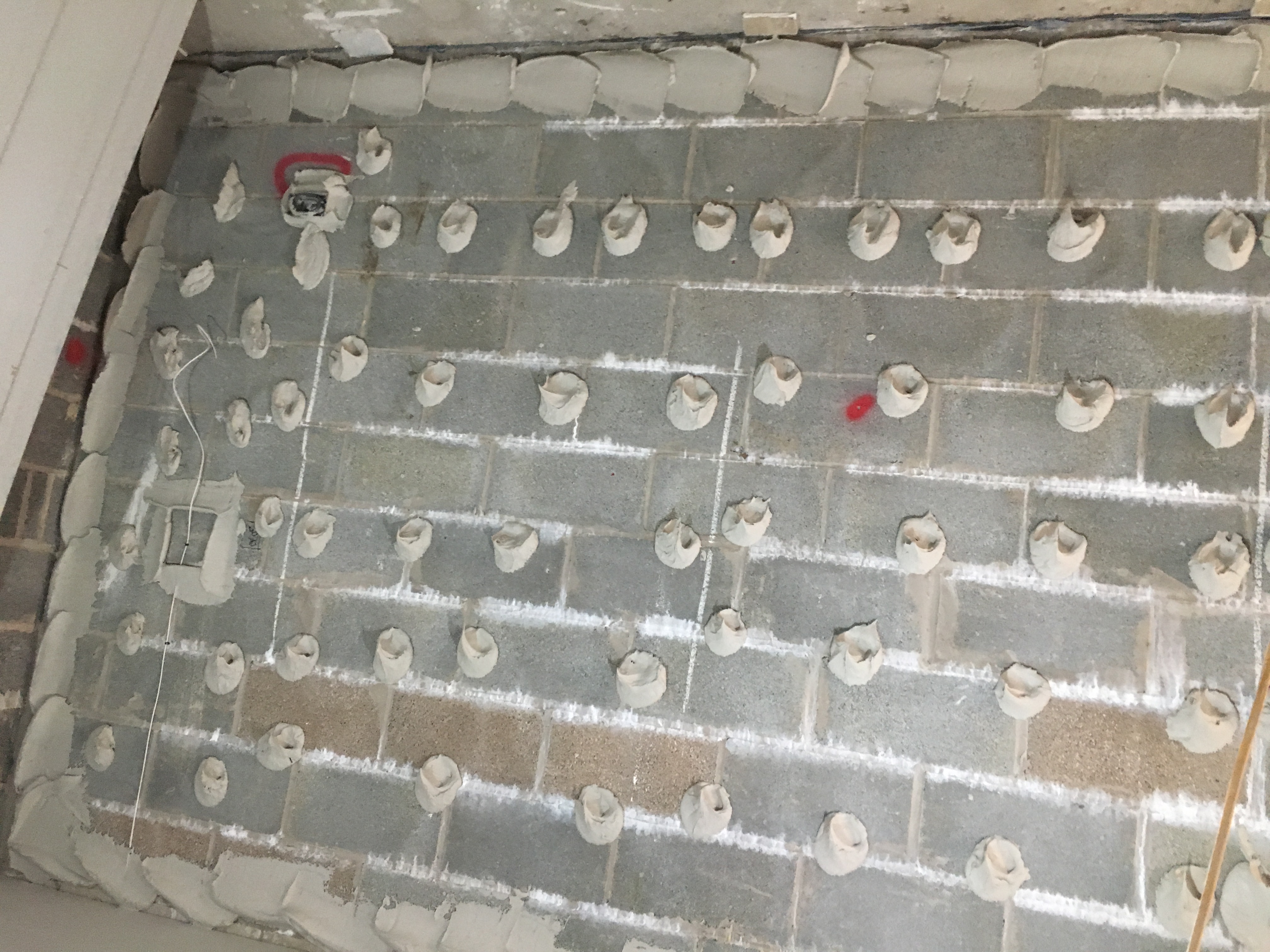

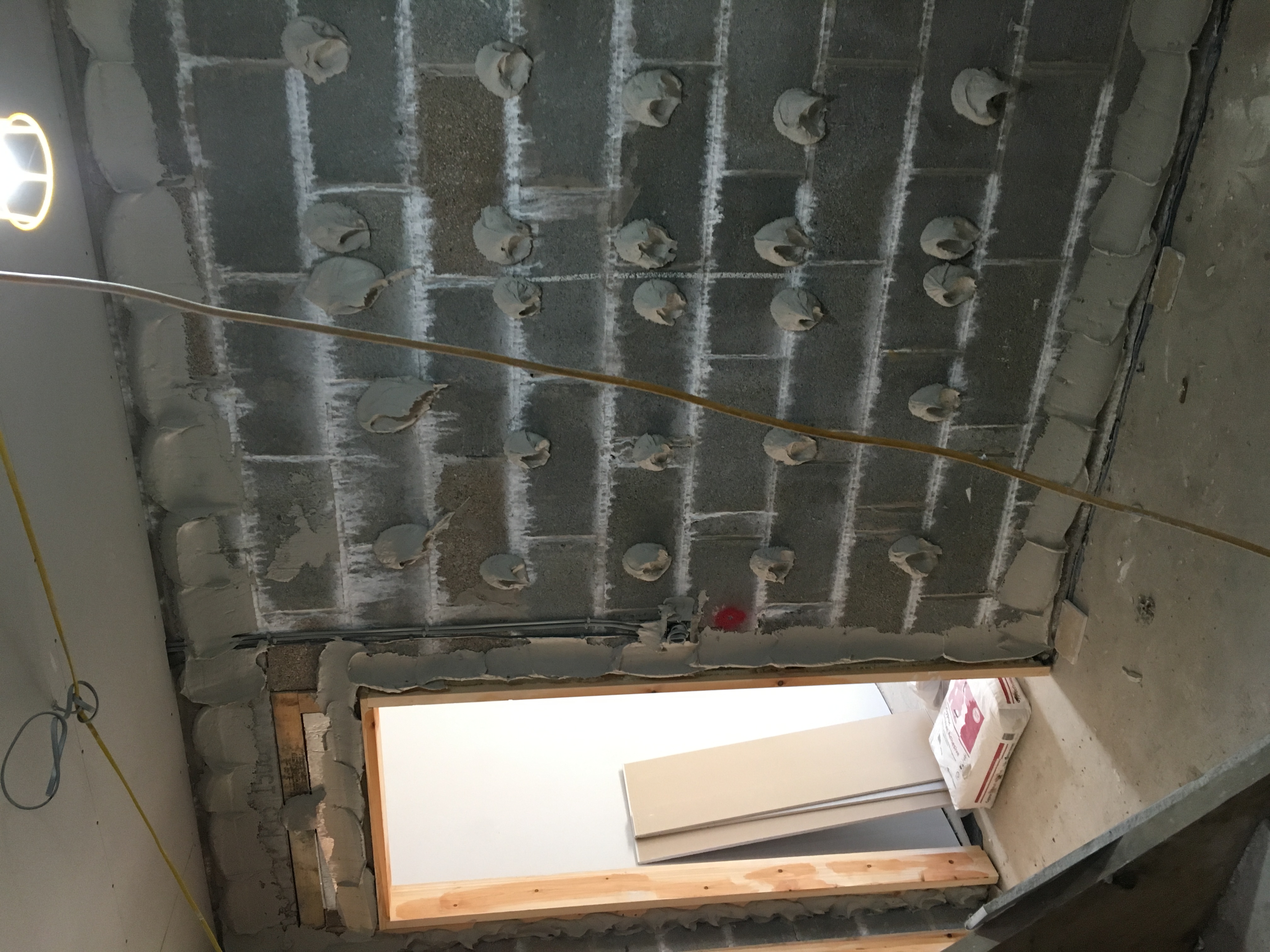

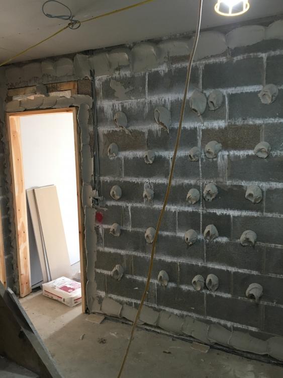

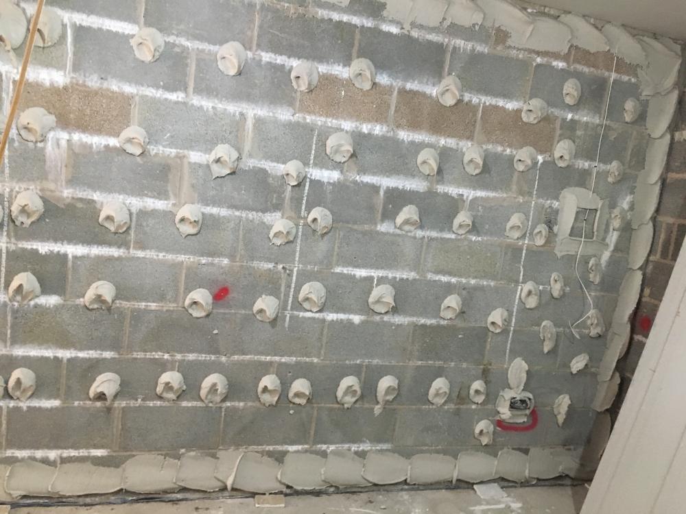

nod Posted March 24, 2018 Posted March 24, 2018 I’ve made a start on the dabbing today To those who already know this ignore this post But we’ve had a few questions about air tightness and foam on block Ive taken a couple of pictures If you are paying a contractor to do this and it is any different than pictured Your not getting what you have paid for and air tightness will be an issue further down the line Skirtings are decorative and shouldn’t need to be bunged up with foam 1 1
Jeremy Harris Posted March 24, 2018 Posted March 24, 2018 You must be one of the tiny minority that put a decent peripheral run around the edges - 99% of dot'n'dabbers don't, and just create a plasterboard tent inside the house, with cold air able to get behind the boards easily. Mind you, with no parge coat on the inside you're still going to get some cold air infiltration through the masonry, as it's generally pretty porous.

nod Posted March 24, 2018 Author Posted March 24, 2018 3 minutes ago, lizzie said: I'm looking at getting dot and dab done in the garage to use up a lot of left over plasterboard......I have never seen an example of dot and dab before so very timely thank you. Thanks Lizzie As jerremy says most bother and cold air circulates right around the house Under skirtings and kitchen units Ive been doing this for 35 years it really doesn’t take much more time to do it right Much easer to straighten and fix to 2
