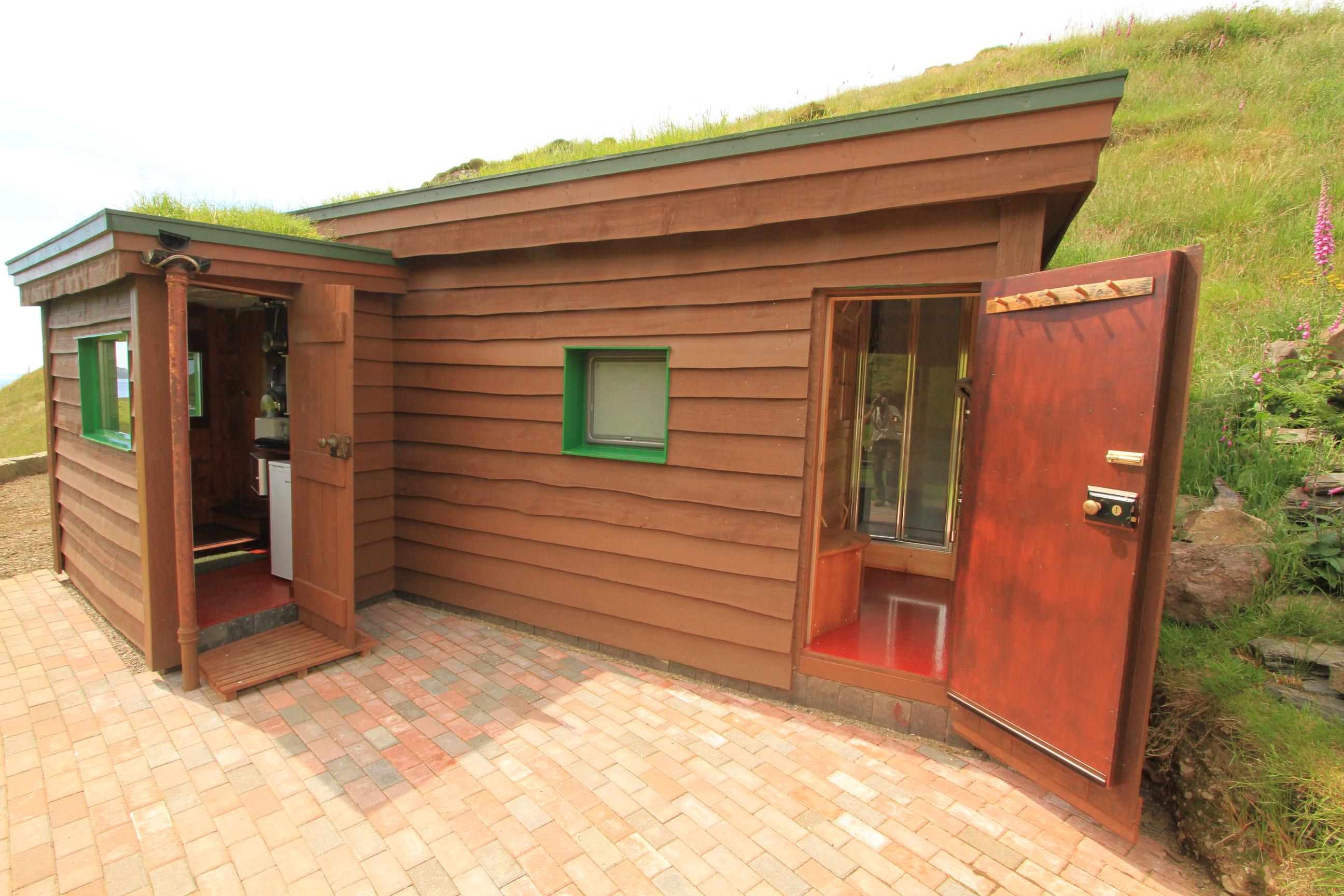

We've finally settled on our roof finish and have decided that a corrugated roof is right for us, it suits our agricultural location and we like the simplicity of the design.  I am now trying to refine the detailing however I am struggling to find slim, neat trims for the edges of the corrugated metal sheets. I'm trying to avoid large barge boards/trims (as shown in image with black roof) and instead would like slender profiles as used by Dualchas.
I am thinking of using a dry verge product by Kytun, usually used for slate tiles, in black to match the corrugated roof -http://www.kytun.com/p/slate-dry-verge-t2-aluminium-pack-of-4/p-c02
Does this sound feasible or are there more suitable products available? Any help would be much appreciated!
