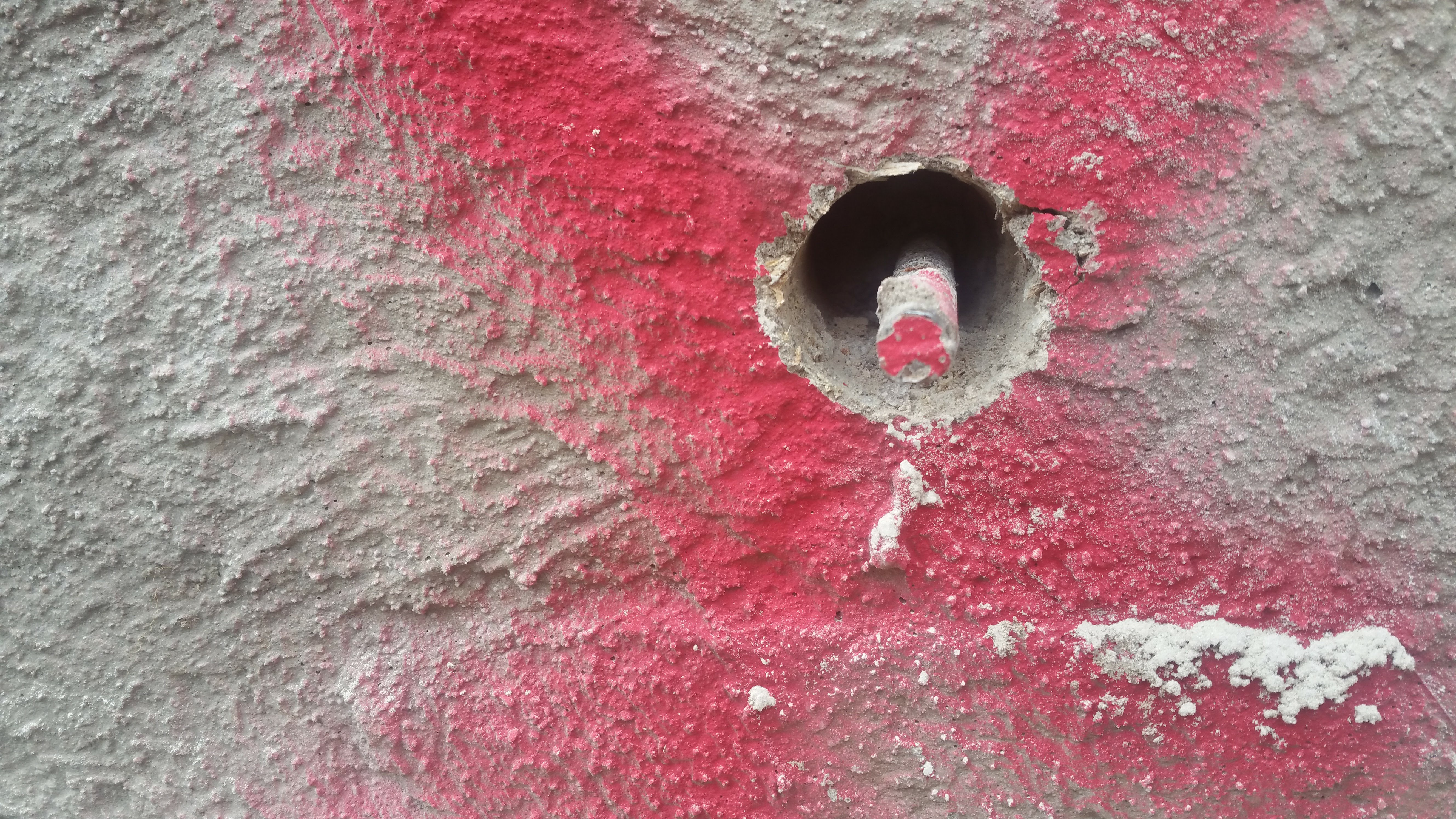

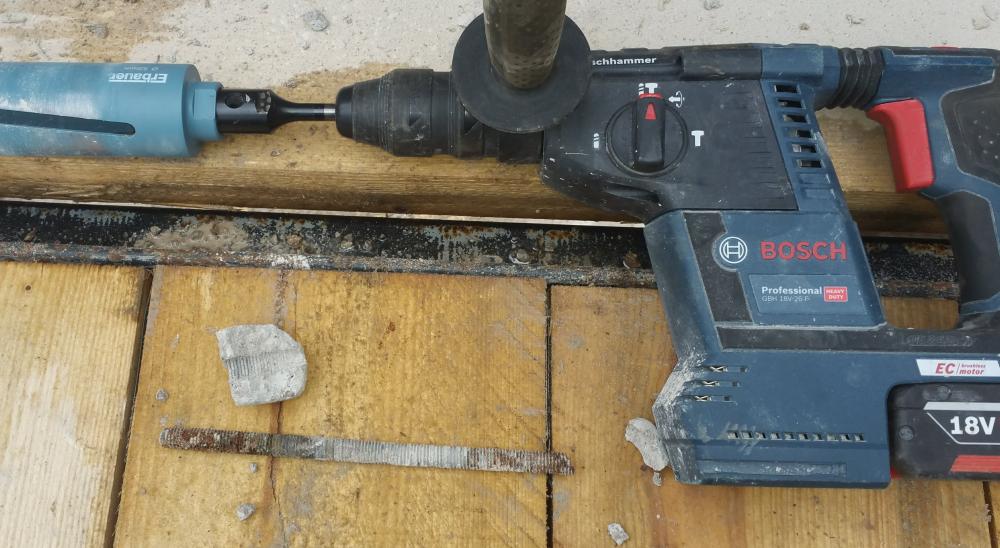

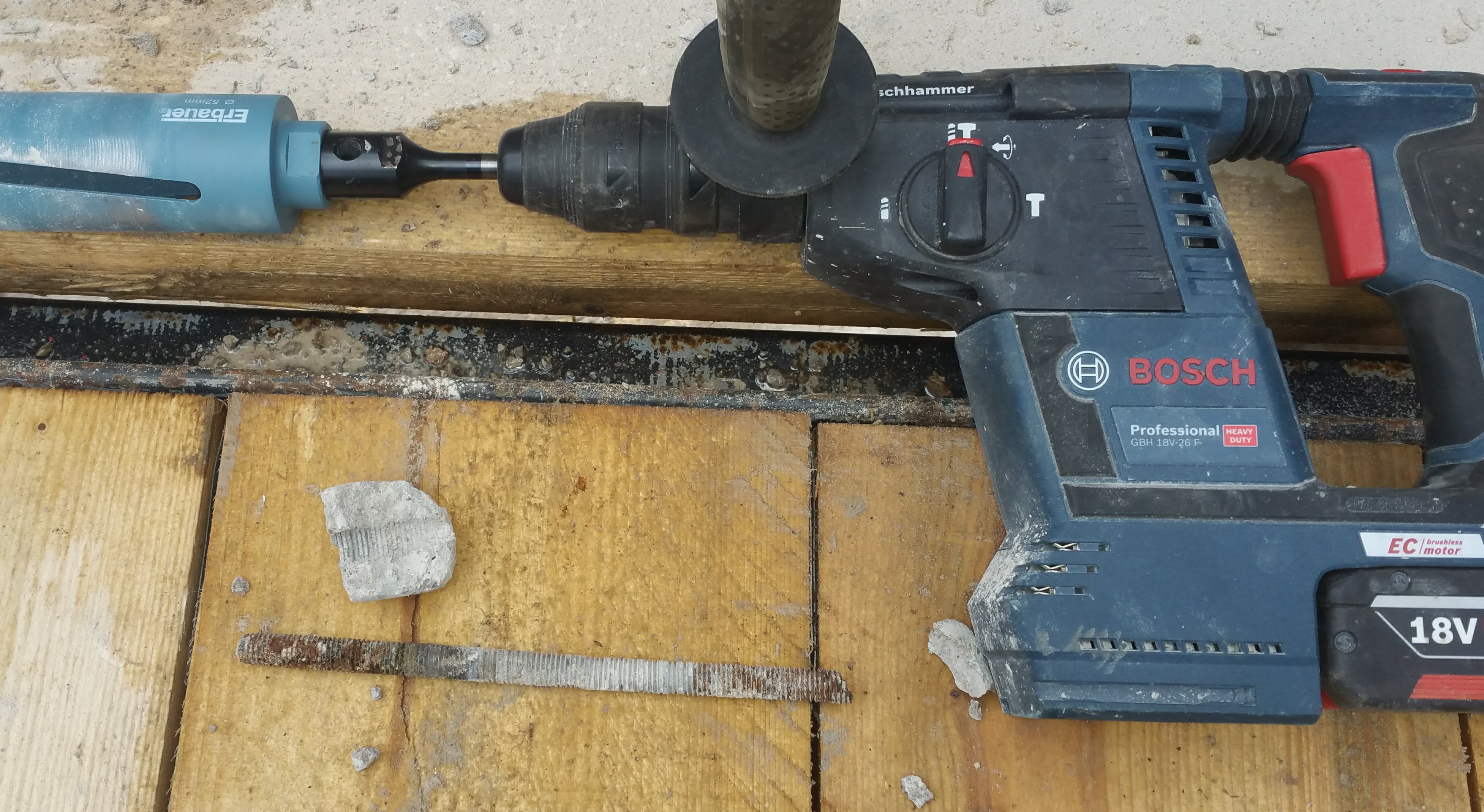

ToughButterCup Posted March 6, 2018 Posted March 6, 2018 Back in this thread, I explained how we were going about remedial works to cope with the likelihood of further poor workmanship of our original installer . The strategy relied on installing shuttering: that in turn needed to be tied in with threaded bar. Since that threaded bar was going to be immersed in concrete, those bars needed to be extracted a bit sharpish. Of the 140 odd we installed, a few stuck fast. Today the steep learning curve on how to extract those that remained. The idea was to core from the inside (concrete) from inside - outwards and then just pull the rest of the bar out of the PIR. At first, using a 25mm core, like this I found that I fouled the threaded barrel by drilling slightly off center. So, back to the 38mm core and bingo What did I learn? Don't use a diamond core bit on hammer. You knock the teeth off the core bit. Shutter Durisol no matter what they say on their website. It ain't wurf it, mate, ain't wurf it. ( @jamiehamy, sit back and smile ) Sharp lessons in self-build: at least one or two sharp lessons a week at the current rate.

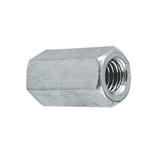

Onoff Posted March 6, 2018 Posted March 6, 2018 (edited) @recoveringacademic, what size threaded bar is that? Thinking that with a die nut: And a box spanner, you could re thread the damaged end. Then screw on a studding extension: Add a bit of studding, drill a hole in a spreader timber and have another go at winding it out. Edit: Have I read this wrong? The studs are already out? Edited March 6, 2018 by Onoff
ToughButterCup Posted March 6, 2018 Author Posted March 6, 2018 1 hour ago, Onoff said: @recoveringacademic, what size threaded bar is that? Thinking that with a die nut: And a box spanner, you could re thread the damaged end. Then screw on a studding extension: Add a bit of studding, drill a hole in a spreader timber and have another go at winding it out. I really appreciate it when members think with me. We tried that, @Onoff, and it worked - to an extent. We also tried three other ways. Sometimes it didn't work with any method, and we had to get on with other stuff. Now we face the challenge of extracting threaded bar from fully cured concrete by a self-build enthusiast who has never before used a core drill made a safe working platform at that height out of kwikstage (and appropriate fall prevention precautions) tends not to read instructions How hard can it be with that mix of online readers and a just-bloody-do-it approach? Just for the record, I went to Screwy's and told them about my Erbauer core drill set. At their suggestion, they replaced the whole set , no quibble, and in addition gave me a £5:00 credit. So I bought a scaffolder's magnetic level as well. I know SF come in for some stick, but replacing a complete set of core drills without even the beginnings of a quibble is first class. Well done ScrewFix.
