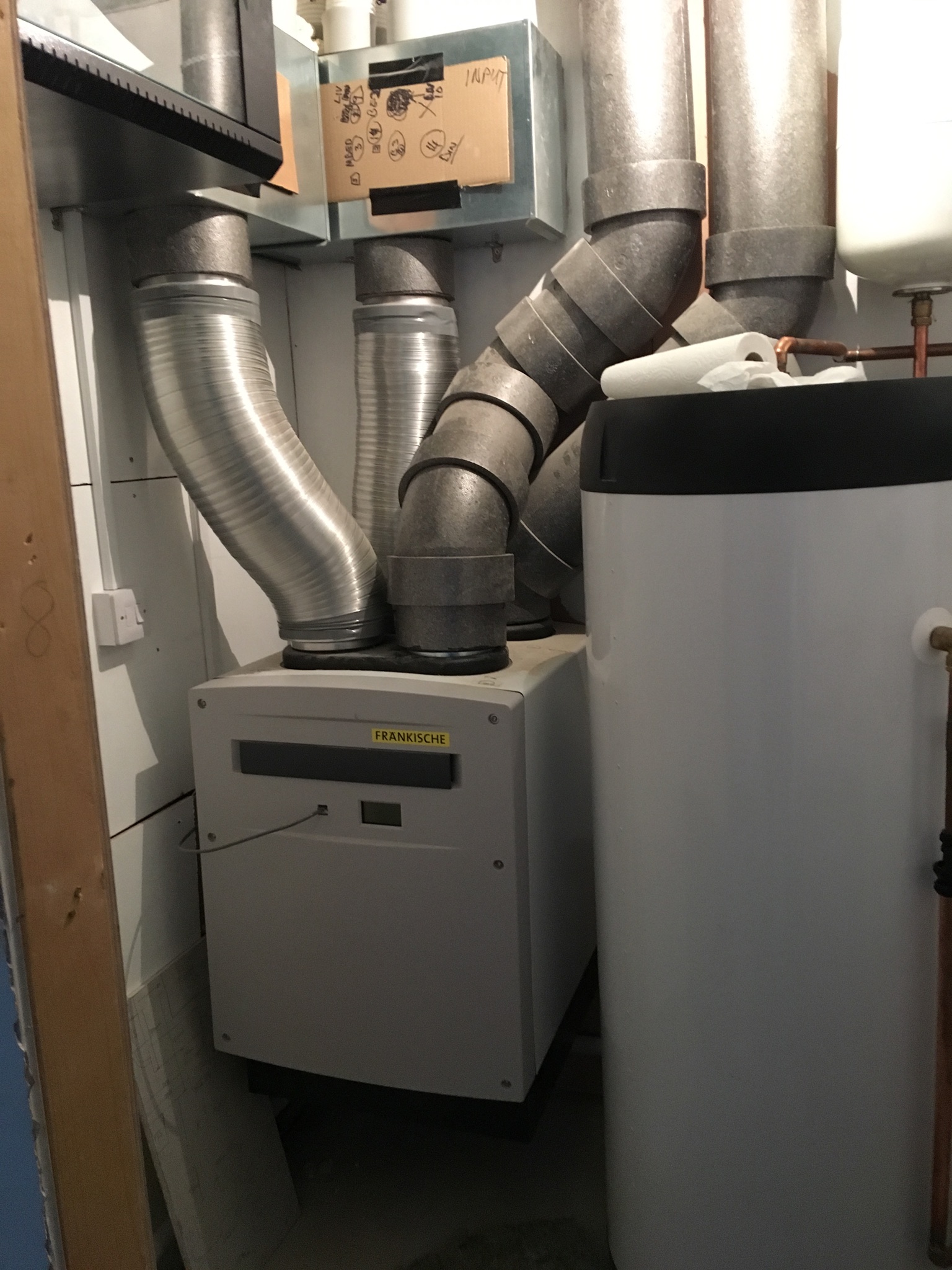

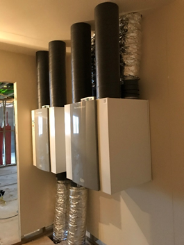

I see lots of photos posted on here of various MVHR systems, they all seem to have some form of silver foil wrapped round the big pipes coming from the unit. I have no silver foil on mine.......please what is its purpose and do I need it.
System is due to be commissioned in a couple of weeks so if I need to ask a question of the installer its the time to do it.

Thanks @ProDave thought it must be to do with insulation .
I seem to have 2 pipes that look like expanding metal and two that look like grey polystyrene........

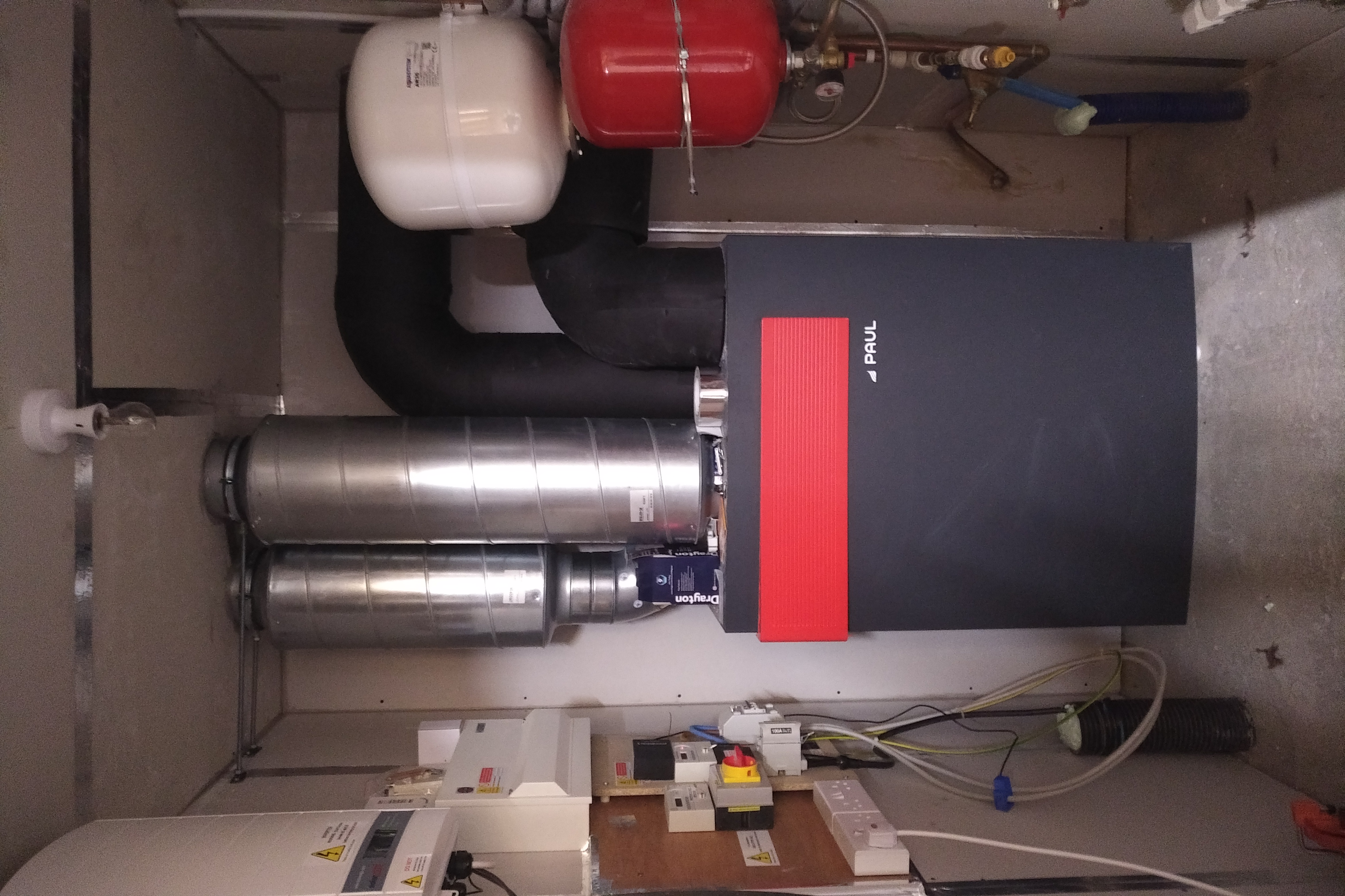

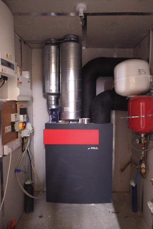

These are my units from the stage 1 install, the foil like ones are actually silencers going to the manifolds, which have acoustic dampening in also, the black stuff is EPS ducting and leads to the outside world.
On my blog there is a picture of them now fully plumbed in and running, even the one at 275m3/h is fairly quiet, audible in the plant room but nowhere else.
