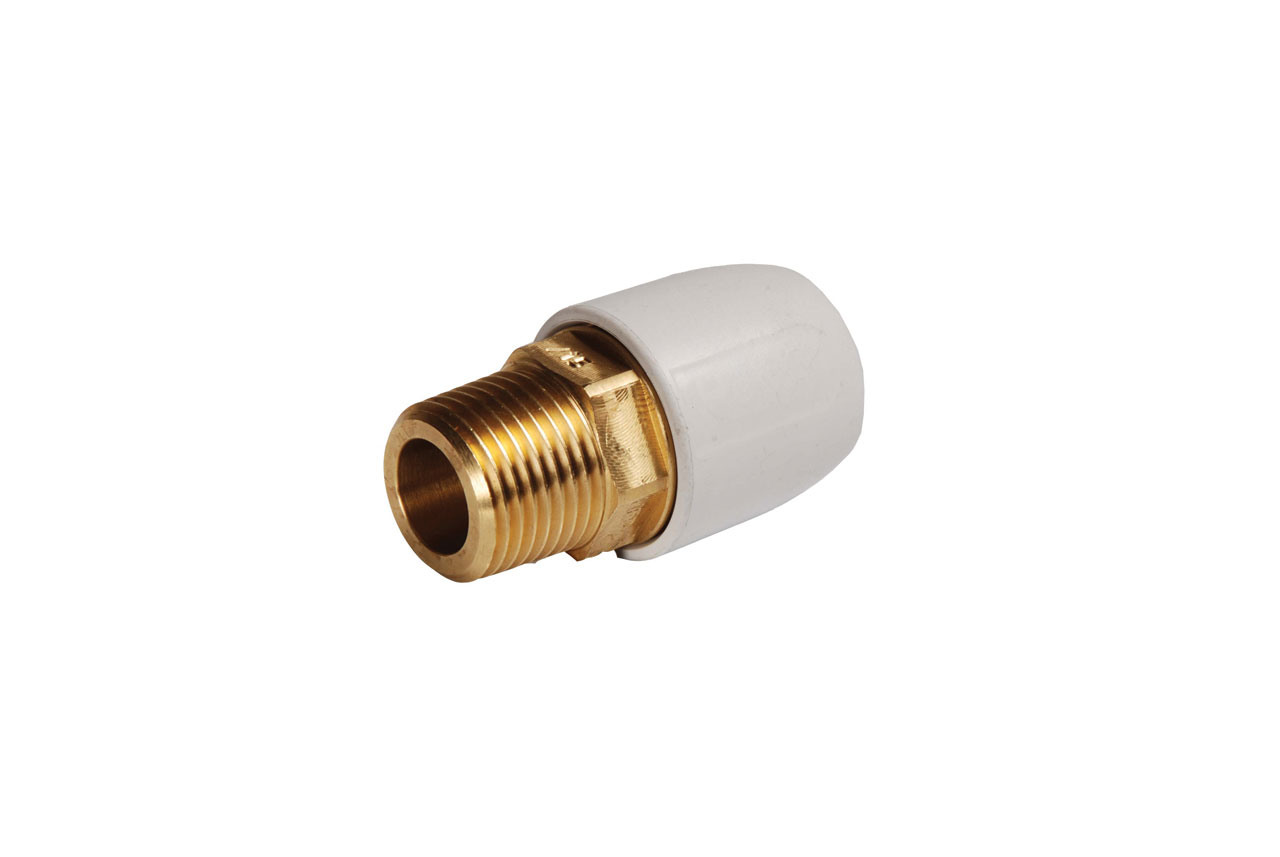

Barney12 Posted February 21, 2018 Posted February 21, 2018 This is probably a question for our resident Welsh Pipe Snuffler @Nickfromwales but all views welcome! Manifold based plumbing so no need for 'local' isolation of h/c tap feeds. Wall mounted basin. Lean, mean, clean and minimal. So what to do with the tap tail connections? There is no need for angled isolation valves or fancy chrome wall isolators (European stylee). I was thinking either: https://www.victorianplumbing.co.uk/fast-fix-kit-bracket-for-bar-shower-valves-efk001?campaign=googlebase&gclid=EAIaIQobChMI3qfIpZq32QIVRDqBCh3iAgFDEAQYCCABEgIubvD_BwE&gclsrc=aw.ds and simply tile round them and then screw the tap tail to it. Or: https://www.screwfix.com/p/flexible-tap-adaptors-15mm-x-2-pack/2665r and just lose the entire fitting the other side of the wall? The negative to that idea would be maintenance of the tap/connection. Thoughts?
JOE187 Posted February 21, 2018 Posted February 21, 2018 https://www.ebay.co.uk/itm/Radiator-Pipe-Collars-White-or-Chrome-Plastic-Covers-10mm-15mm-22mm-28mm-35mm-42-/151261994424?_trksid=p2349526.m4383.l4275.c10&var=450332053667 I would bring 10 0r 15mm pipe through tiled wall and use a cover as above to keep tidy then use BES straight adaptor to chrome flexi. Something like 10mm compression to 3/8 or 15mm to 3/8 male parallel thread. Part no 6664 or 6670
Nickfromwales Posted February 22, 2018 Posted February 22, 2018 The shower fixing kit is to 3/4" BSP anyway, so no good for a basin unless you bush them down to 1/2" Just use some of these 10mm x 1/2" adaptors and screw the flexes straight on.

Nick Laslett Posted May 6, 2023 Posted May 6, 2023 On 22/02/2018 at 00:38, Nickfromwales said: The shower fixing kit is to 3/4" BSP anyway, so no good for a basin unless you bush them down to 1/2" Just use some of these 10mm x 1/2" adaptors and screw the flexes straight on. Wavin have changed the URL for this link. New link https://www.wavin.com/en-gb/catalog/Potable-Water/Plumbing-Systems/Wavin-Hep2O-push-fit/Hep2O-Brass-Adaptor-10x12-PFTM Hope this is helpful. 1
