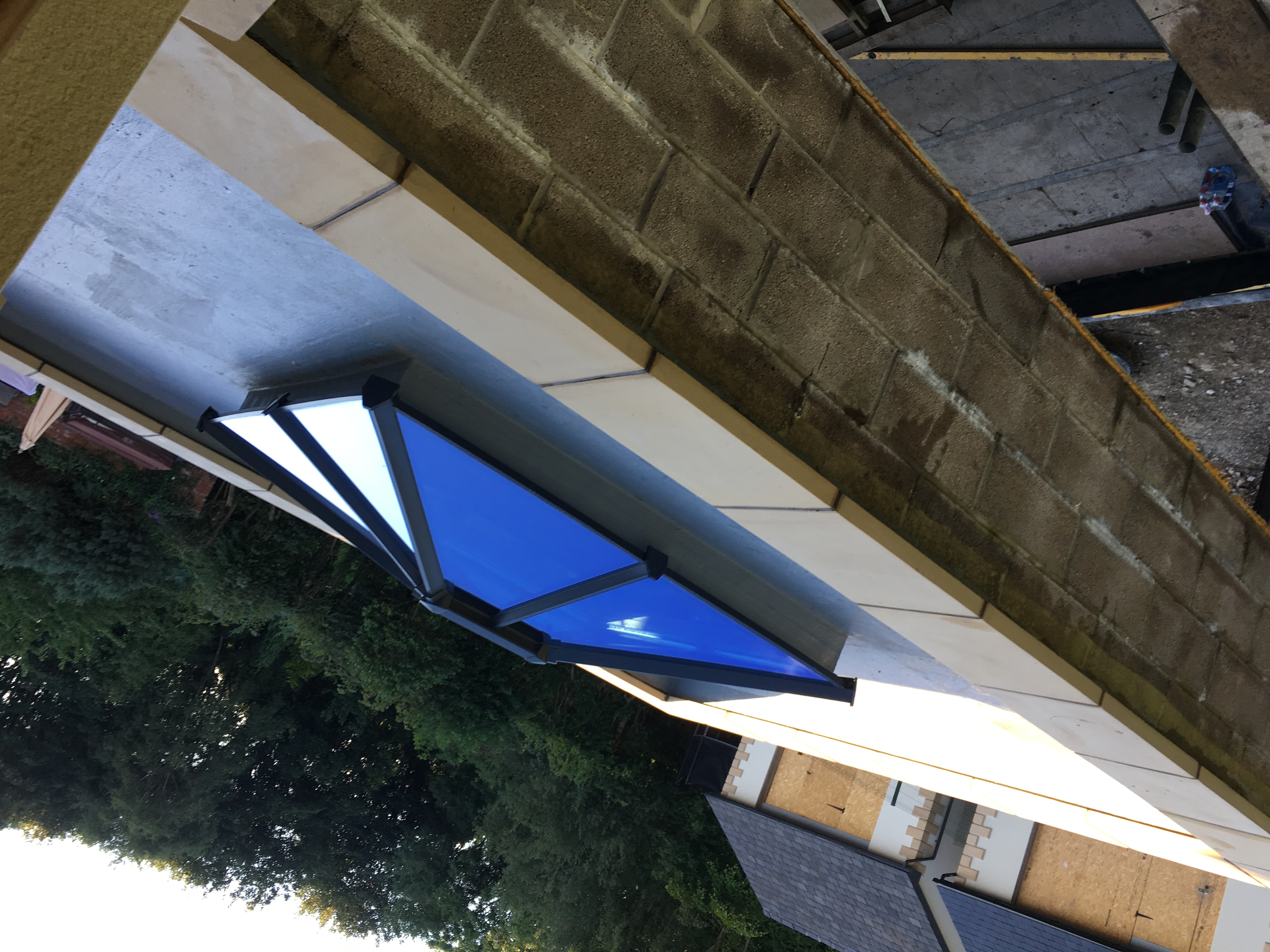

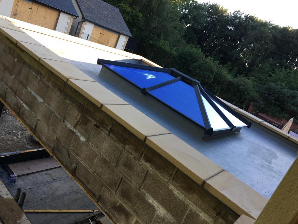

I have also just put a fibre glass roof on my kitchen, very impressed with the robustness of it after it being on for a year
easy enough to do yourself, although I have had a lot of fibre glass experience before.
Moisture is your enemy with grp, I had a large blowtorch that I kept the ply nice and toasty before any work commenced, I was doing this in December which is probably stupid,
but as our roof decided to give up a week before Christmas I had no choice.

Yeah I agree with you Russel
Brilliant stuff
I did mine last year
It does help if you have a bit of exsperiance with it
Unlike me I’m still trying to get the resin off my hands
Glad I masked the render up though
