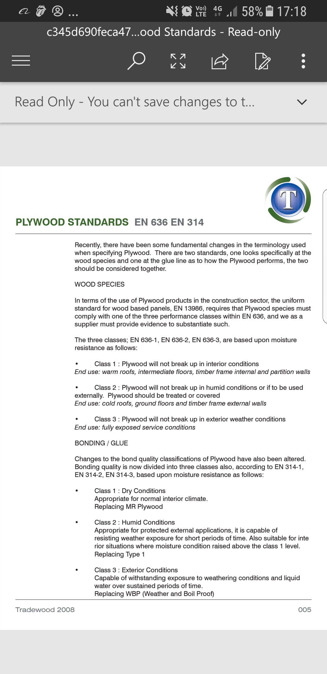

Alexphd1 Posted February 13, 2018 Author Posted February 13, 2018 Reason, quick Google on wbp ply and a few comments on not as good as it used to be and little water results in delaminating. I am probably over thinking this.

PeterW Posted February 13, 2018 Posted February 13, 2018 Proper BS STD ply is water and boil proof and will stand a lot of moisture before it delaminates. For something that’s going to be there for decades I’d suggest you go for a decent and stamped / approved board from a reputable supplier. 1

Alexphd1 Posted February 13, 2018 Author Posted February 13, 2018 Came across this for plyboard. Pretty good guide
