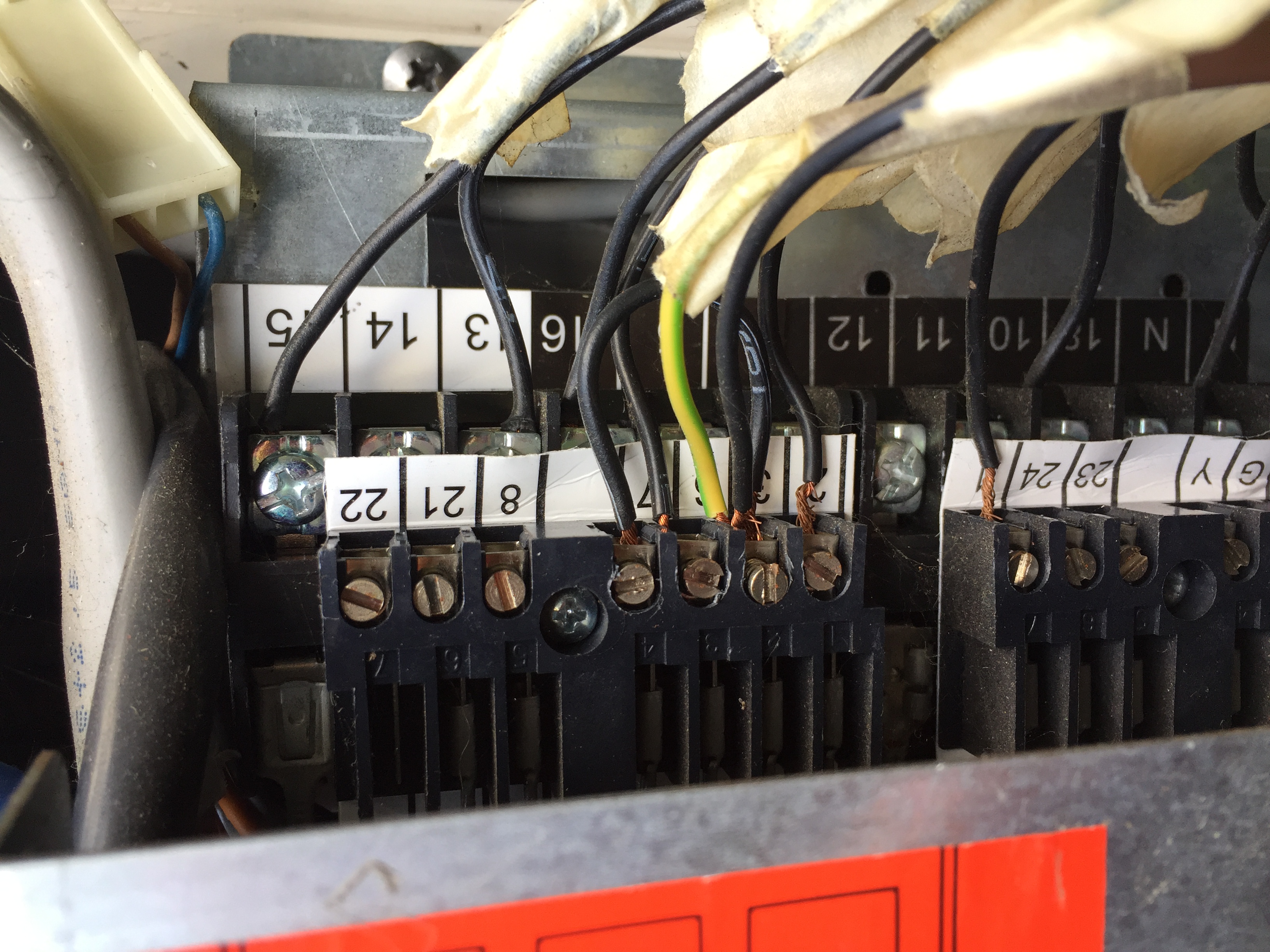

Jeremy Harris Posted February 13, 2018 Share Posted February 13, 2018 40 minutes ago, Lynford said: Right, ta. Would the trigger for the unit not come from the room stat / timer ? I’m afraid all this is a bit beyond me. The unit needs a switch that is not connected electrically to anything else wired between terminals 3 and 6 on the heat pump unit to turn it on. In order for the heat pump to operate in heating (rather than cooling) mode terminals 3 and 7 must be bridged too. These terminal numbers refer to the terminal block outside in the heat pump. They are at 12V on an isolated supply, so just a switch across 3 and 6 will turn the heat pump on and off. Often there will be a microswitch on a motorised valve that operates when the valve moves and can be used to turn on the heating. If it is wired as per the diagram in the manual, then terminals 3 and 6 should be wired directly to the thermostat and the thermostat then turns the heat pump on and off. According to that diagram, the thermostat is the only on/off control for the heat pump. You should be able to check whether or not it turns the heat pump on and off by adjusting the thermostat temperature upwards and seeing if the heat pump comes on. You will probably hear a click in the thermostat as it goes above the set point. If you hear the thermostat operate, but the heat pump does not turn on, then that indicates a problem somewhere with the low voltage wiring between the thermostat and the external unit. You can bypass the thermostat (with the external cover of the heat pump removed, (bearing in mind the caution about there being live connections exposed) by connecting a bit of wire between terminals 3 and 6, making sure terminals 3 and 7 are linked. Doing this is safe, as those terminals only have at most 12 V on them, Link to comment Share on other sites More sharing options...
Lynford Posted February 13, 2018 Author Share Posted February 13, 2018 That’s brilliant, thank you. This gives me a few things to try / check. As I said before, I’ll take some bootlace ferrules up next time and tidy all that messy wiring in the pump. Some of the connections didn’t look great, maybe a wire slightly hanging out / not done up properly could be at fault ? I can check that 3&7 are linked together, and if necessary link out 3&6 to try and start the pump. Also if I take my meter up, using a length of cable I can bell out the wire between the unit and the wiring insdoors to make sure all is well there. Thanks again Jeremy Link to comment Share on other sites More sharing options...

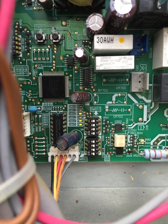

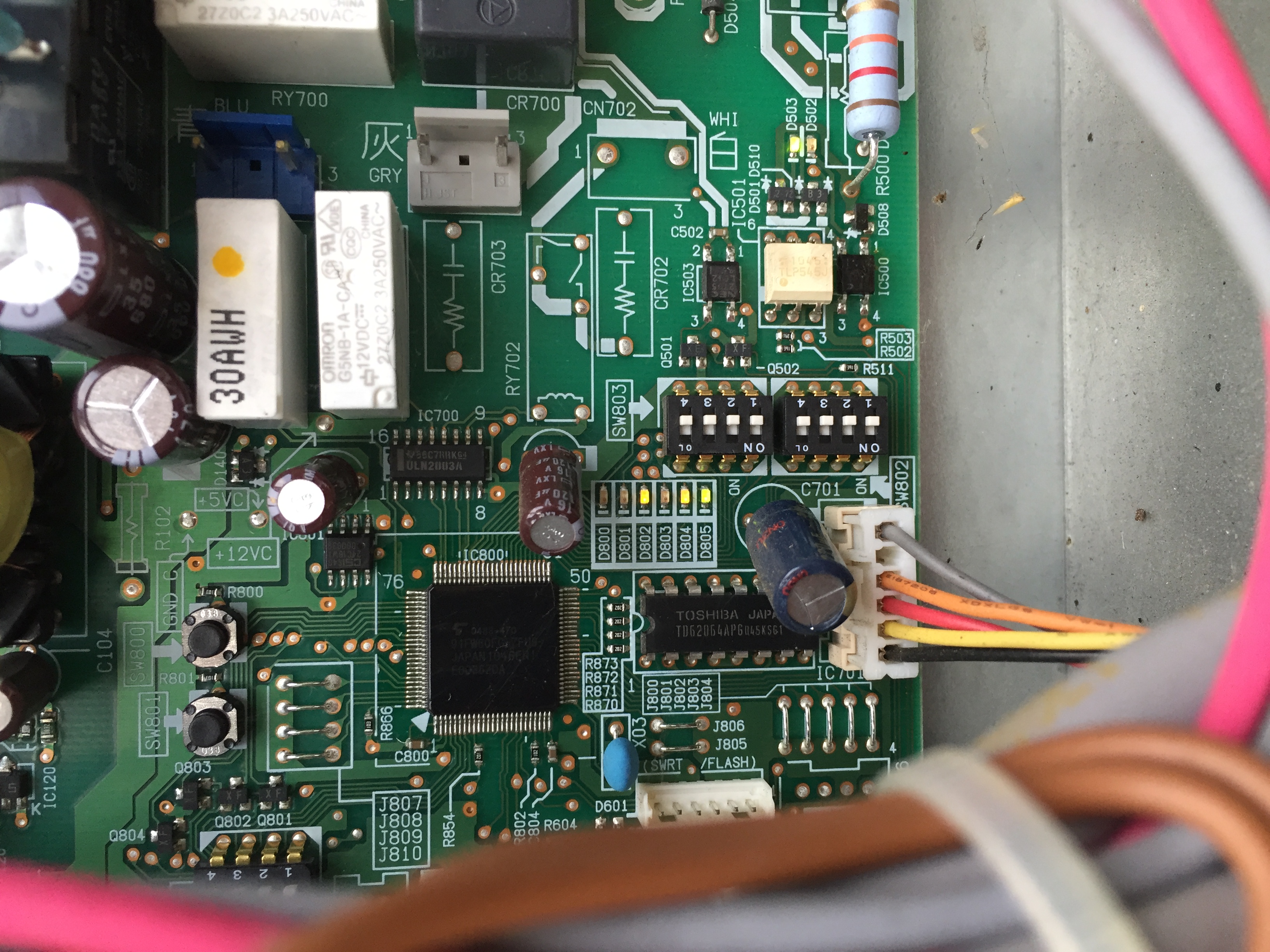

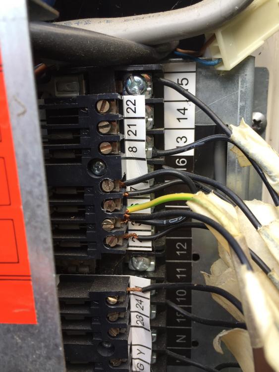

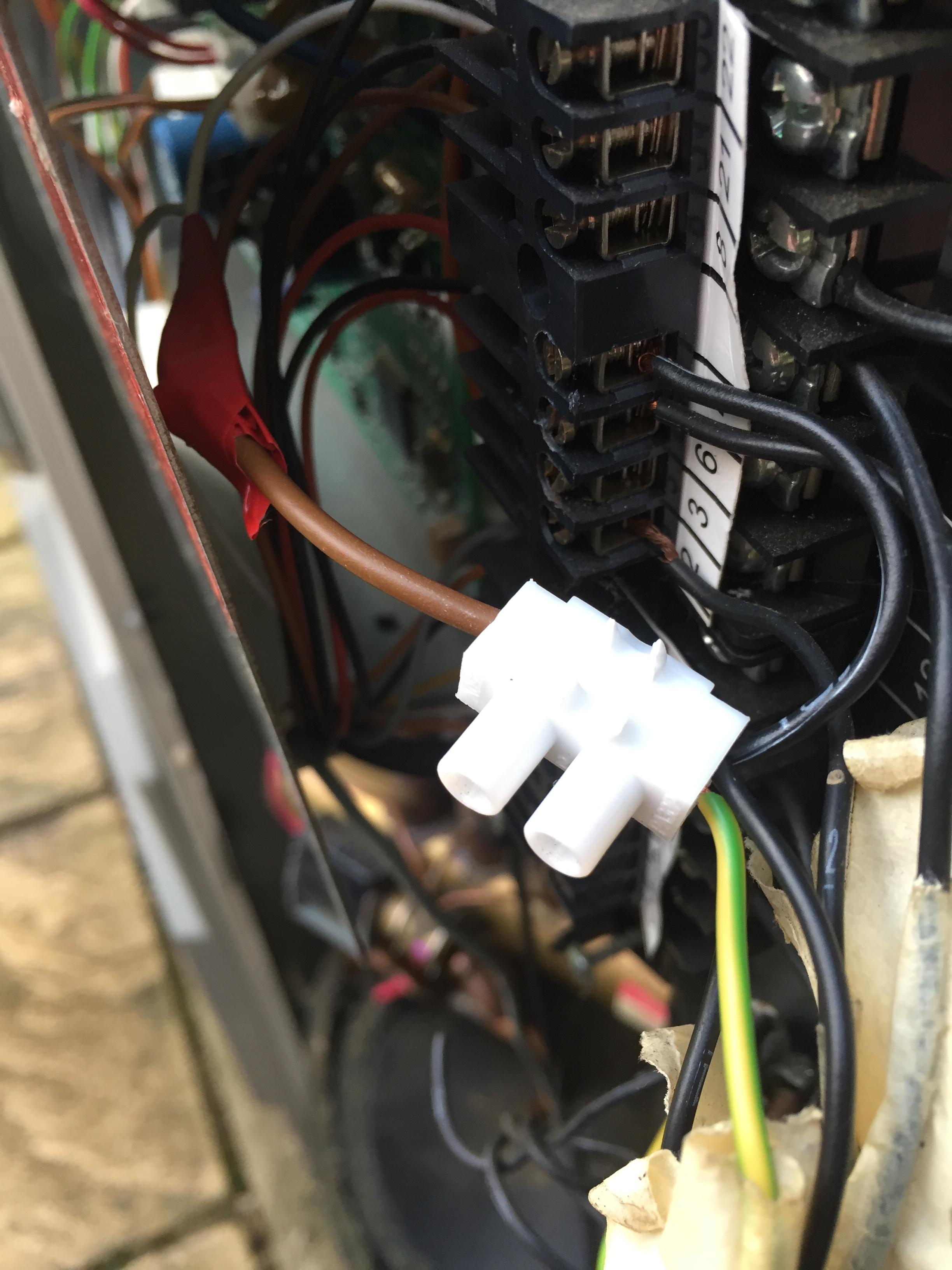

Lynford Posted February 17, 2018 Author Share Posted February 17, 2018 Afternoon all, So today feels a little one step forward, two steps back. I went to fit bootlaces to the wires but took the wrong size (not sure I could get more than one of any size in a terminal anyway) Checking the connections, I found that #3 wasn’t done up properly. I went to tighten it and found out why - It’s broken (see pic 1, you can see the screw isn’t done up properly, because it can’t be). As per Jeremy’s tips, if 3&7 are linked out the unit tries to cool. So I’m thinking, “this is it, job done” With no no other means of fixing it, I’ve put a chocolate block in between the three wires in terminal 3, and the other side of the terminal (see pic 2). I’m hoping that there isn’t another internal link from the terminal block that I can’t see. So all connected up, the ASHP starts running and after a short while I feel heat on the flow side. Nothing getting to the rads, so bearing in mind Peter’s thoughts about the diverter valve, I flicked over the manual lever.........and I get heat at the rads. WOO HOO. Obviously not in the clear here, still need it to check I can produce HW and there’s the confusion / issue with the diverter valve but feeling pretty smug. UNTIL The Rads didn’t seem to be heating anymore, so I go outside and the ASHP isn’t running. Inside the unit on the PCB where Jeremy got me to check last week, I had 3 lights on. The one I had last week in green but two above it in amber (D802 & D804, picture 3) Also a flashing red LED on a lower board, that I don’t remember from last week. Nothing on the Kingspan diagnostic box. I checked that 3&6 were still closed, so telling the pump to run. A lot of (garbled) info there chaps........any ideas where I go from here please ? Cheers, Lyndon Link to comment Share on other sites More sharing options...
Jeremy Harris Posted February 17, 2018 Share Posted February 17, 2018 I'm struggling through this, as the LEDs don't seem to match those for the KHP 0040 12kW version. From the manual, if there are LEDs marked above D803, then it looks as if the control board is a KHP0042. According to the Kingspan info, then when LEDs D802 and D804 are illuminated, that indicates "high pressure protective operation" (D805 is the "on" LED). This relates to the flow pressure, I think, as mine does this (but displays the info more meaningfully on the Command Unit) when the flow is restricted. The only way that can happen is if something like a valve has closed which has restricted flow enough to trip the over-pressure sensor. It should try to start again after a few minutes, but if the flow restriction is still there it will shut down again. The flashing red LED is the internal diagnostic code LED, and will flash at 1/2 Hz when everything is OK, but will give a flash sequence that can be counted if something has gone wrong in the heat pump. If it's just flashing regularly then there is no fault. Terminal 3 is the 12 V ground terminal, and is replicated on other terminals on the block. According the the info I have, terminal 3 is also connected internally to terminal 13, both are 12 V ground terminals, so if terminal 3 is broken you could use terminal 13 as a substitute. So, it looks like what has happened is that the unit has fired up, the rads have heated up, but something has shut down the rads and caused the flow pressure to rise and trip the heat pump off. The next bit of sleuthing is to find out what has caused the rads to turn off. Do they have thermostatic valves? If so, then one possibility is that they have closed down as the rooms temperature has increased. If they don't, then we need to have a look to see what else could be causing the flow to shut down. Link to comment Share on other sites More sharing options...

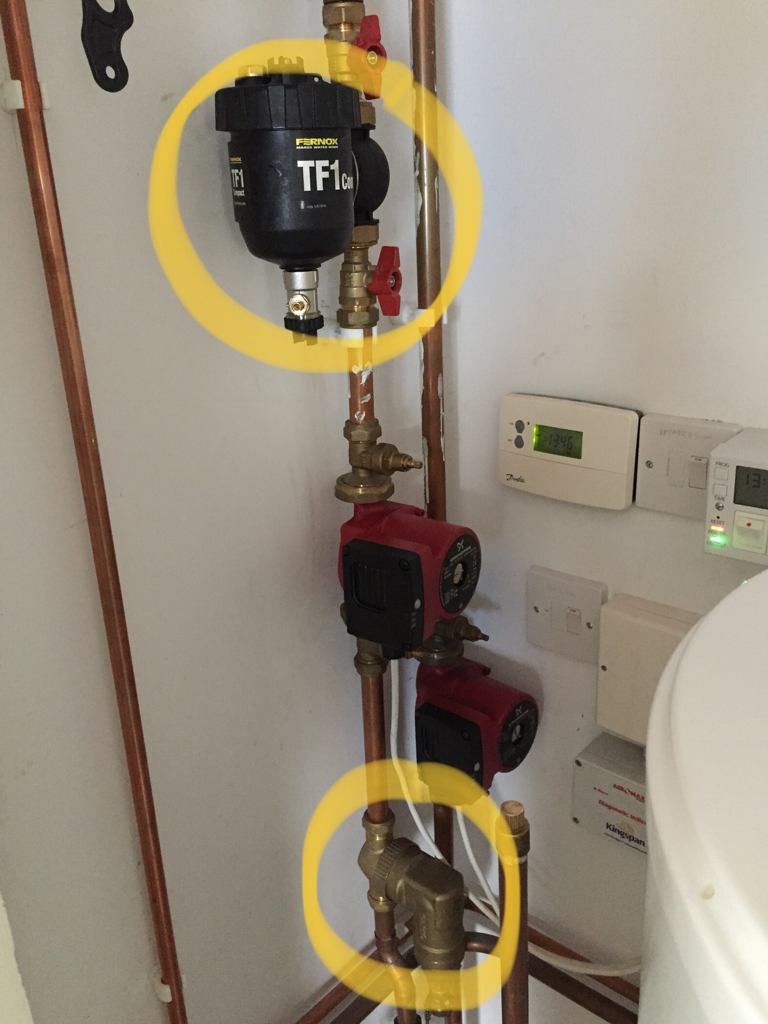

Lynford Posted February 17, 2018 Author Share Posted February 17, 2018 (edited) Hello gents, So I could have used #13 instead of bodging up modifying #3……I may revisit that next time I go up, ta. Yes there are TRVs on all of the rads - Should I be looking at opening these all up fully and trying it again ? There are also what look like filters in both the flow & return of the system, Maybe these could a restriction in flow and rise in pressure ? As ever, thank you. Edited February 17, 2018 by Lynford Link to comment Share on other sites More sharing options...
Lynford Posted February 17, 2018 Author Share Posted February 17, 2018 Filters ? Link to comment Share on other sites More sharing options...
PeterW Posted February 17, 2018 Share Posted February 17, 2018 Magnaclean and a Spirovent ..!! Thats impressive..! One or the other, don’t need both but they won’t restrict unless they are full of crud. Open all the TRvs to 5 and let it rip ... Link to comment Share on other sites More sharing options...
Jeremy Harris Posted February 17, 2018 Share Posted February 17, 2018 Just as @PeterW, says, just open all the TRVs, I'm pretty sure that's what caused the shutdown, as there doesn't seem to be a pressure bypass. Yes, you can use 13 instead of 3, as they are both connected electrically on the board to the 12 V ground. Once you have it working with the wire links and the TRVs open, then the next step is to determine why the thermostat doesn't fire it up. My recommendation would be to test it with the TRVs open and your wire links, if that works OK, then remove the wire links and reconnect it so the thermostat is controlling it, but leave the TRVs wide open. If that works, then you can adjust the TRVs, but make sure one of them is always fully open to act as a bypass, ideally one near the thermostat, perhaps. Link to comment Share on other sites More sharing options...
