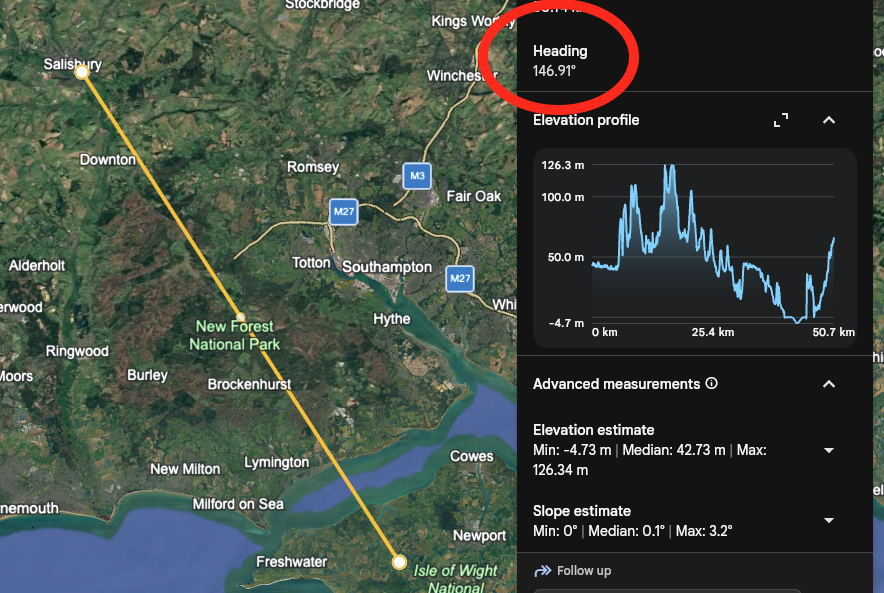

Russdl Posted 2 hours ago Posted 2 hours ago Oh, and as for orientation I searched the web for our nearest transmitter, used Google Earth to get the direction from house to transmitter and then used the compass on my smart phone to align it.
