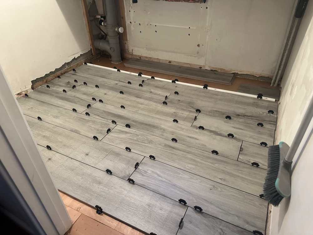

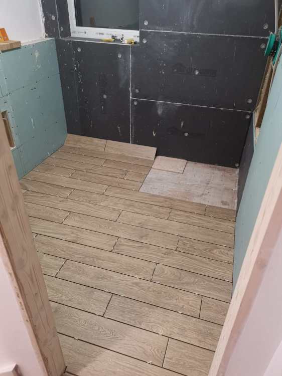

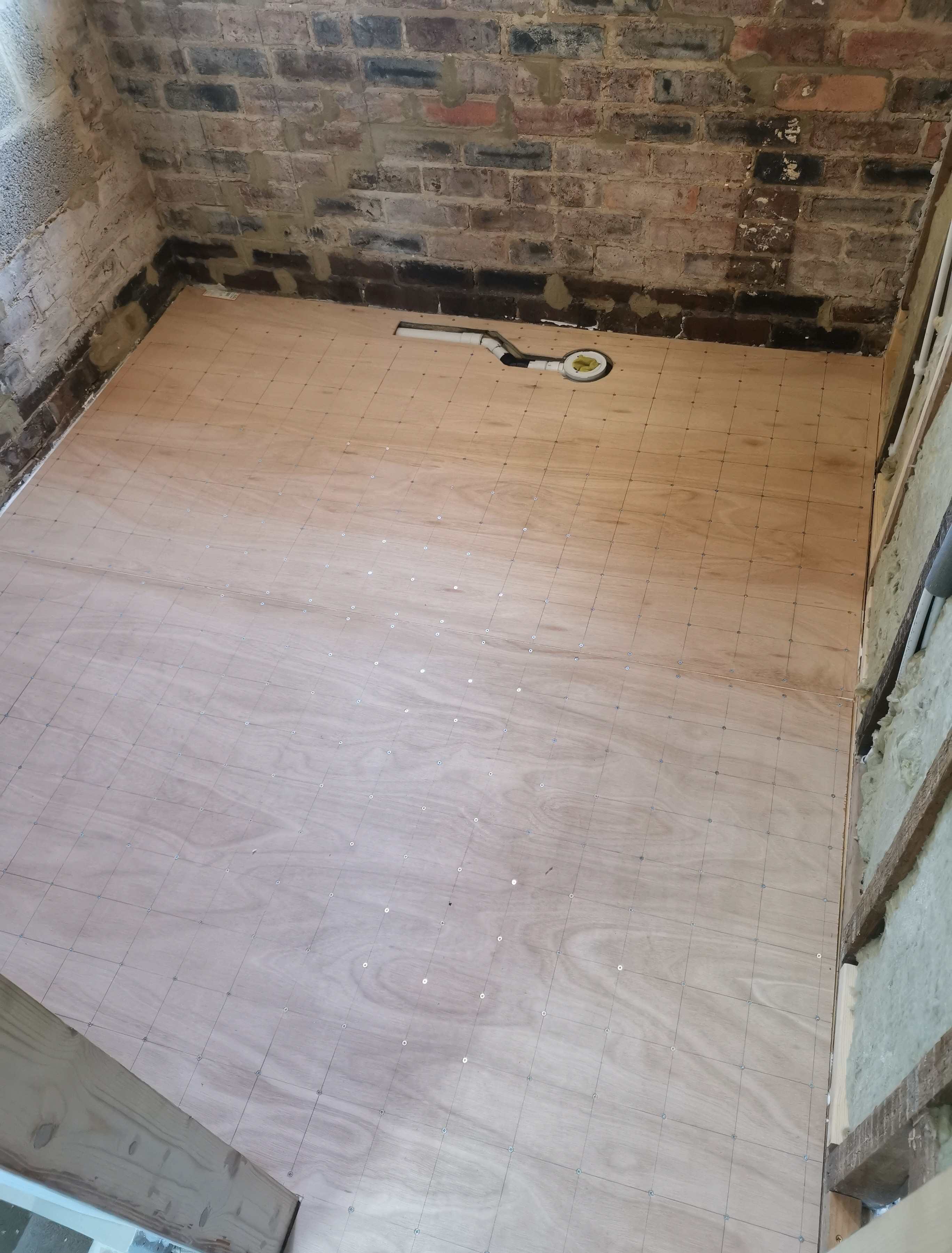

Super_Paulie Posted 6 minutes ago Posted 6 minutes ago I took the advice of big Nicky and put 6mm ply over the chipboard, notched PVA comb and then an unholy amount of screws.
marshian Posted just now Author Posted just now 5 minutes ago, Super_Paulie said: I took the advice of big Nicky and put 6mm ply over the chipboard, notched PVA comb and then an unholy amount of screws. I'm not counting the screws............................... (It's a lot!!!)
