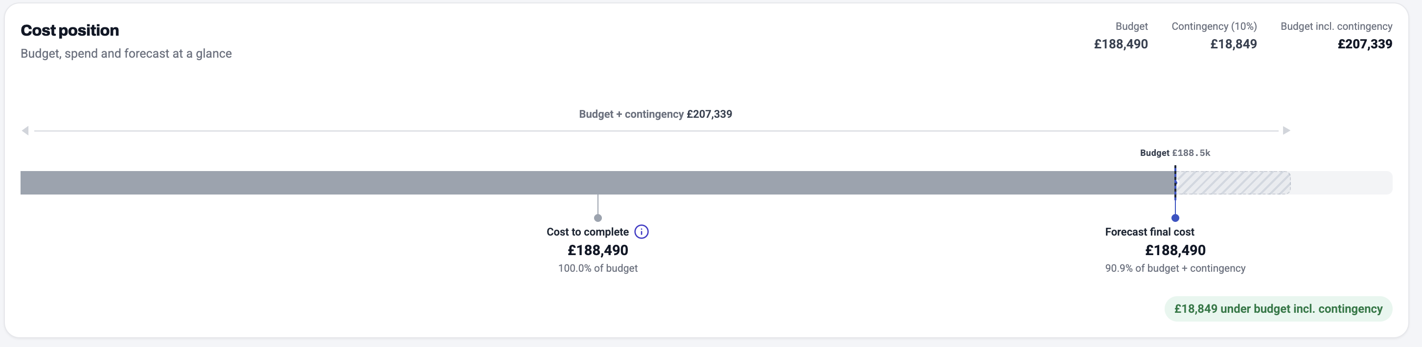

Hey all,
I'm currently planning the refurb of a 4-bedroom, 4-bathroom property with around 4,446 sq ft of internal space and have put together the attached budget. I'd be interested to get people's thoughts on whether I'm in roughly the right ballpark with this, or whether I've seriously underestimated anything.
I'm planning to do a lot of the work myself, so most of the figures are materials only. Anything marked as "subcontractor" is work I'm planning to outsource.
The total is currently coming out at £188,490 with no contingency included. I'm particularly interested in how other people approach budgeting for larger refurb projects.
Would appreciate any thoughts, especially from anyone who's recently done something similar.
Thanks!

"Think you need contingency regardless" - Fair point! Ive added 10% contingency but in reality, its my forever home (answers your other question :)) so I'll spend what needs to be spent, it will just mean delay until we save up the shortfall.
"How would you phase the work ?" - very good question, we are hoping to start upstairs and get that in a good state. Then we will tackle lower floors and bathrooms incrementally, keeping the mess contained. Definitely not figured that out yet but need to have a game plan. The app I use has a Gantt chart and tasks feature so I can plan what needs doing, assign materials to tasks and ensure I'll have enough to cover each task.
Electrics - Doh! Thanks, forgot to add that.

The amount you've got down for bathrooms doesn't really allow for much more than the most basic products (and it's tight even then). When it comes to choosing fixtures and fittings you may find that number going up quite a bit.
It is quite a piece of work to create a meaningful budget and to stick to it. Our original builder had a QS draw up a line item budget for our extension/refurb contract but with estimates for the plumbing and electrics. I insisted he got quotes for those items which came in a lot higher than his estimates. You need to either have a pretty good idea of what you want to do and the relevant prices, or be defining a budget and then constraining your choices to fit within it. These days there are lots of items where choice and affordability can change the price by multiples and huge amounts of that choice.
You should have a window and door schedule and cost that up, a steels and lintels schedule etc etc. You are bound to want some labour too I'd have thought - some things require multiple people, some particular skills, or placing risk with contractors.
As it's your forever home you will need to phase it appropriately. Are you going to be living there, or when would you need to start living there ? Living on a building site is not much fun, but makes it easy to be around as much as possible. Are you trying or willing to do it over 1 year or 5 years or even 10 years ? Do you have a partner ?
You're doing internal doors yourself but budgeting £75k (over a third of your budget!) to pay somebody for externals?
Are you planning significant structural work (relocating windows)? Just sayin', £75k is a lot of spondoolicks. Does it really need to be done?

Instead of trying to eyeball a budget for a massive project with a bucket of unknowns (you'll never get it right - trust me, I've been consulting on massive IT projects for a decade now - never seen an initial budget that didn't make me want to laugh out loud), I would very strongly advise you to do two things:
1) Tranche the works, at least into year 1 and year 2. Maybe into year 1 - summer; Year 1 - winter; Year 2 - summer; Year 2 - winter; Backlog. Good idea to MSCW all your requirements at this stage.
After each tranche you, ideally, want to be in a position where you can cancel/long-term pause your works if you get a black swan event (you or Mrs become unemployed, end up in hospital, Mrs gets a bad case of postnatal depression, kids go long term sick, you get into a car or bike crash, Trump decides to invade us just to name a few).
Do not plan to start work that you can't exit in an orderly manner.
2) Determine a Minimum Viable Product (MVP) for each tranche and each year. The absolute minimum you need to deliver to be able to say that your work during that tranche has been competed and actually improved the house and added value to it (value to you personally or mkt value). In this case if shit hits the fan, you can de-scope the works to the absolute minimum you need to deliver in the given tranche.

Generally, projects have 3 control levers: budget, timelines and scope. People very often focus on the budget and forget about the other 2.
For best planning, you need to use all 3 and build in contingencies for all 3.
And if you prioritise your requirements well, scope is the easiest one to adjust.
Since you're living in the house, have an orderly exit plan from every piece of work that you begin. And follow the 7P principle in everything you do.

Thats fair. I did try to create a quick shopping basket and was also hoping to use my trade account discounts (as I did a refurb of a property previously so have trade accounts). Im also planning on shopping smart and I would imagine bulk buying everything from one place may incentivise the shop to give me a decent discount.

Yes external glazing and doors is going to take up a big chunk of our budget but is also one that adds the biggest impact to a property (in my opinion). The building is L-shaped so theres quite a few sliding doors and full height windows. But I'll be living there and phasing the work out. I'm hoping to do it slowly and actually enjoy the process of improving our forever home :)

What you're trying to do now is not planning - it's often called a ROM a (Rough Order of Magnitude cost estimate). Stick a finger in the air and use your previous experience to eyeball the extent of damage to your bank account after all is completed. There's benefit in doing this but don't mix it up with planning software, gantts, etc and I wouldn't overthink it.
My advice is to go over the scope with a fine comb.
Your current thinking is: I've got 4 bathrooms, bathroom cost me £900 last time and took 1 week -> I'll budget 4x900 with contingency -> call it £4k and a month of work. This is good thinking for a ROM.
Now think scope and start planning:
- I will not need bathroom #4 at any point in the next 5 years -> I can de-prioritise it and don't have to think about it again. Better to use my time & money on higher priority tasks.
- Bathroom #3 seems to have a small leak -> I need to investigate asap, as this could lead to a lot more than £1k + 1 week if there's rot underneath the floorboards. -> Re-assess after further investigation.
- Bathroom #2 is a straightforward like-for-like replacement, so fair to assume £1k+week -> Put it on your quick & easy wins list.
- Bathroom #1 is large and, with a bit of work, can be re-modelled to fit a bath big enough for both you & mrs to comfortably climb into it at the same time🤩, but this requires more work than a straightforward like-for-like. Likely £2k and 2-3 weeks of work -> keep it as low priority for now, because it's a nice to have but you might run out of time & money to do it in the next 2 years. Maybe better to tackle it in year 3 but do it the way you ultimately want it.
You get the idea, hopefully.
