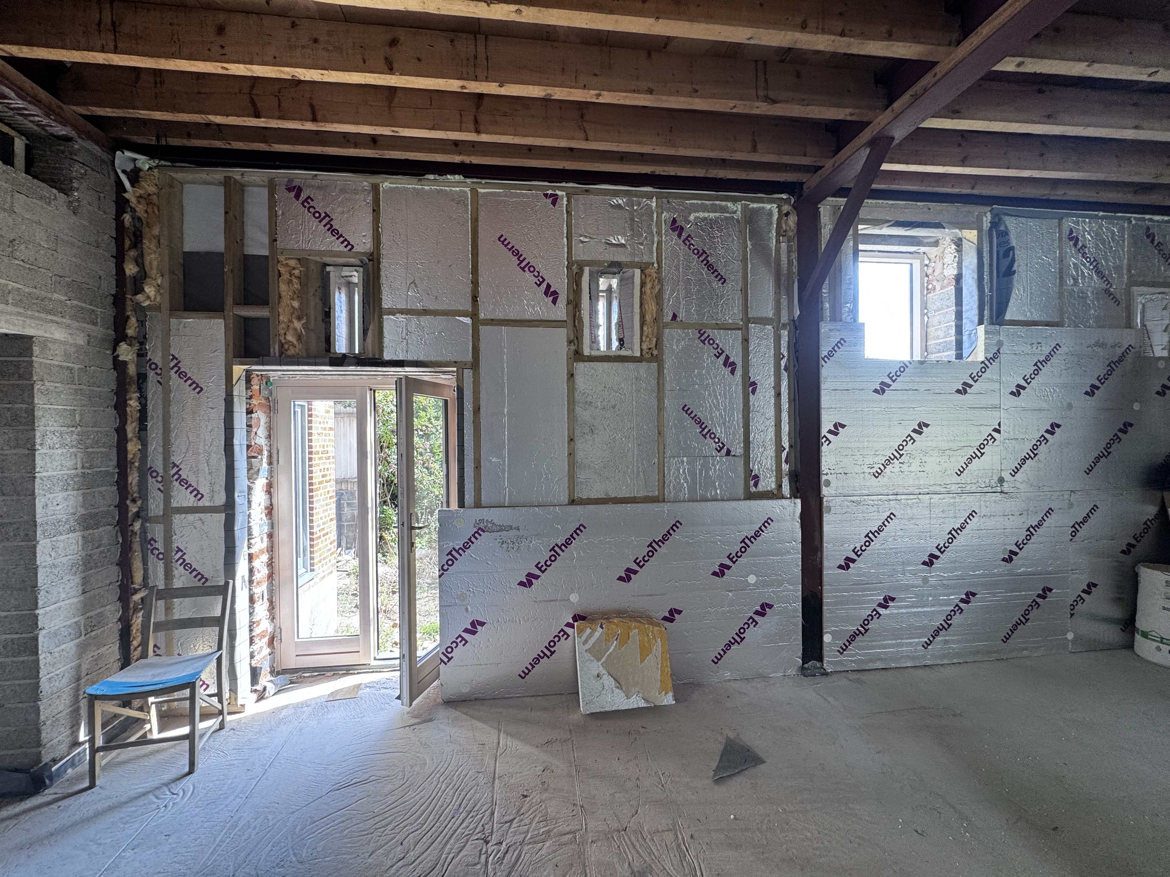

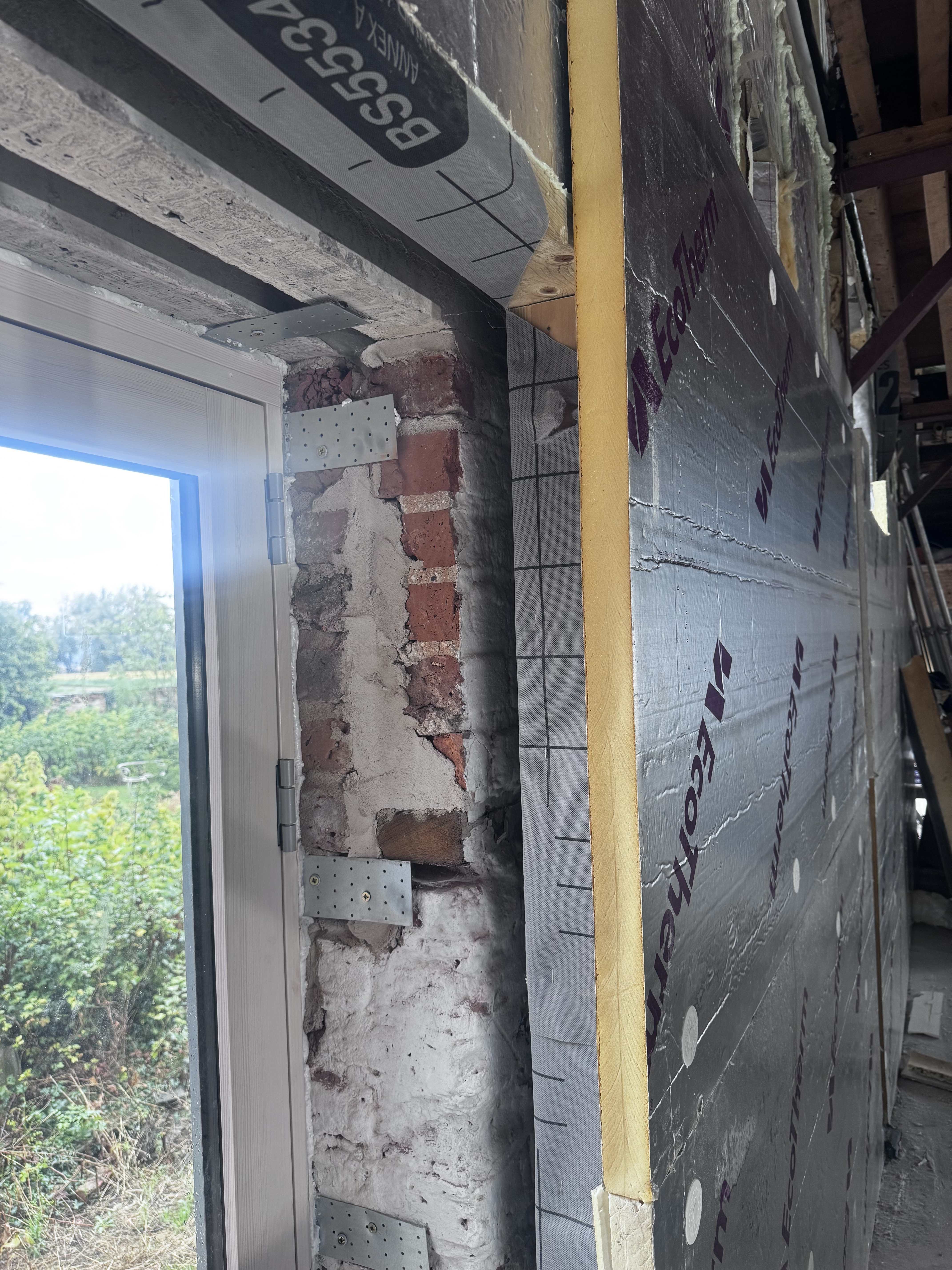

I have a number of concepts which I’m sure will work but looking for fresh takes on how to take airtight AVCL line from door frame to Iinternal insulation (inner face) - gap circa 415 to traverse but only 20mm or so to work with….
Current lines of thought are to AVCL to frame behind build-up and use jacko/marmox board to form reveal with stop end bead to frame to restrain the board.
Seems like a lot of work though. So if anyone has a cleaner solution from experience it’s welcome.
Maybe the more slight frames were a bad choice. doesn’t leave much to work with.
Problem occurs 13x to varying degrees albeit this is one of the tighter ones

That's very tight to get insulation in there but anything would be a great improvement to prevent condensation etc.
How many mm do you have to play with, it looks to be only about 15mm?
I would get Marmox board and shim it level and screw it to the brick reveal, holding it back 5mm from the window frame. Squirt behind it with FM330 or other low expansion, airtight expanding foam. Then use a white acoustic/airtight sealant to seal the 5mm gap between the marmox and the window frame.
The room side of the Marmox can be taped to the PIR.

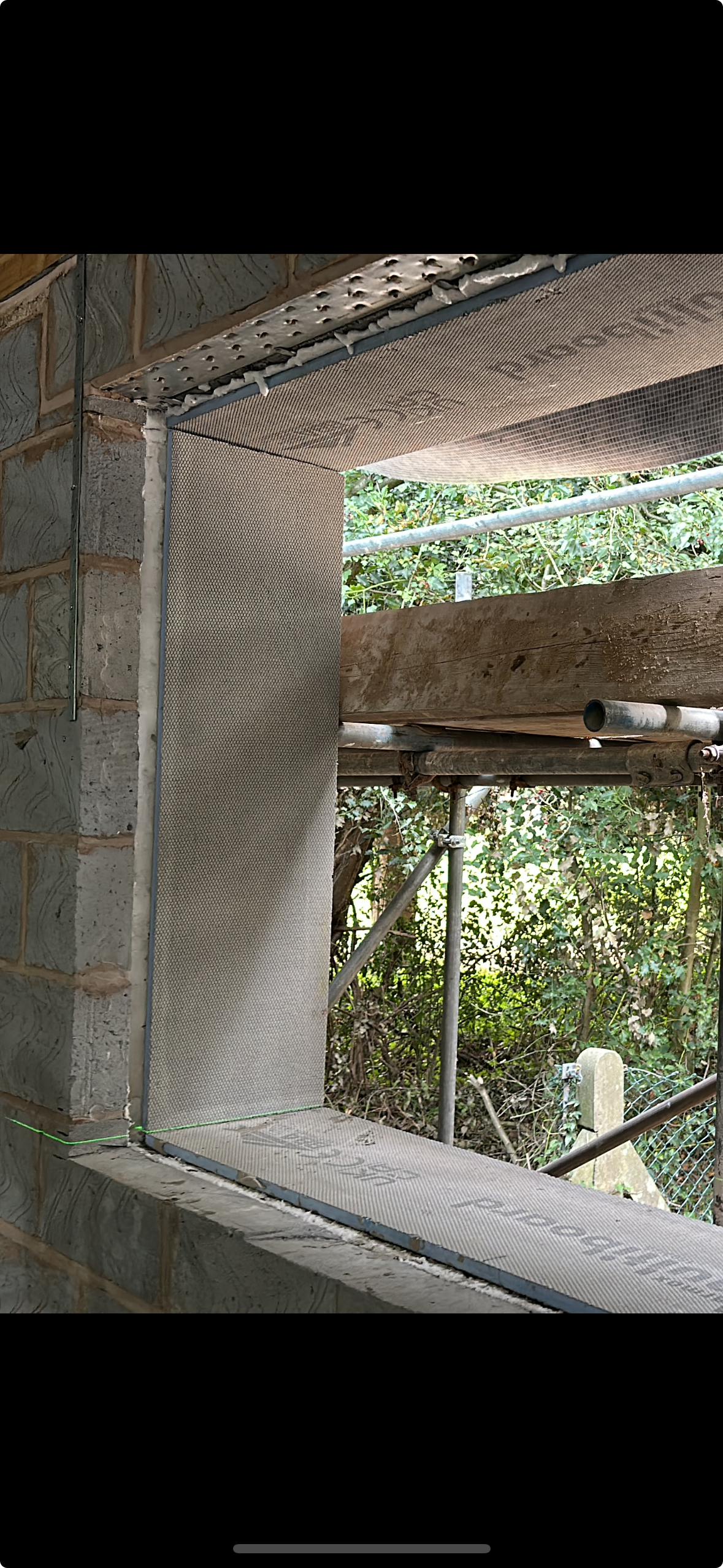

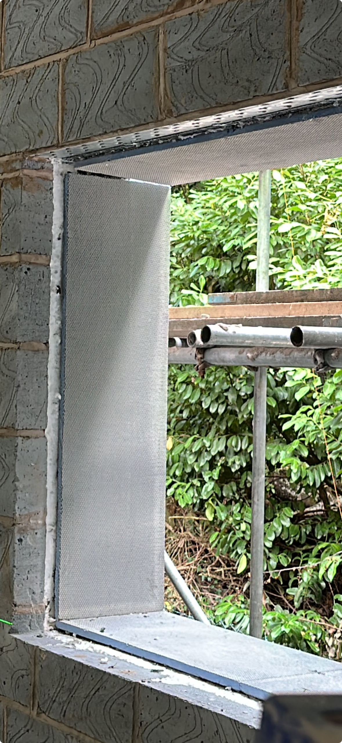

This is one masonry project, an EnerPHit type of standard. 20mm boards used, and still retained the 10mm that Norrsken asked for.
Done with tile adhesive, and stuck on there like shit to a blanket.
I flew these through prior to the windows going in, so they created frames for the EWI to be dressed into. These projected out around 160mm, for 150mm EWI + render etc, as you can see in the next pic with windows in.
You can use tile adhesive with complete confidence, it’s remarkably good for this application, and way better at staving off damp bridging.

Indeed. Client had ordered the windows way too soon, so in those pics you can’t quite tell that I had to take a 12” disc cutter to all the outside walls, to enlarge the openings by 25mm to accept those boards.
Was a total clusterfeck when I arrived, hence such drastic measures were necessary.
