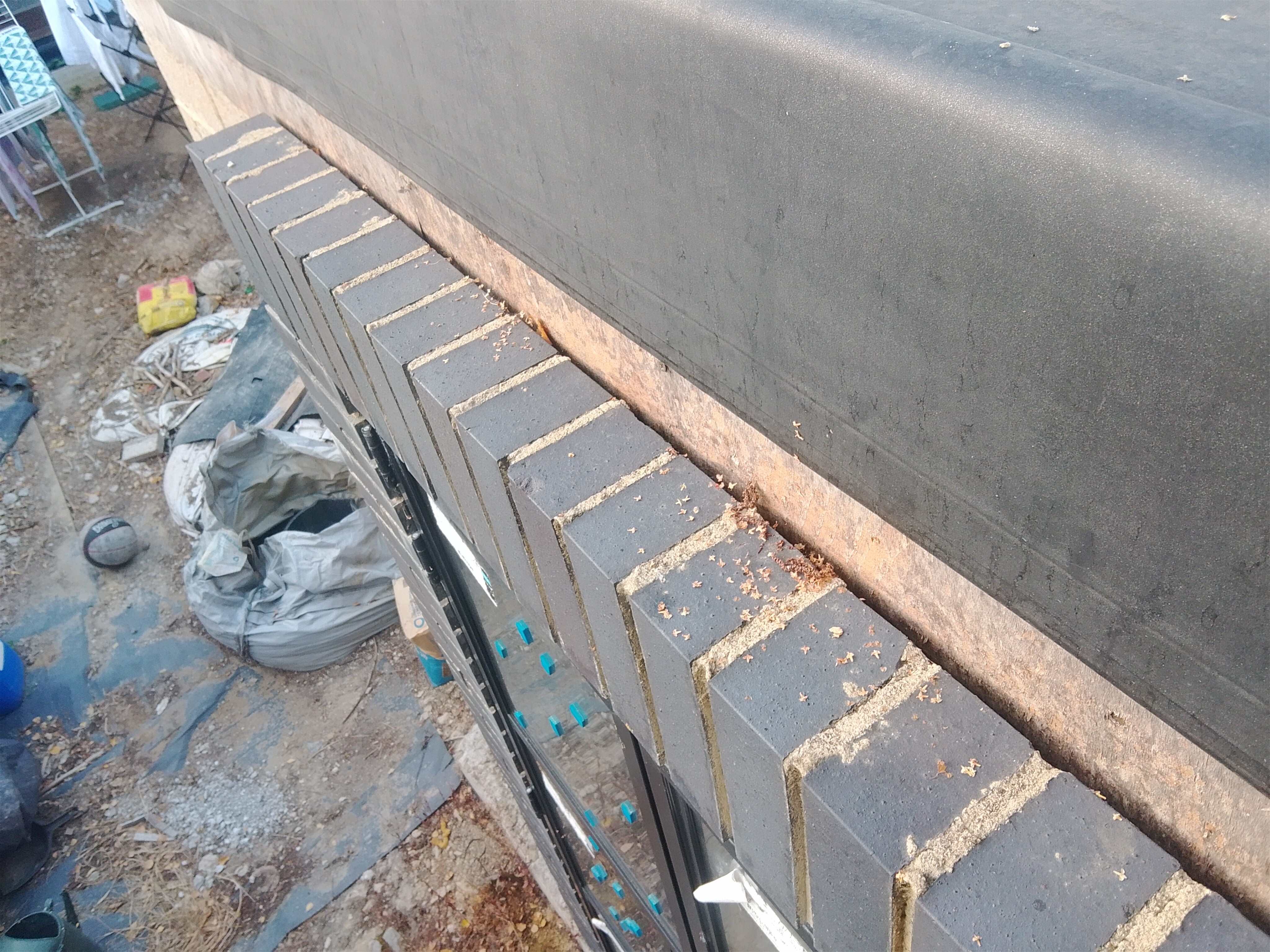

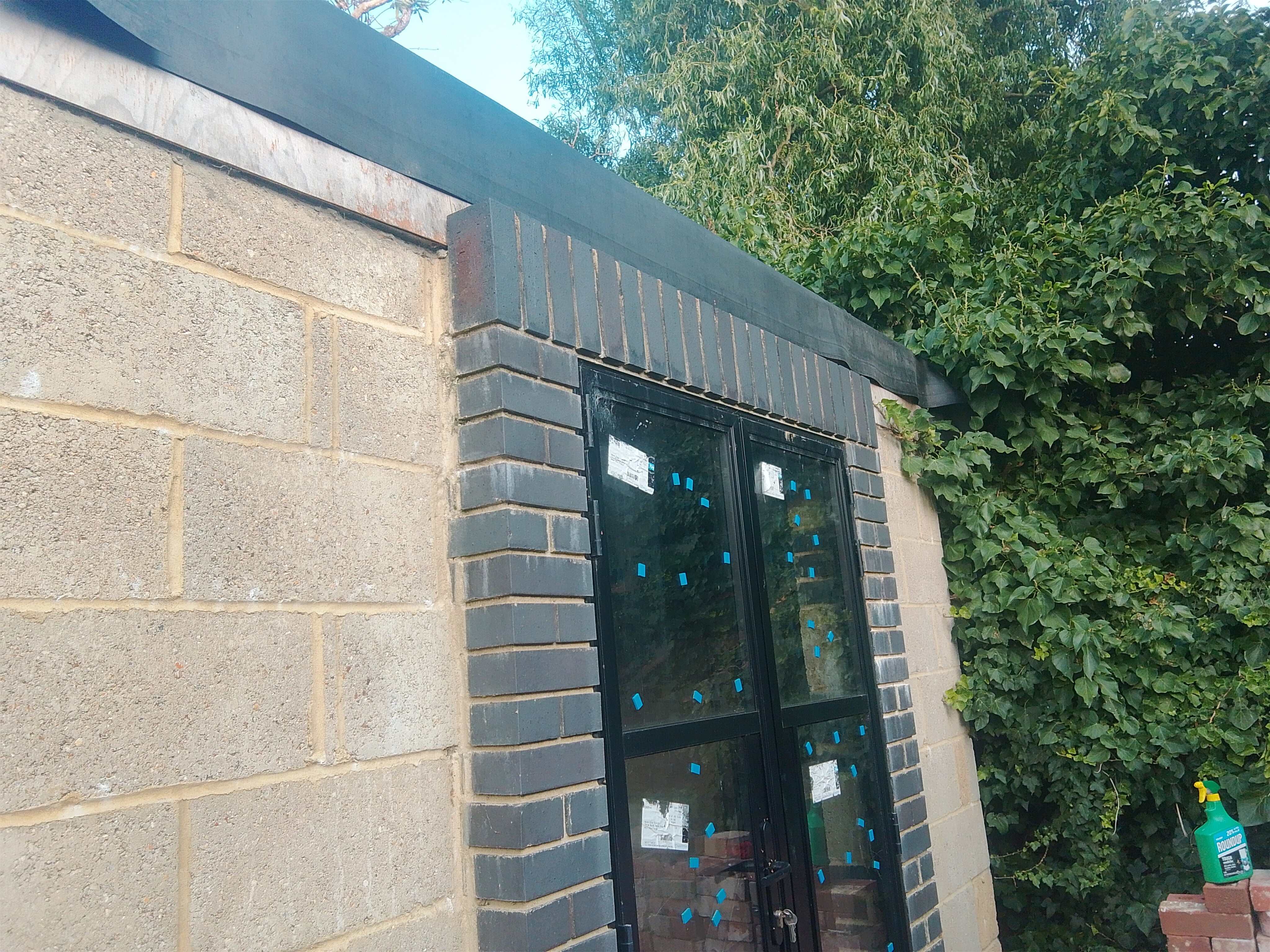

In the garden of my SB I have built a home office. It's single skin block, which I will wrap in breathable membrane before cladding.
I have built a feature brickwork projection around the doors. There is a gap at the top between the brick and the block, as you can see.
To protect this I planned to get a bit of arris rail, wrap it in either lead flashing or roofing rubber, and fix it over the top of the bricks. I would then dress the membrane down over that.
Thing is, that wouldn't give me a drip bead. I'm not sure if that matters. I might be overthinking it!
I have thought about using a pvc windowsill over the top, but I'm not sure how I'd address the junction between the sill and the block wall. In any event, I'd want a grey or black one and for the size I need I'd be paying more than seems sensible.
How would you treat this area?!
Thanks
I'd think in terms of building the world's smallest flat roof and I'd build it on the ground then drop it into place, bonded to the bricks with a decent adhesive.
Get a piece of OSB that will overhang 50-75 on three sides, put something like your arris rail around the underside edges to create a drip, then dress the whole thing with your roofing membrane, making sure to leave an extra strip that you can lap up the wall once it's in place, normally you'd have a cover flashing over but your main roof membrane may over lap to do that job
(You could probably do the same from a single piece of lead, working it around the outside edges if you're careful)
Or aluminium flashing either could try and bend it yourself or get a fabricator to do it (this opens up option to have welded edges and custom powder coat, for a price that is likely higher than the other options but not as high as you think).
Depends on the look you are after.

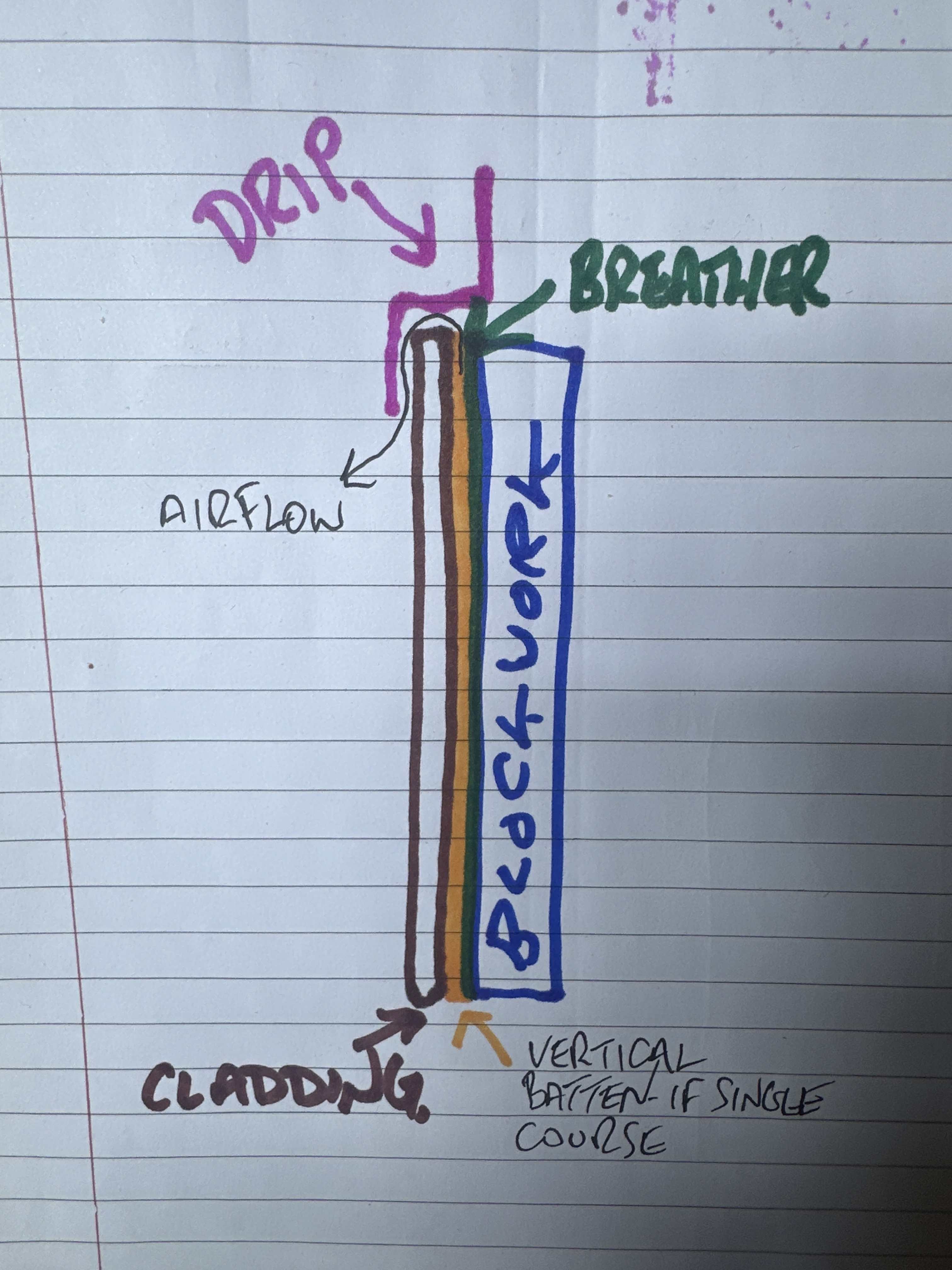

Sorry, I meant will your roofing membrane become an umbrella for the cladding; I’m not seeing here how the rain won’t get down the gap at the top of the ventilation void.
You have 2 shelves to deal with here, one of the cladding, and another of the brick detail?

Not at all.
The cladding is classed as a rain-screen, and you should have a drip detail that closes off the ventilation gap, by being slightly higher and protruding beyond it; rain strikes this and runs off down in front of the cladding. It’ll also need an up-stand to disappear up behind the roofing membrane.
Back to the drawing board I’m afraid.
8 minutes ago, Nickfromwales said:
@Tony K
I was just about to do a similar drawing, but I don't have the same access to colouring in pens!
You'll need to add all these layers together so you don't go and feck yourself up by detailing something for the brickwork that doesn't marry up to the cladded sections.

Could we see your version of the above sketch?
