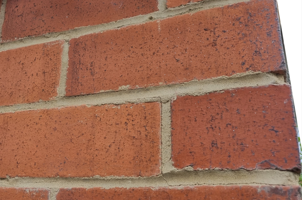

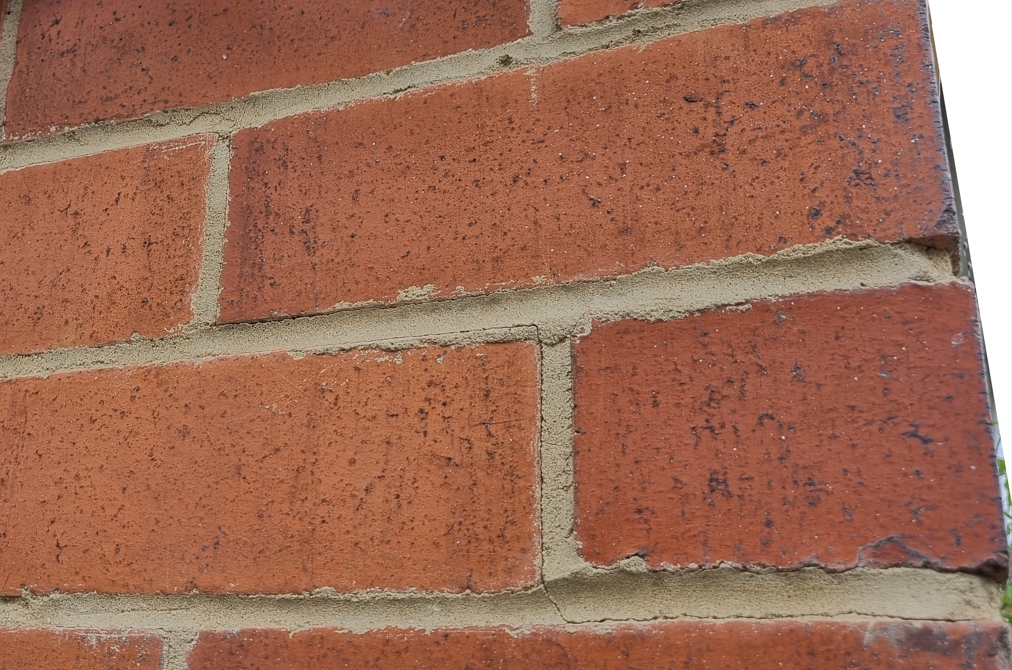

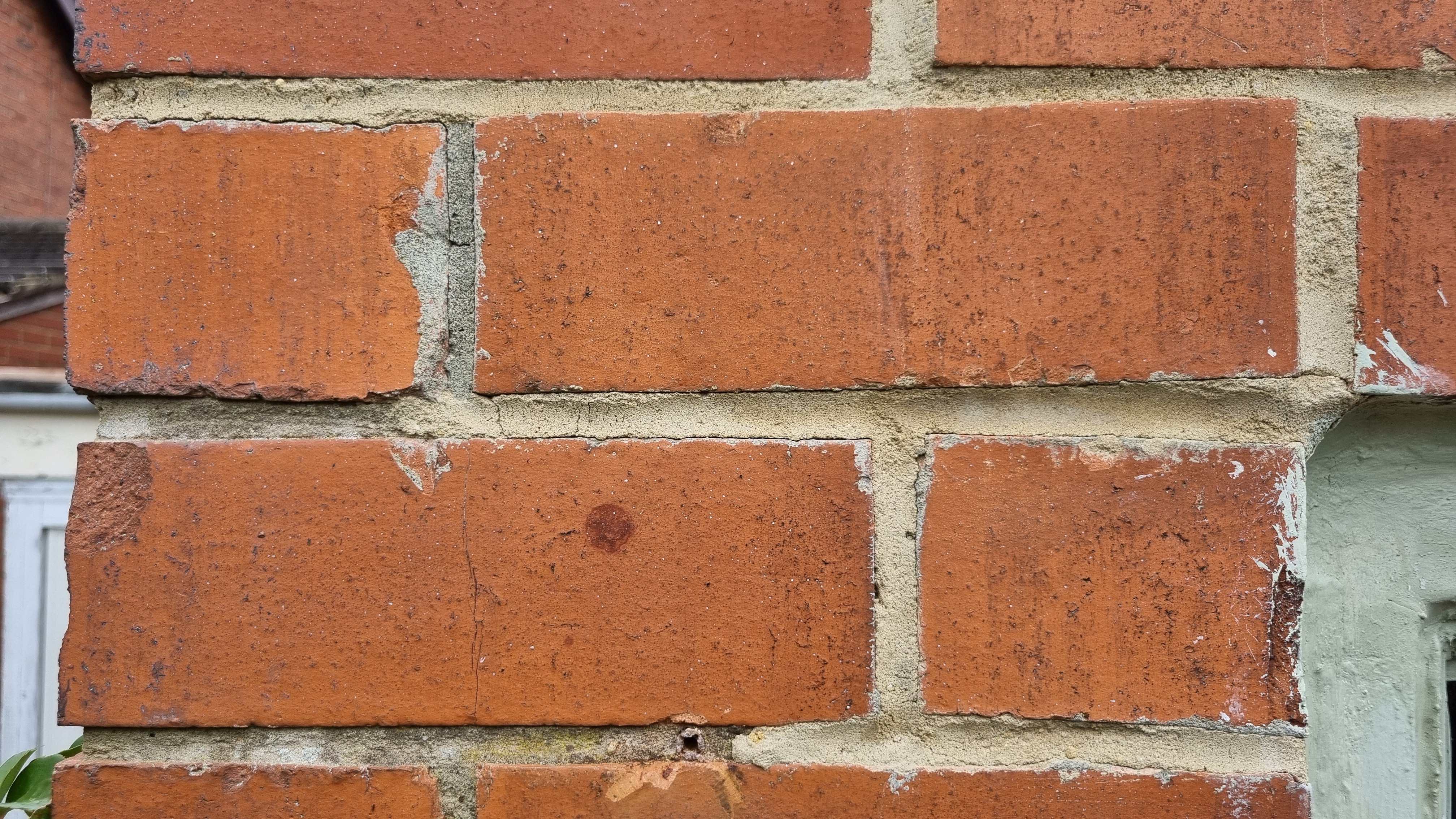

1) The cracks:
A) I've filled them in, when maintaining original sadh windows, didn't think much of it, but its happened more than once. the house had it wall ties done (cavity wall) in 1985, so could it be these need doing again? the pointing probably needs doing at the same time. there is a there is a long horizontal crack on the wall behind this photo, it hasn't broke the wall paper, but there is a small ridge, dont remember i think this may have been there for decades.
B) was filled but came back, but is hairline.
C) this has been covered over with plaster but has come back (its probably been there for years unnoticed)
D) this hasn't been filled in and doesn't seem to get bigger.
E) I'm not sure how long this staggered crack has been there, its to the right of an upstairs chimney breast. I exposed it behind flaking wall paper looking for damp patches. The wallpaper was bulging so I removed it and the mortar was loose.
D) this above the sash window outside an upstairs bedroom at the other side of the house.
note) b, c and d are same window
E) this is on a single story extension roof by the main door
E) (sorry its F) this is by the main chimney breast in an upstairs bedroom

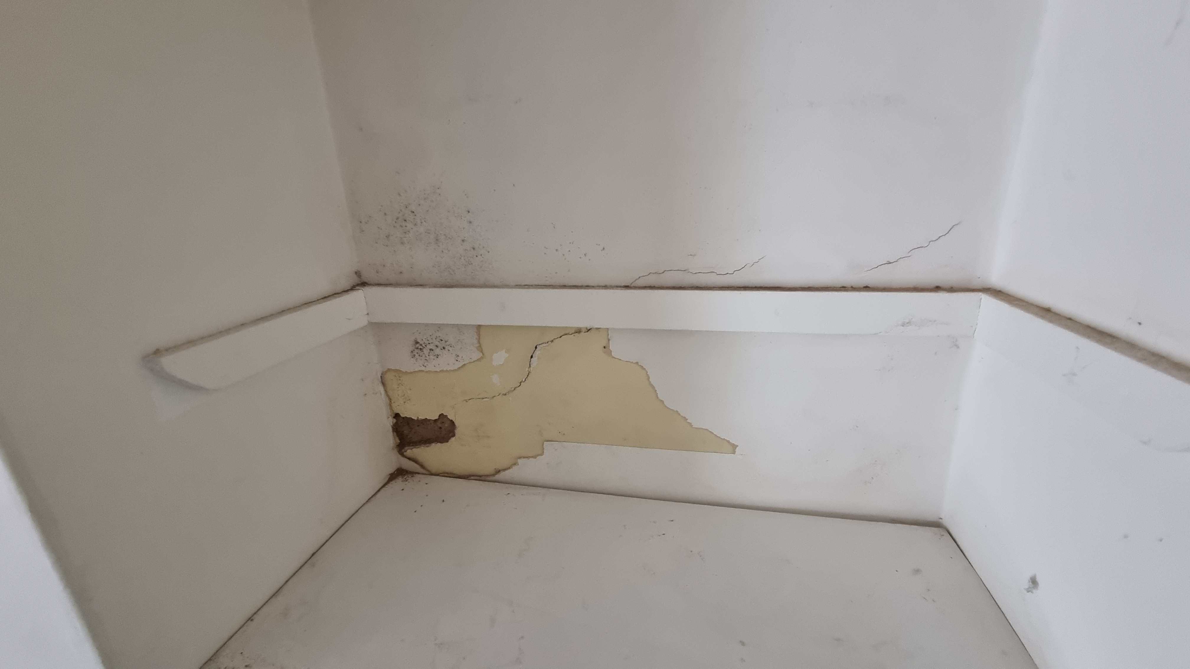

"Is the damp on the inside of an external wall?" = yes, the crack E2, next to the chimney is discoloured with damp.
 image.png.61a3ff5baef11eb699c591579eb2d569.png    this is the main chimney image.thumb.png.f17e3c268a5a1391c0f2b1bb43e7bafd.png
Edited by Reggie1
The wall on the left in picture e2 is the chimney breast, the wall on the right is a hollow wall. The mortar is dug out is almost attached to the chimney.  There use to be an upstairs smell of smoke before we had the main chimney lined, im wondering if this could be due to that?

From the photos I cannot see any cracking or damp that would raise any concerns.

That is a common effect. In your case i'm thinking that the wall to the left has moved by these few mm.
If that has been there for years then it prob just needs repointing. If new then it could be this recent drought causing sinking.
could we see that wall from further back?

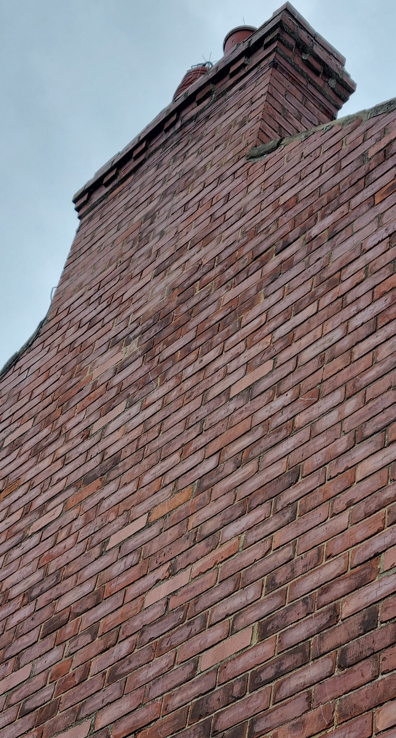

Damp at chimneys is very common. Rain can come down the chimney if there is no cap. Or can creep through from the brick of the chimney itself. Is it just staining or can you se dampness?
The wall on the left in with the jagardy crack is the internal chimney breast that joins the main chimney in the loft. They arch up join then go vertical in the loft . The wall on the right is hollow not structural.
