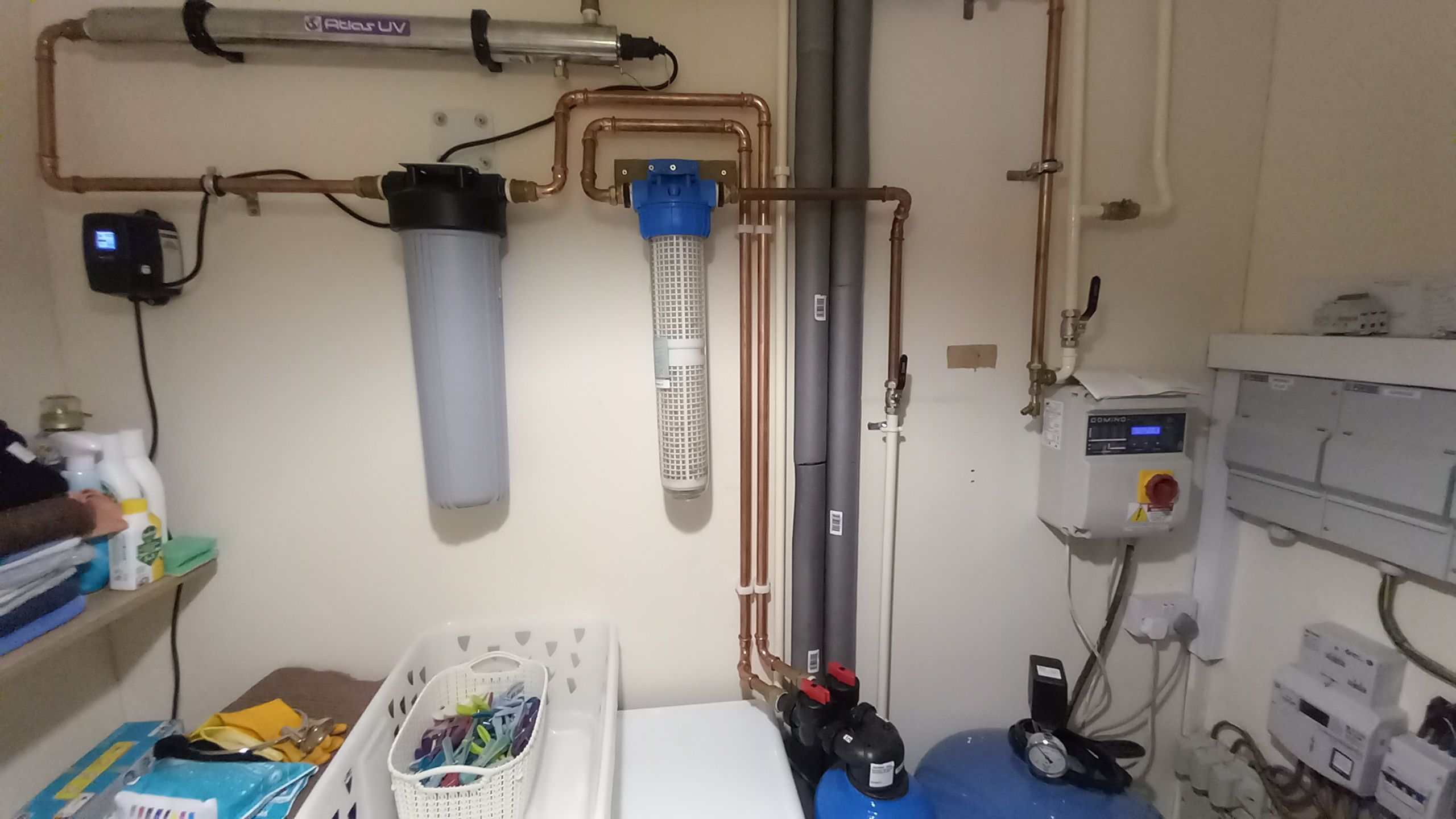

my problem is a strange one
my cold water is not cold
I,m on a bore hole and water comes  to plant room into an accumulator where pressure is kept at 3.75 bar
it then goes through filters + uv etc
the water pipe then goes up into the space between the  upper floor and the ceiling
the result is my cold water is never cold
I checked the ASHP pipes with a heat gun and can see a heat bloom from the ceiling
 but even now when the low heat is  not much  to heat the hot water it is still a problem
my question what insulation by  law  if any should have been done to the pipes in that area
are there laws about insulating pipes inside the house
Posted
Different bits need different strategies depending on what it is. DHW piping should be insulated, it adds unwanted heat in the summer to house. You may also suffer heat loss at cylinder, think the 2m around cylinder are supposed to insulated anyway.
CH piping if you are running WC most parts of the house are going to be a similar temp including voids so any heat gains are fine. If you are running cooling you may need to insulate anyway.
Cold water wants to stay cold so you may need to insulate depends on routing. I have the bore hole kit outside in an insulated shed, so stays pretty cool. Pipes in-house are mostly in concrete below my floor insulation, only bit not is encased in roof insulation on its way to hot water cylinder.
If your cold pipes are in the void between floors your cold water is likely to be 20 to 21 degs most the time. Insulate to death.
