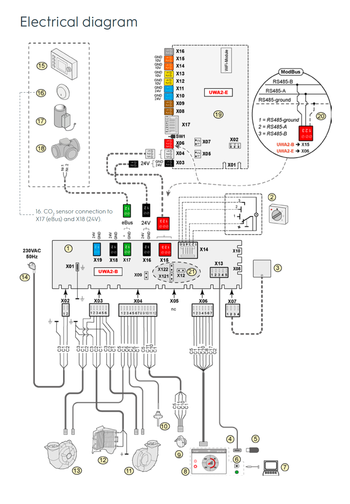

Alan Ambrose Posted 5 hours ago Author Posted 5 hours ago For anyone following along at home: The difference between the Brink Flair 400 and the Brink Flair 400 Plus is the inclusion of an upgraded Plus PCB board (i.e. it includes the UWA2-E board). This enables "the Brink Home online and app control via (W)LAN internet connectivity and also extra analog inputs, digital inputs, and terminal connections for advanced accessories like post-heaters or complex multi-zone sensor setups." The base model includes "standard connectivity like eBus, Modbus for building management, RJ12, and USB port for an RF dongle. Also, basic local control via integrated display or 4-way switch." Price difference is about £300 - in the UK I think by buying the 'E' board separately.
