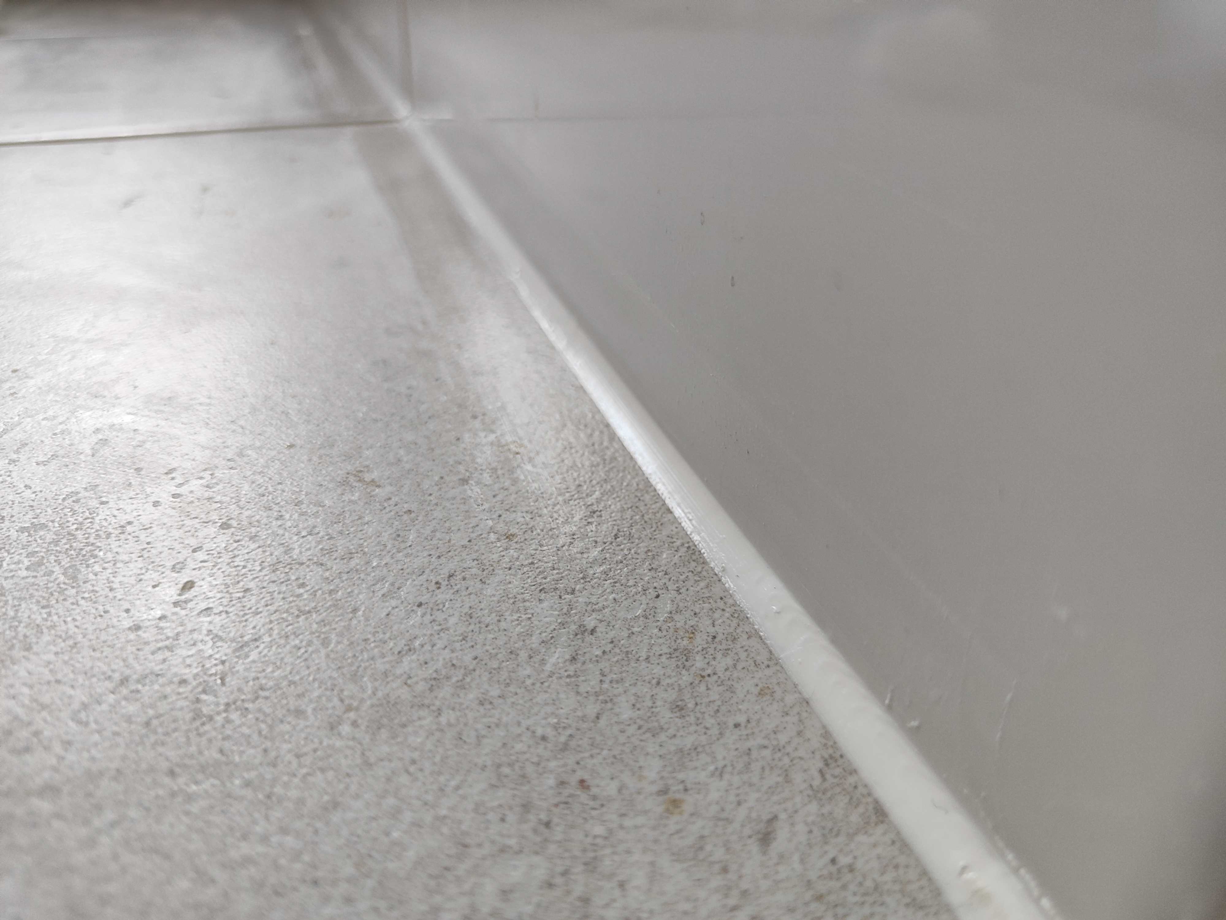

Charlie DIYte has a good video all about applying Silicone [link] and makes some good points. A Cramer Fugi kit is being used.
The issue we are getting is a shiny film being left on the tiles after tooling. Hopefully the photo below shows this OK. That raises to questions:
  1. How do we stop that from happening
  2. How do we remove it when it does happen
I'm having some high stakes conversations with the person on this job (SWMBO), so a tactful solution would go a long way.

I am pretty poor at this, and whenever I have to reseal the bath I always have to use masking tape down both sides of the joint. If doing it that way the 2 things I have to watch are 1/ make sure the sealant is as thin as possible at the point it squidges out onto the masking tape to minimise the small edge step you get when the masking tape is removed and 2/ Remove the masking tape before the sealant goes hard with a steady continuous pull with the tape angled away from the join.
To get it off I would guess that it may be best to use something to cut the silicon film along each edge of the joint so that when the film is removed it doesn't pull on the main seal line.
I would suggest maybe using a test piece to replicate the issue and then experimenting to find a removal approach that works best.

You could minimise the staining by masking with tape but set the tape a tad wider than where the bead will finish. Do not plan to peel the tape off to give you as clean edge. That will lift the bead edge slightly and allow muck in to go mouldy. I used the Cramer kit. Cleaned the area first with Multisolve.

Your bead is too big before you hit it with the Cramer tool.
I bet you’re picking up a lot of wastage on the tool.
smaller bead
push firmer with the tool
lots of wet wipes.
I have a black bin bag, folded back on itself to make like a bin. That plus lots of bog roll. Have the bog roll ready and torn into two sheet pieces. When you see a lot building up on the Cramer tool, stop, remove from the tool with bog roll and drop straight into the bag.
