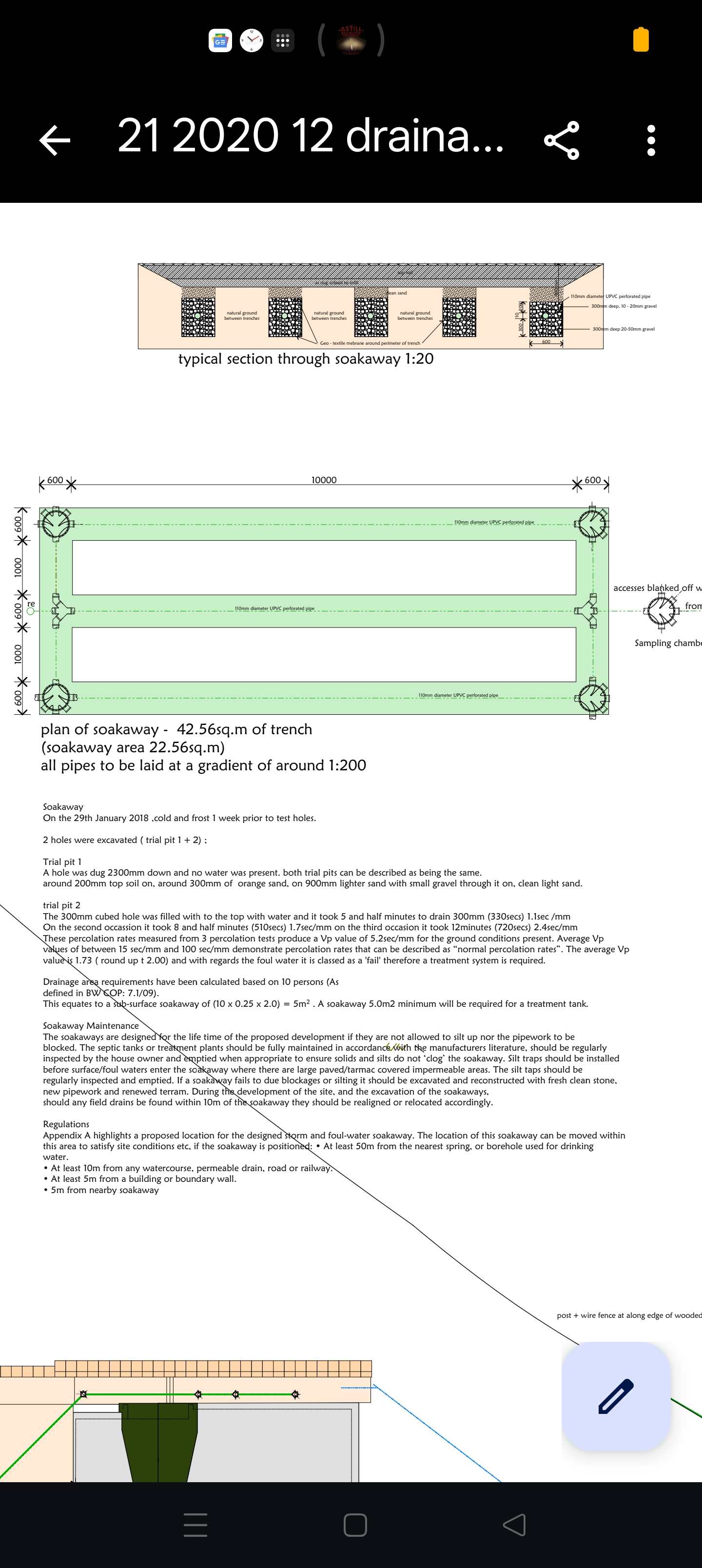

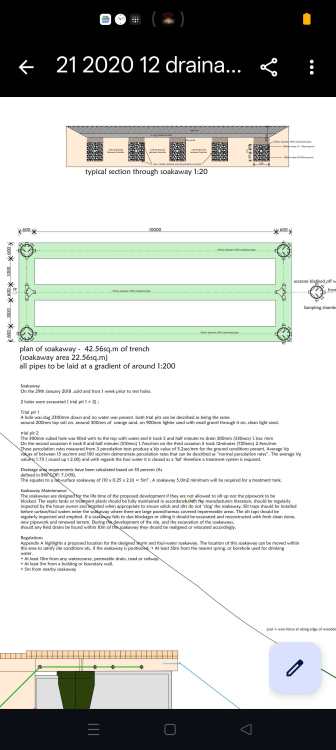

This is our design - effectively a fail on perc test as stated in the text. This is a early revision of the drawings shown as a 10 person drainage field (final was a 6 person)
Big area, but simple design. Don't overthink it just follow the rules
@JohnMothats helpful thanks, and will be especially so if I find we have overcalculated the area.
Your numbers are much smaller than ours, but that will he because your percolation is very fast.
8 times as fast percolation means one eighth as much area.
In my opinion, there is no chance that your drainage runs  more than 5m into the system before disappearing,   and the rest is redundant.
Not really correct - we have a fail and you go to the same place in the design rules if it's a fail for too fast or too slow. So the same design would be applicable to yourself also. Ours effectively sits on a thick layer of gravel, tops with more gravel. Suspect as you say disappearing pretty quickly.  But our layout (due to elevation changes) has a limit switch operated out flow tank (with pump) from the treatment vessel.  So around 500L is pumped at any time, then most likely off for a few days.
