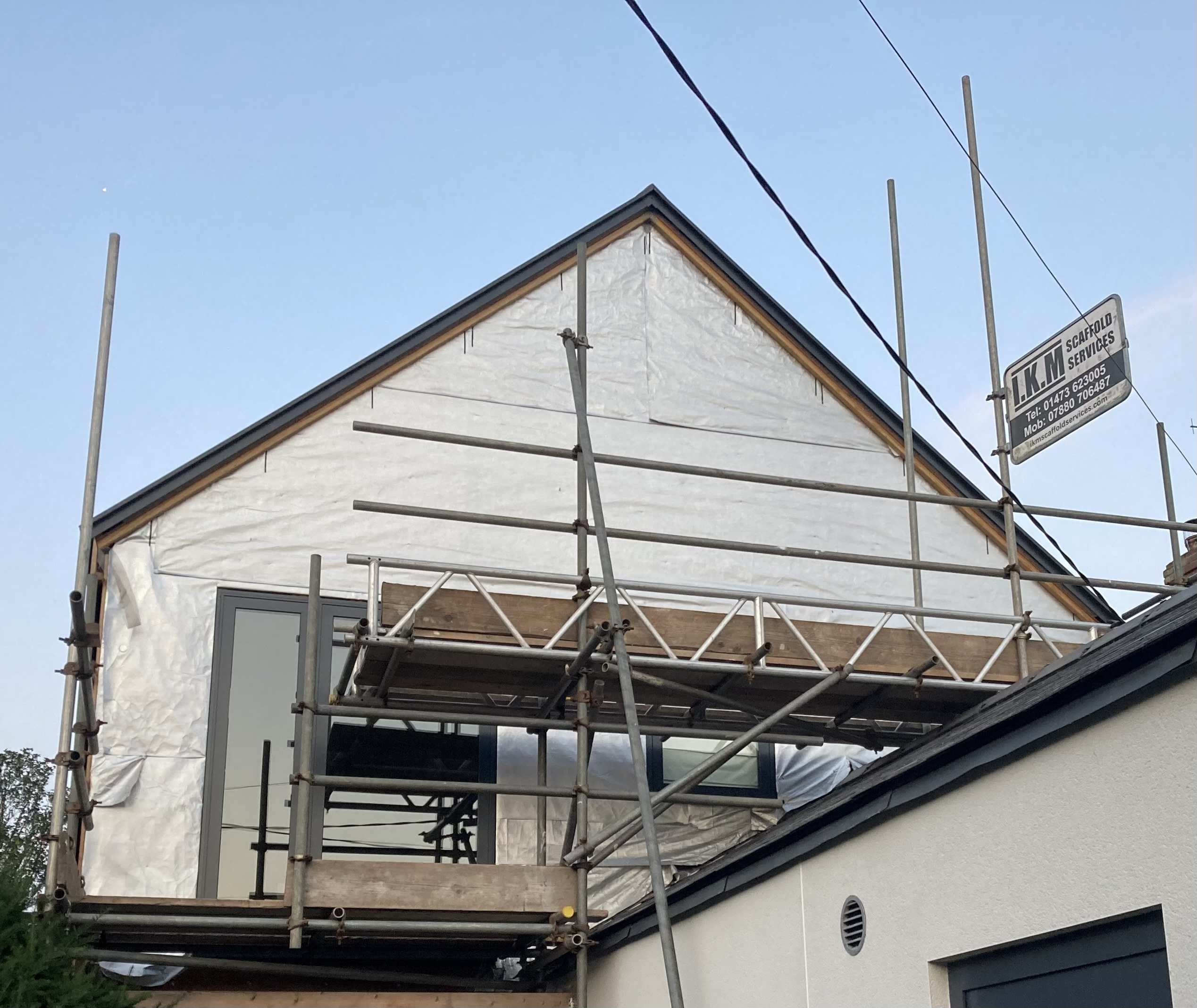

And the first question I ponder is what to do about the breather membrane on the front of our house.   For various reasons the front upstairs gable of our house has not had its timber outer skin put on.  Scaffolding has now gone up so that will be remedied soonish.
But what to do about the breather membrane?
It’s the expensive Tyvek reflective stuff supplied by ETE, the timber frame company.   It’s specc’d for four months exposed.   We’ve been a lot more than that.  It was put up in September.  It now looks a bit like my skin, rather more wrinkly than I’d like.
The timber skin is 24mm larch which overlaps nicely so should keep the vast majority of the rain, etc. out.   I think the main functions of the membrane are to keep wet out of the frame, and to allow water vapour out so that any atmospheric moisture in the timber of the frame can escape.
So do I leave the existing membrane in place and add another layer or is that likely to reduce the passage of moisture too much?
Or do I cut the existing stuff away and put new straight onto the OSB of the panels?
Guidance gratefully received, as always.

I'd worry that two layers of breather membrane, especially when one has had its performance degraded somewhat, won't behave the same as one, and lean towards replacing.
Pessimistic I know but a lot cheat got than remedial work down the line
Pics ....
I am suspicious of the double wrap too.
It might not always be as good an idea as first it appeared to be.

Sorry, forgot to post this.  Exhibit A : one wrinkly membrane…
Looks OK to me. I'd be inclined to staple the wrinkles back, then tape wherever it feels the right thing. If you can make any wrinkles lap downward then they won't hold any water. It will look much better and that is probably the only issue.

Ummm, I haven’t taped all the other acreage of breather membrane.   Bit late now as most of it is safely covered.   It’s all carefully lapped as per, but not taped.

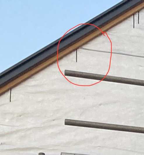

Looks fine.  I would normally expect to see vertical stapled on tape to identify where the studs are.
IMG_9530.jpeg.dee5e82d52b71af446acfff170df4e0f.jpegWe’re using very short studs on our build lol
Our upstairs panels were delivered without breather membrane as the flanks had to be clad first in cement board.   So when we put the membrane on I just marked enough to level from.
38 minutes ago, Mr Punter said:
Stapling the tape on may help straighten it up a bit. Get it clad ASAP.
It’s on the todo list.
I’ll soon be whacking on the vertical battens.  Horizontal soon after that.  The cladding takes a remarkably large amount of time.
