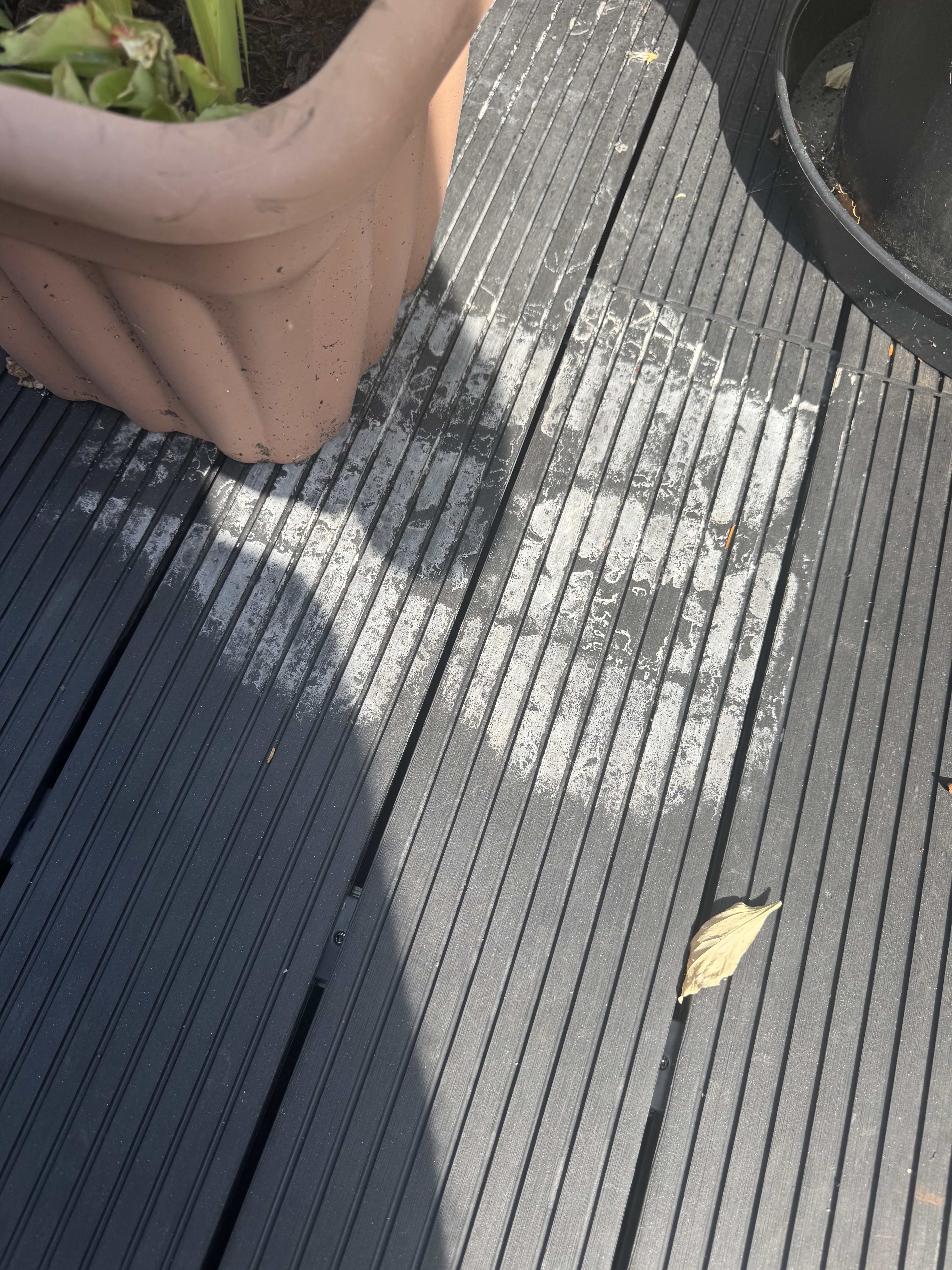

Someone lazy in our household left concrete blocks on the decking for some considerable time . On removing them get these white marks . Tried cleaning them with various things but won’t budge .
This permanent or can be removed ?

I'd try a bathroom / kitchen limescale remover.
More likely a chemical reaction between the wet concrete and the boards.

Brick acid?  Do a test patch first.
yeah I did think of things like that. But is a visible area so its tricky to "test" a patch......
What about Pink Stuff?
Been surprised at what that shifts, calcium deposits engrained on glass etc.

Not the same materials, however we had a cast iron seat on our porcelain tiles, when I moved it there were little rust marks where it had been stood. Nothing shifted those rust marks, tried everything…
…and then I used a Brillo Pad, and that did it.
May work for you?
gpt reckons vinegar, or citric acid and leave for 10 minutes to try and dissolve the calcium deposits... Might need a few repeats.
Gently electric sander on it with water . Not perfect but much better 👊🏻
