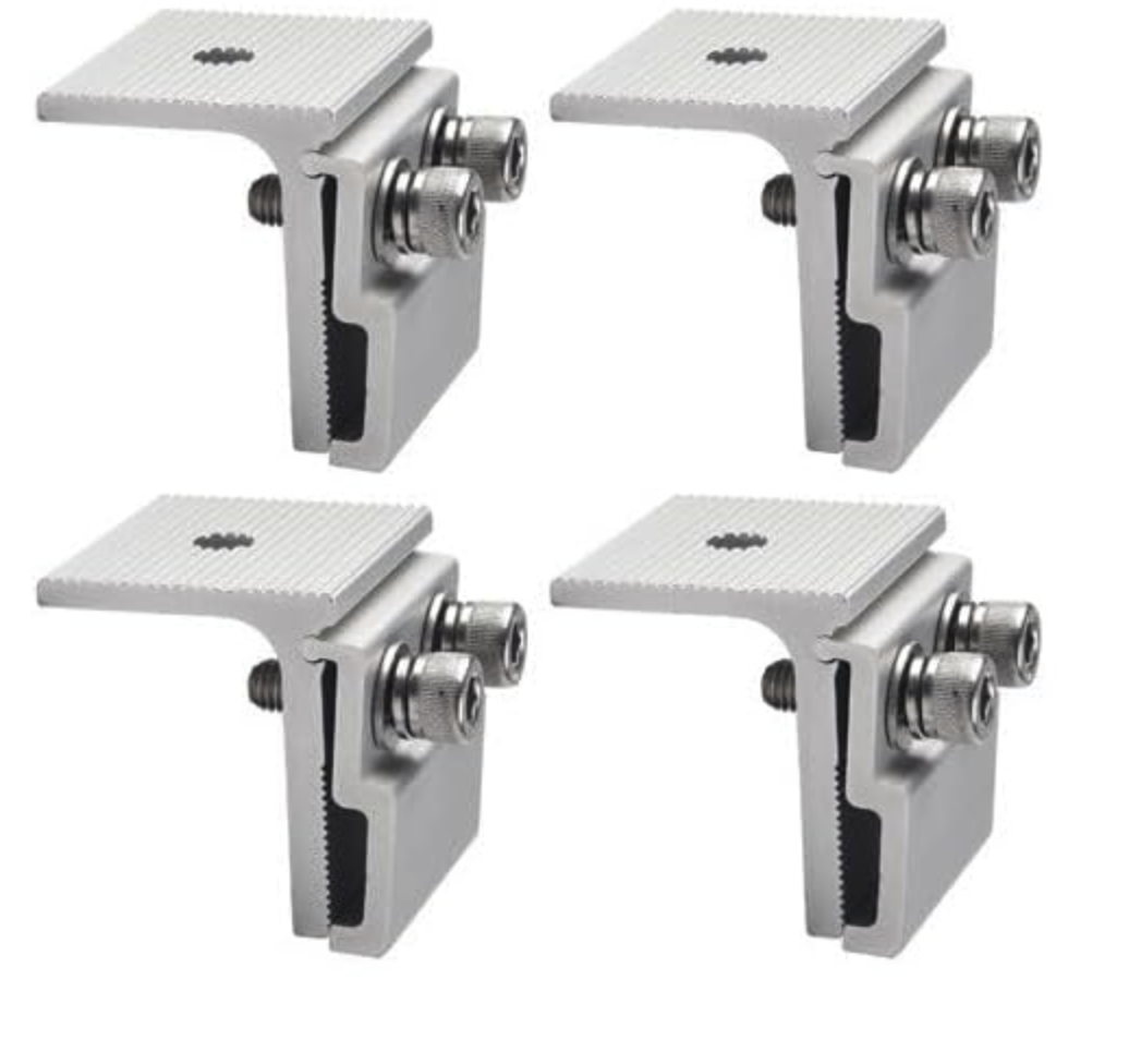

On 16/06/2026 at 17:28, saveasteading said:
There should be clamps designed for every standing seam product, allowing you to use standard solar panels.
Do you mean like this?
Looks like they grip on the vertical seam section and then provide a mounting point for the solar panel, though not sure how you size roof seam width to solar panel width without ending up with a Meccano set's worth of scaffolding.
Has anyone got any experience of using these?
That is what I meant, but they may have to differ in geometry, and perhaps have added bearers/infill pads, to suit each particular panel.
I really meant that the panel suppliers should be more engaged in advising on the subject.
The clamps shown will grip very tight to whatever is between the jaws but might  damage it.
Plus will they rip a lightweight material (aluminum)?
It would be easy for the panel manufacturers to design or recommend an appropriate clip. I feel they are deliberately avoiding the issue.
Then there is the issue of how the panels themselves are fixed. It is usually a clip-on to an upstand cleat.
How are they fixed down and can they withstand uplift?
Were the designers advised to allow for solar panels? Or did they ask?
My other issue is why one would pay  a large premium for standing seam, then cover it.
My experience of this is second hand. Having built a multitude of metal roofs, none had standing seam because I advised clients of the pros and cons.
But our supplier, who had many options including SS,  was very nervous about the number of buildings throughout Europe, Standing seam especially but also profiled,  that were being solar panelled without consultation on dead weight or uplift.
I'd have thought there's a structural adhesive that could cope with bonding brackets, rails to fix the panels to.
