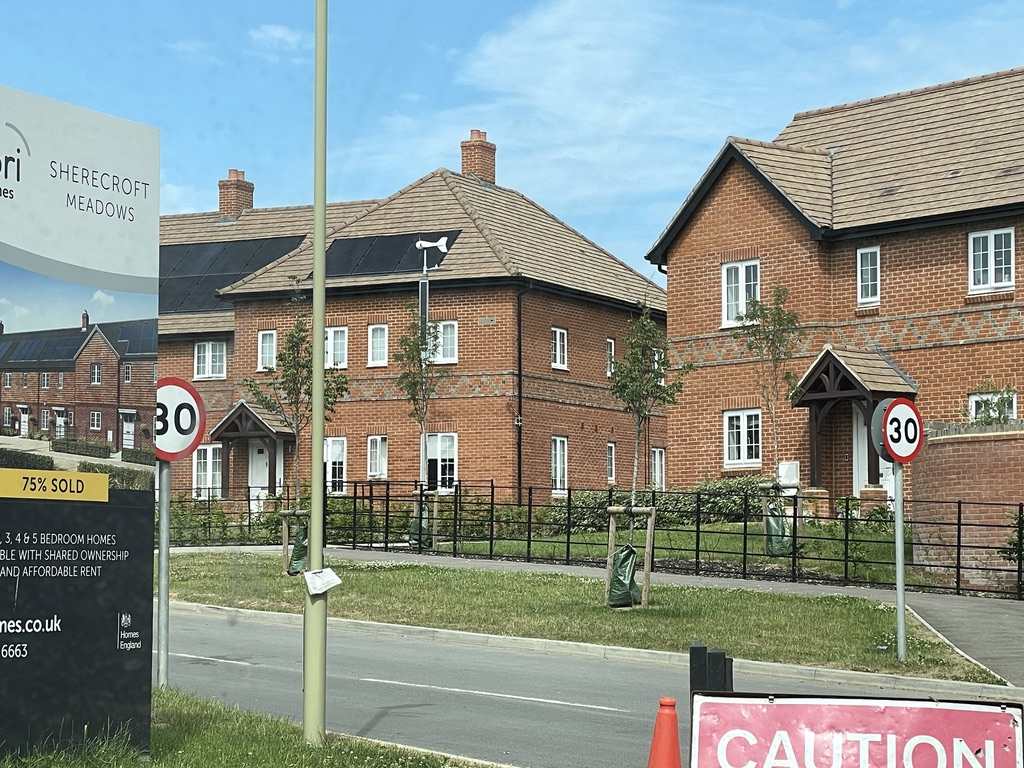

I noticed this wind turbine the other day (outlined against the solar panels) on the edge of a new development.
Surprised for two reasons:
First, will it actually achieve anything meaningful?  It's quite low and surrounded by houses and some high trees to the south west (where prevailing winds come from).
How/why has the local planning department agreed to it?  It doesn't seem to fit the criteria required for personal wind turbines, even permitted development rights.

It appears to be on a pole along with a small solar panel.
It likely powers a street light which illuminates the adjacent footpath.

I noticed in Spain that all new street lights appear to be solar. At first it seemed to be on commercial estate but now on dual carriageways.
The weather helps of course.
Must be much cheaper to install than mains, with no trench or cable.

It's likely powering a device that doesn't have a mains connection - e.g. logger/telemetry system on a utility, LED sign etc etc. Often these units are cheaper than getting a connection to the mains. Also, if there are road opening embargoes, like you would in a new development, there might not be the option to make a connection.
It's a street lamp.  You can see the lamp above the solar panel (maybe it is self powering at night 🙂)

Interesting, I wonder if the people putting these up have to comply with the same building regs requirements as a home owner would?
Or will it be different because it's the Council so normal rules don't apply...
I remember a billion years ago there was a requirement for 5m distance from ground to blade tip (and from any windows) for building mounted units.
Not sure about free standing rules.  This will only be 3-400 watt max turbine. Noise will be zero unless you stand right under it.
