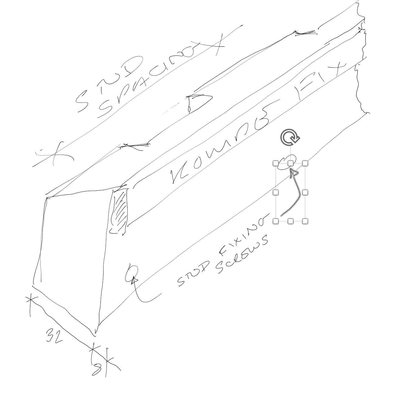

It's been recommended I use KompeFix ventilation strip to keep the wood wall battens and horizontal cladding apart - presumably to avoid trapping moisture between adjacent wood and allow for a little movement. That is:
https://www.russwood.co.uk/shop/product/kompefix/
It's only GBP 2.22 per m - which sounds OK value until I figured out I needed about 750m / 1,700 quids worth.
Are there any good alternatives?

We have purchased this with our cladding and they estimated 16 rolls, our cladding is vertical, I did the calcs and got a couple of rolls less but stuck with the estimate. We are not using their battening system as we don't have the depth. Instead I will make up some custom notched battens that create the air gap at the back, have the  top slope and allow the use of the Kompefix on the front face.

Could be - but at least I am following the manufacturers recommendations so I should be able to have some comeback if it does not work. This is the drawing I will be following in spirit at least.
We've followed the above (vertical cladding) the first vertical batten means the slope on the second horizontal batten allows the water to run off into the cavity....or at least that's the plan!

Ours is closed, tung &  groove, detail is the same though. If the drops are long you need a gap at the joins. I am hoping we don't need them.
