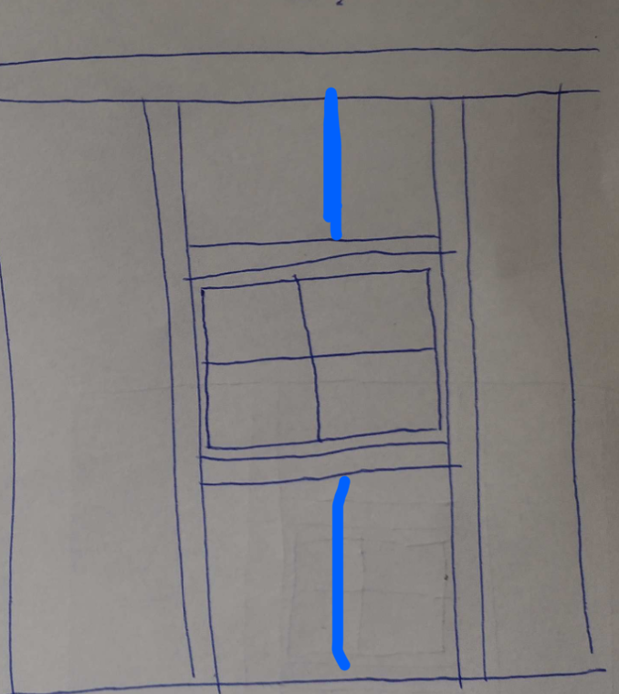

I now have two quite heavy triple glazed rationel windows I want to place directly on top of one another, this is to provide air flow for a double bunk bed for the top and bottom bunk area, so each area the lower bunk and top bunk both have a window that can be opened on hot nights to let cool air in. Is this possible? Seems like there won't be enough stud support for the upper window. How might this look? Do I just have to ensure there is a suitable gap between the windows for the stud work to carry the load of the top window rather than having them too close to one another?
With some of the Rationel frames you can couple them in a stack.  Have a look at their install literature or ask their tech dept.
It says installation must adhere to BS 644, I go to find out about the code and it requires £200 or so to look at it, so I'm not doing that.
I figure what is in this sketch should be sufficient similar to what Simon d posted. Weight of each window says 6,0 ? Whatever that means I assume that's 6kg but they do seem a lot  heavier imo.
Edited by cowboy25
Update I think this would be better:
Yes.  Don't have plasterboard as a strip either side and waistbands in the middle.  Make the plasterboard L-shaped or e-shaped if you can and you won't get cracks on the joints.
