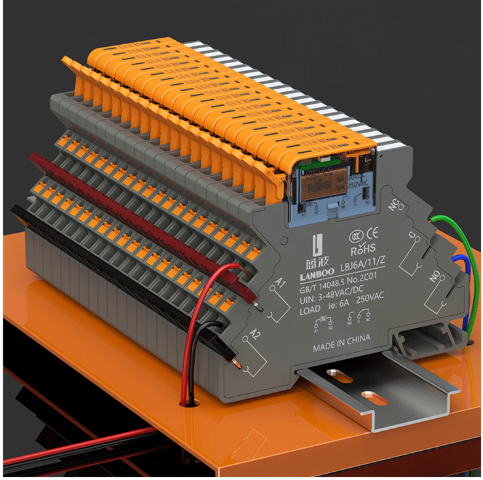

MortarThePoint Posted 6 hours ago Author Posted 6 hours ago DIN rail would arguably look more professional I agree, but ultimately you could still have dubious DIN rail parts These look nice, but the CE logo looks more like the old China Export trick. There are also things like this that claim to use Omron relays:

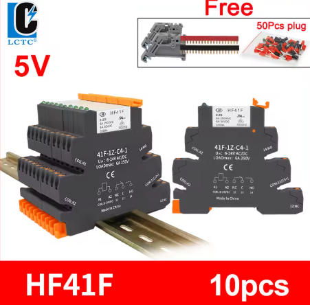

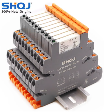

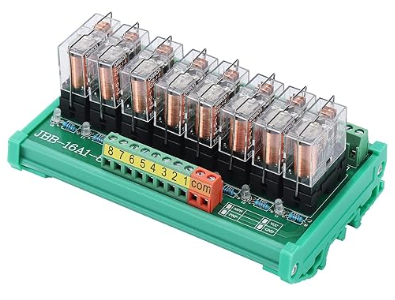

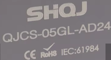

MortarThePoint Posted 5 hours ago Author Posted 5 hours ago The main issue with the individual DIN rail mounted relays is the need for control buffering since the coil powers are too high for GPIO control. Nice servicability though These are tempting: They appear to use HF41F relays: https://static.rapidonline.com/pdf/507532_da_en_01.pdf Those 5V relays have a 147R coil resistance and 170mW coil power. 34mA is too much for unbuffered GPIO use though. These look really nice, but the coil power (0.9W) is unacceptable:
-rick- Posted 4 hours ago Posted 4 hours ago (edited) 1 hour ago, MortarThePoint said: DIN rail would arguably look more professional I agree, but ultimately you could still have dubious DIN rail parts Stop looking at aliexpress/ebay. Start looking at CPC/RS/Rapid/TLC-direct/CEF. More expensive but no worries about certification and going to be at least reasonable quality 55 minutes ago, MortarThePoint said: The 16channel PCB for £11 with a £9 Raspberry Pi saves quite a bit too. A bit too much for my liking Exactly. Presume you are installing something you want to last and not require constant fiddling. In which case get something from known sources that your electrican is comfortable with. Even if you do want to constantly fiddle, I'd guess fiddling with the software/end result side of things rather than replacing iffy parts is where you want to spend your time. 43 minutes ago, MortarThePoint said: The main issue with the individual DIN rail mounted relays is the need for control buffering since the coil powers are too high for GPIO control. Nice servicability though But you said you can design PCBs? Even if you buy one off the shelf. Options exist: https://paradar.co.uk/products/owl-driver-board-raspberry-pi-automotive-relay-hat?variant=55334464618879 (not keen on form factor) Things like this is another option: https://revolutionpi.com/en/ 43 minutes ago, MortarThePoint said: These look really nice, but the coil power (0.9W) is unacceptable: Look at latching relays. Requires more IO/drivers but no consumption during use. Still I will go back to my original point. If you are going to the effort of a custom system why not look at using off the shelf dimmer modules that you can control via the Pi? Plenty of options. Yes more costly than buying iffy stuff from AliExpress but a long term solution that offers way more flexibility than simple relays. Edited 4 hours ago by -rick-
