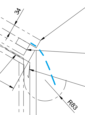

How do I get the right roof overhang to drain into the gutter?
I'm monkeying with this geometry (below). How do I judge how much the metal roof should overhang the fascia so rainwater slooshes down and goes into the gutter rather than shoots over the top of the gutter (i.e. something like the dotted blue line)?

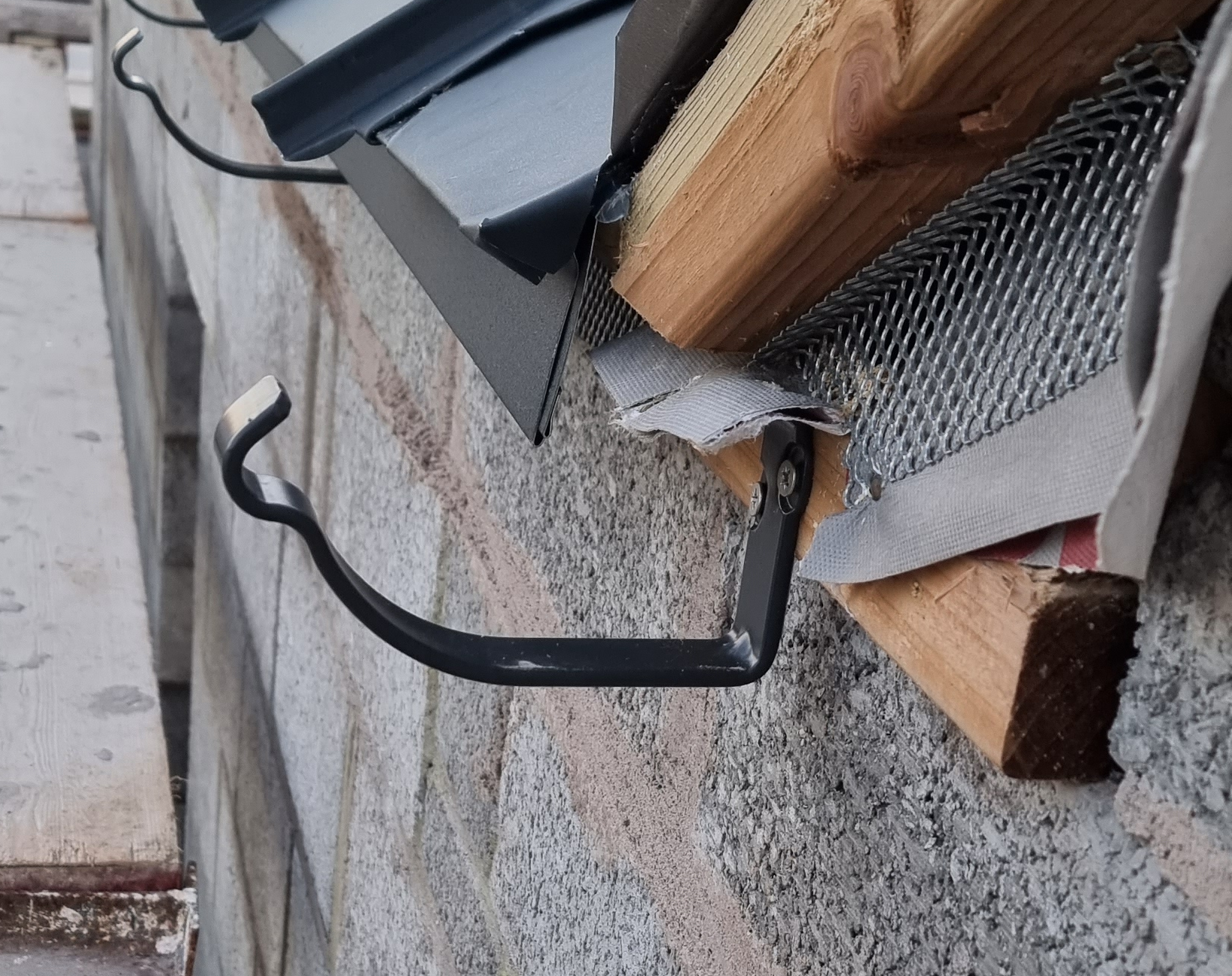

There will typically be an eaves trim that gets fixed to the edge of the top deck, with a downturn that sits in the gutter. The metal roof sheets are then swaged to this trim to lock it all together.
Our metal roof supplier told the joiners what was needed for this.  He told our joiners to leave about 20 mm wall plate overhang for the gutter brackets and these were installed prior to the metal roof.

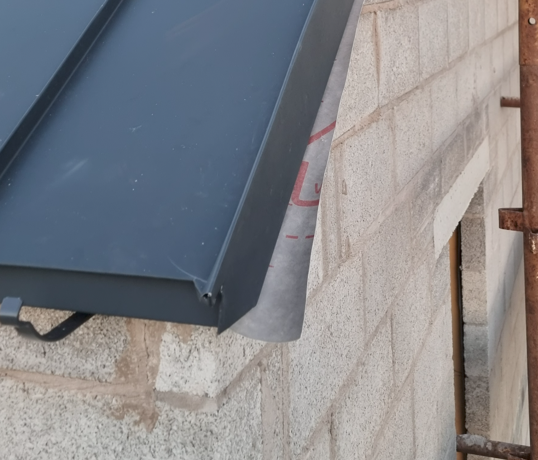

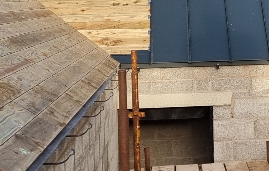

... which is great, but, the roof supplier didn't plan the metal detail for the gable end / gutter correctly.
There should be an allowance at the gable end so that the gutter can continue through.  Look at the photo below and you can see what the issue is.
The metal on the gable end stops the gutter running through to an end cap.  We had to butcher it to make it right.   Its worth checking with your metal roof installer that they will cater for this properly.  Unlike our roof 🙄

I can’t make out from your drawing what is cladding, cavity etc. But my understanding is that they want to fix the gutter to the outside face of the cladding (or equivalent timber).
I was told by our steel roof installers to bring the top deck of OSB3 out to the same projection as the external face of the cladding. They then make the overhang and drip edge with their metal eaves trim, and the gutter is fixed through the outside face of the cladding to the timber.

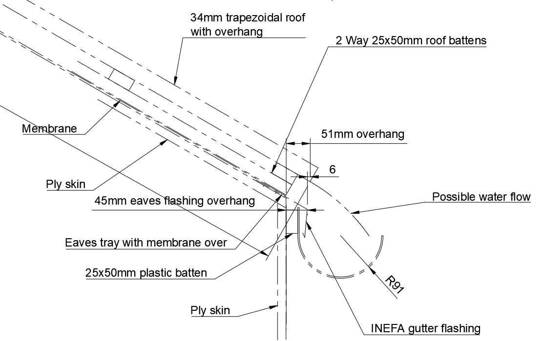

OK I've modified the geometry with your feedback above. I think that'll work, thanks. A useless fact I learnt is that the water falls in a parabola, presumably dependent on the velocity it flows off the roof.

I think the important thing to do is ask your metal roof supplier how they want it.

In drizzle the water barely dribbles off a small roof and may even stream back towards the wall, so a clear projection is needed.
In a storm, the parabola could be quite a long and flat one.
In your drawing above  I'd like to see a deeper gutter that is higher so that the water always lands inside.

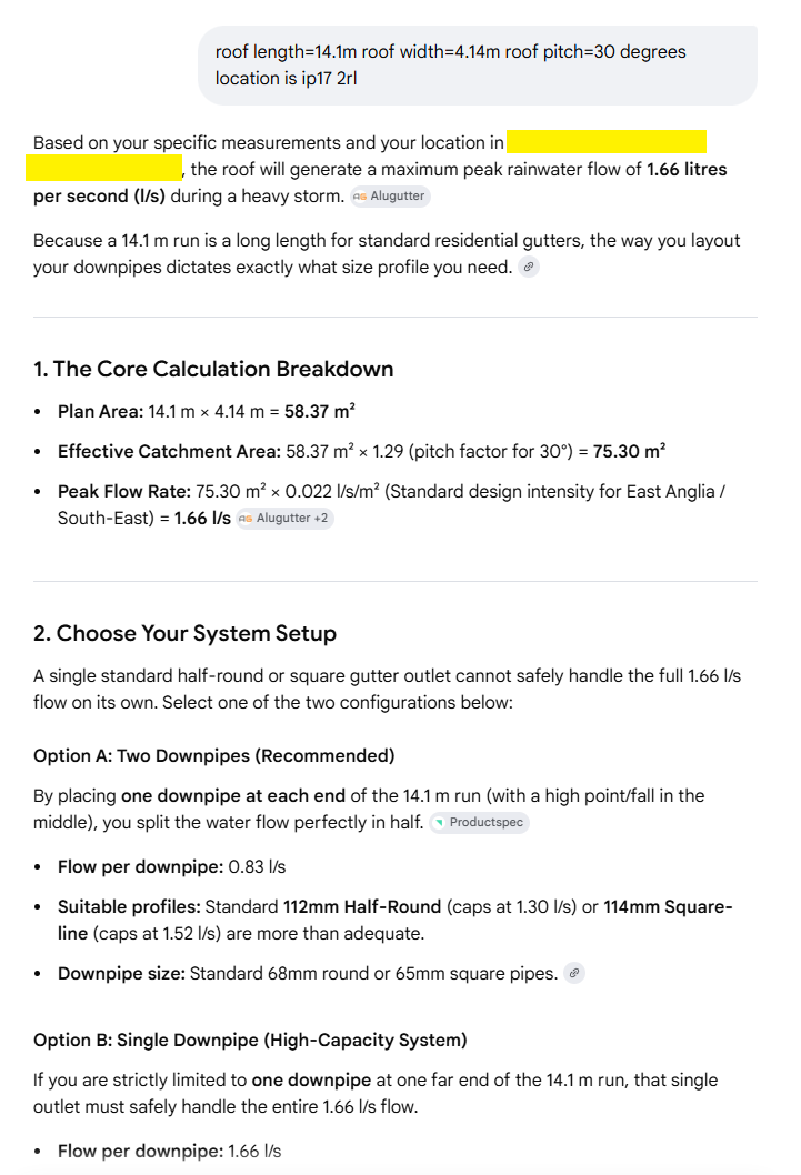

Ah, as Dunc says there are some calcs - by and large they ignore the roof materials and sometimes the location/rainfall characteristics. Don't know how I missed those...thanks guys. e.g.
That's remarkably good info from ai.
Fortunately ig has found and cringed good advice, not bad.
I'd only sat that outlets are better at quarter to third points than ends as water runs both ways with shorter travel.
