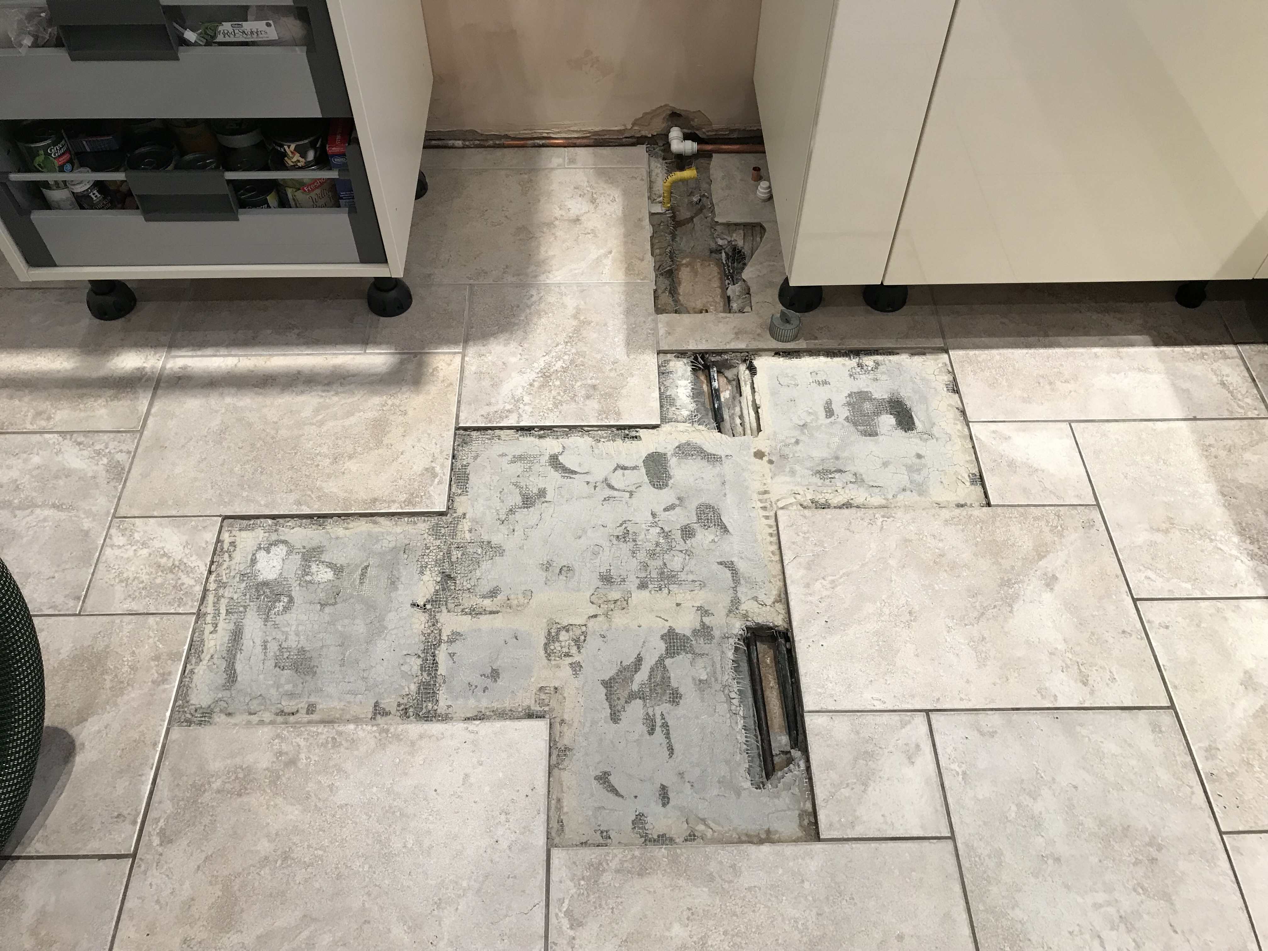

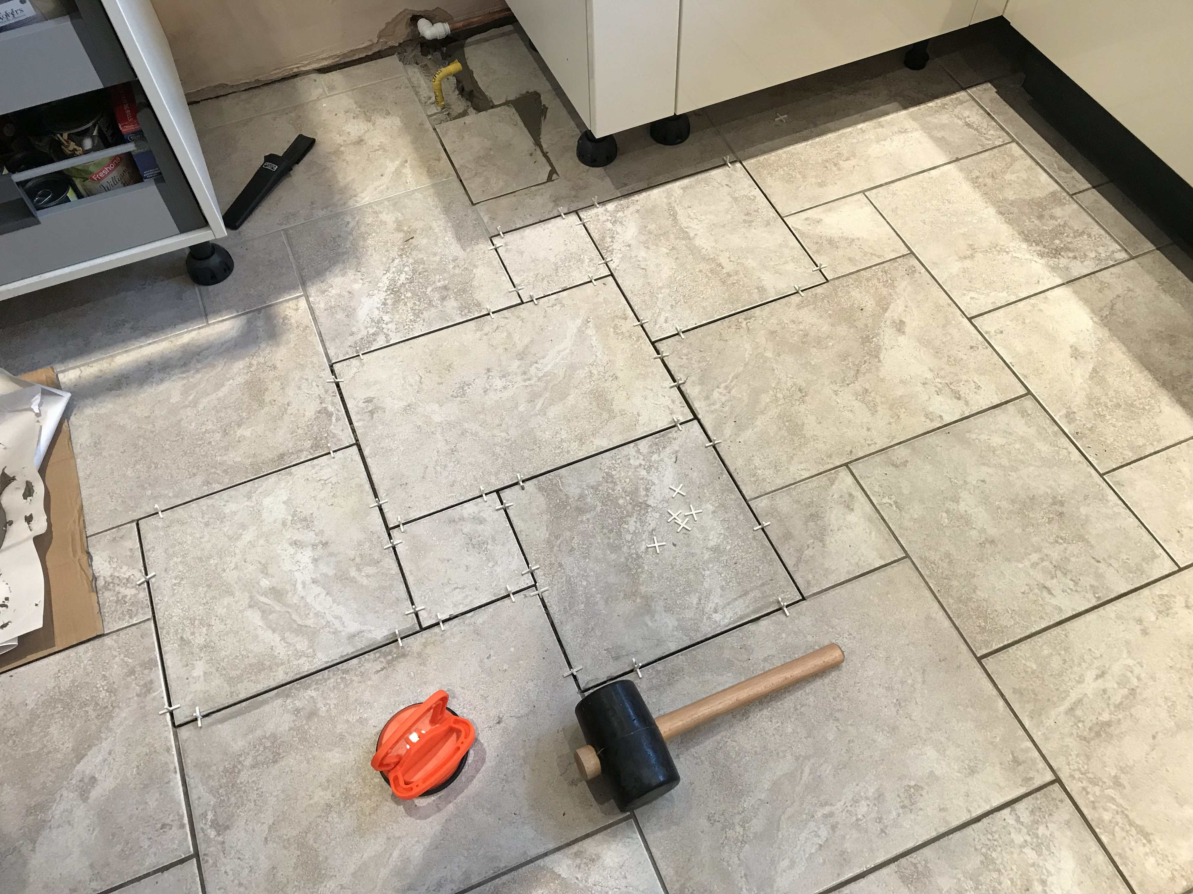

In real life, copper pipes under the floor might spring a leak (pinholes in bad copper that had been down for 20+ years and eventually corroded through) and you might need to dig stuff up to find the leak and effect a repair...
