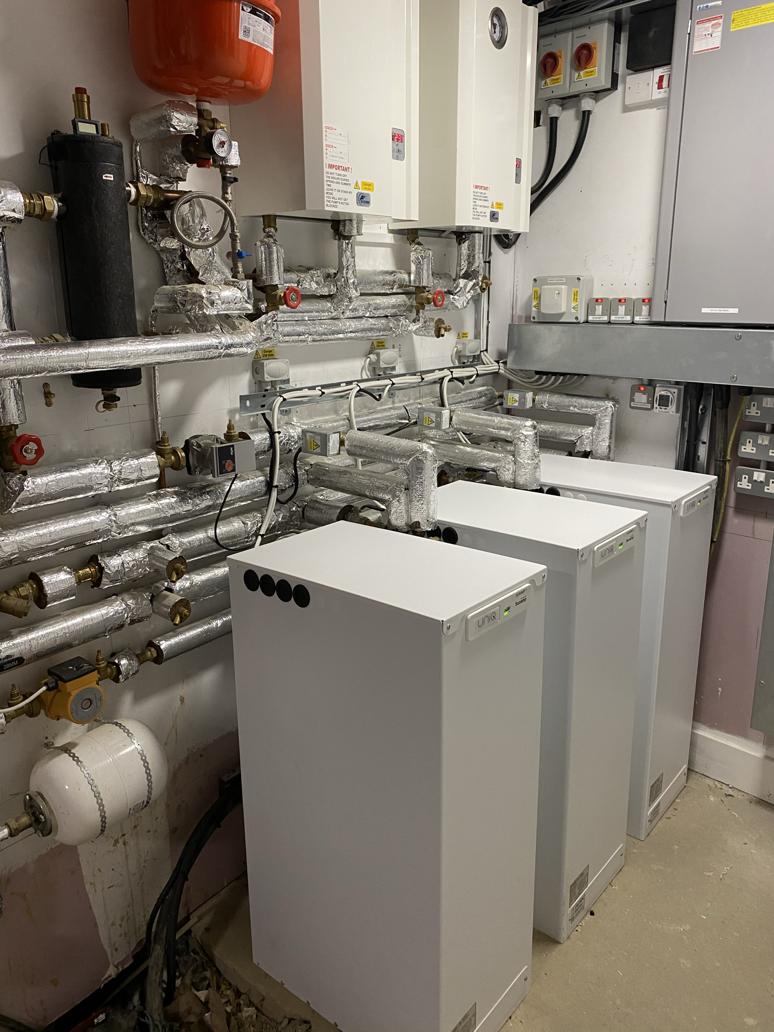

I did this plant room out of my brain space, from scratch. Just sat there for 4 hours in silence planning it out, then told my electrician where his cable trays needed to be so I could plumb around them, so he could get started on 1st fix before my kit even arrived.

Whats the metal tape you have used here wrapped around the insulation and is it worth using?
Do you mean why is the insulation silver, it comes like that, it’s a two piece rockwool lined product you put on and then cover the gaps in foil tape.
I paid a guy to come and lag it all for me, and he worked mostly in light commercial etc so it’s default there.
Not really necessary but the phenolic stuff comes foiled as standard.
Not much need in a domestic (but satisfies OCD), and the grey EPS stuff is no better or worse than the neoprene, same values etc, so if you’re inside the heated and airtight envelope then the insulation is mostly relevant if cooling.
