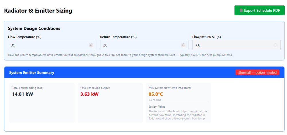

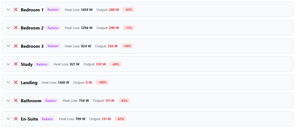

Full RdSAP10 (from June 2026) construction library is now in the tool. It's under the U-value library similar to floor u-value calculator.
  • 3 weeks later...
Global radiator library now added which include Stelrad classic compact catalogue and Kartell K-Rad Kompact - all from K1/Type 11 to K3 Type 33.
More to come from other manufacturers.
