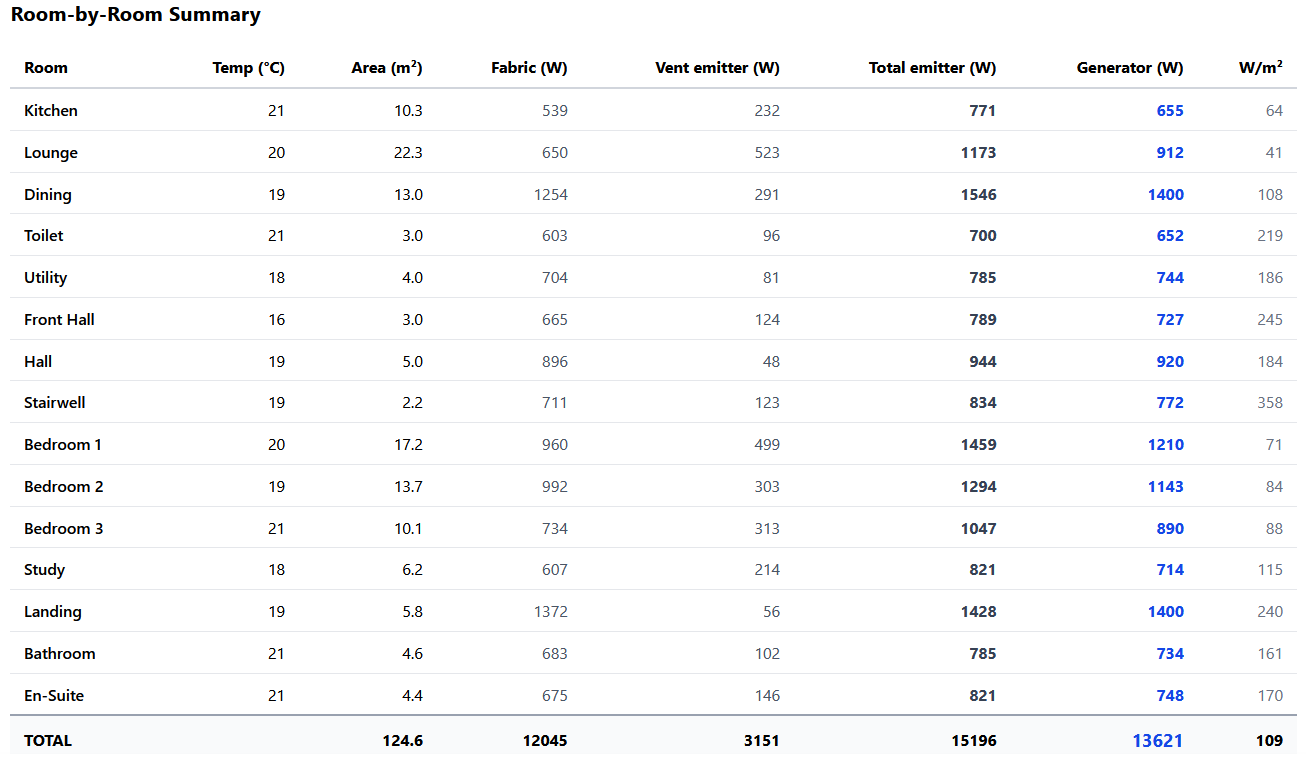

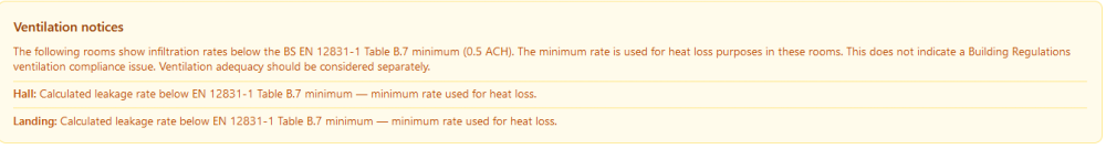

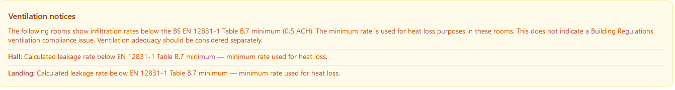

OK Finished
Two Warnings
I think I understand both are due to the internal nature of the Hall and Landing being centre of house so no external wall ticked
So now I need to understand why the result (if I am reading it right) at 12 kWh is 3 times my current heat loss 🙂
Current heat loss is just under 4.0 kWh at -2.5 Deg C
So I've definately made an error somewhere :D

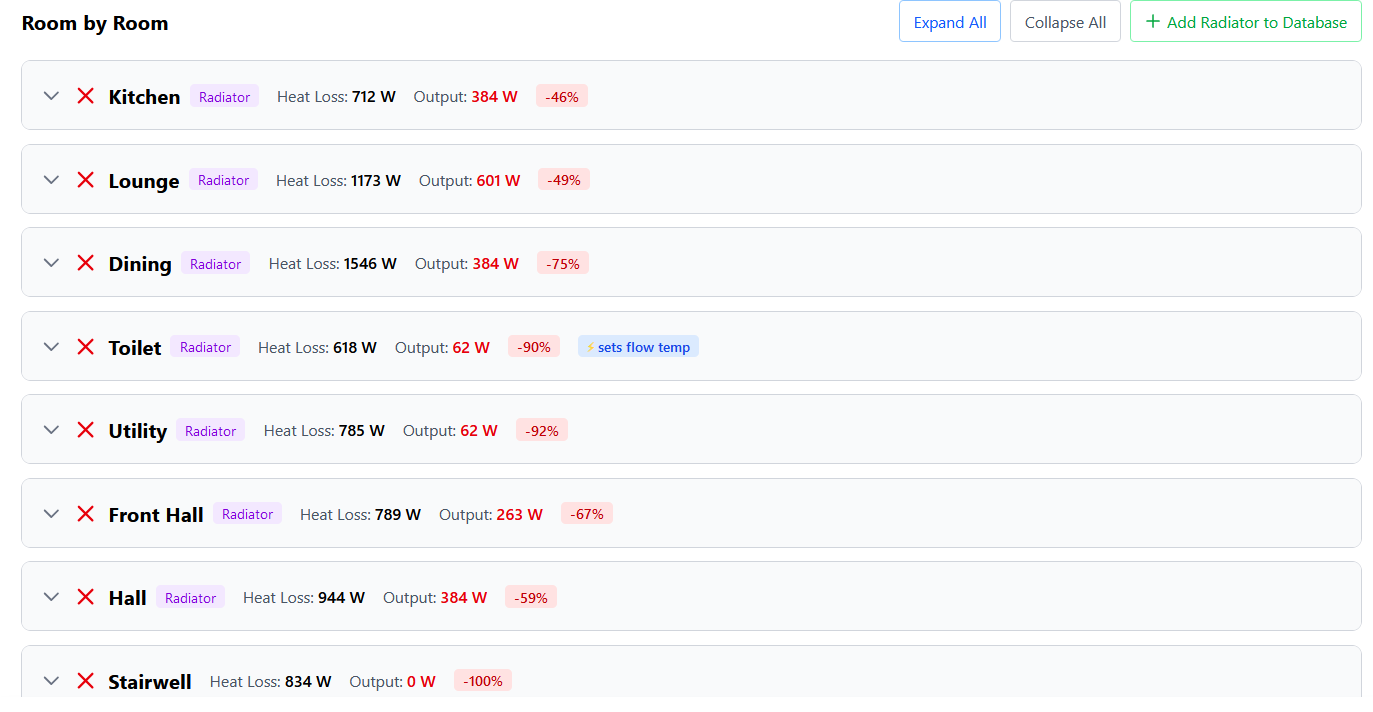

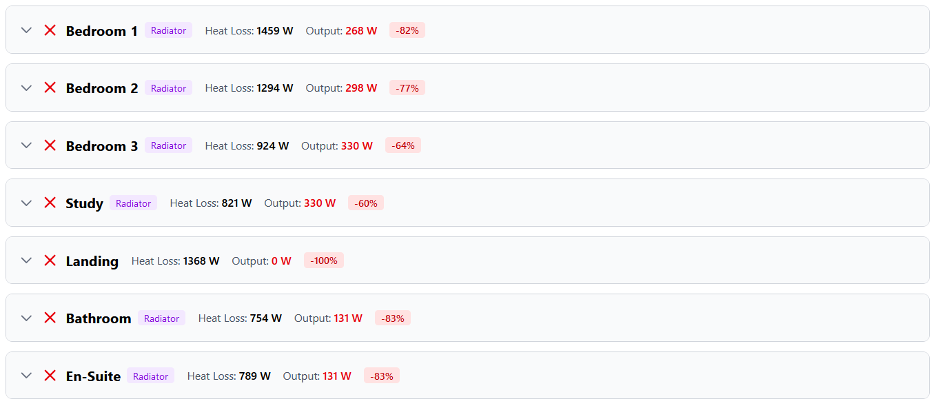

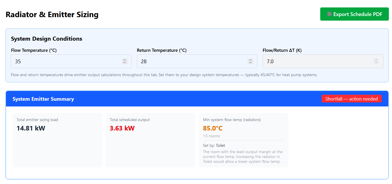

Rad Evaluation at my Target Flow Temps
Edited by marshian
Fix missing rad
14.83kW emitter sizing load? That seems massive. Something doesn't seem right there. Do want to show some of the room inputs? Or PM me screenshots?
Sent you a PM
Amusingly for me anyway the total actual Rad output is spot on for my heat loss
I know I've cocked up somewhere just can't see where 🙂

Here you go. This is a lot better. Not quite there yet, but about 1/2 of what you were seeing, but as you can see the calculated fabric losses of 4.22kW are much closer to yours, but this is at -4.6 which is the conservative MCS post code lookup:
In the rooms editor, there is a column labelled Design dt (C). When you add a new element, it default to the Design dT of room temp - outdoor design temp. Then next to it is another column for ref dT which is the default delta T between room temp and Typical Outdoor temp.
For all internal elements this needs to be set to the difference between internal rooms, or 0 if there is none. I've just gone and updated all your internal settings to this, which has made the difference. I may have incorrectly amended some of your insulated ceiling which may be external?
I've then gone and change the outdoor design temp from -4.6 to -2.5 and as you can see, the fabric loss is now down to 3.84kW and generator sizing is 5.26kW:
The total emitter sizing is quite large compared to what you're experiencing with your low flow temps etc. which means I need to dig into the calculations to make sure I haven't got something wrong in there, but I suspect that because of the way it has been implemented, there's been a cautious approach taken by CIBSE in how they've implemented the new method. It wouldn't surprise me and is actually a good thing as it's better to upsize rads for worst case scenarion and reap the benefits of lower flow temps over the long term. But I will need to check.

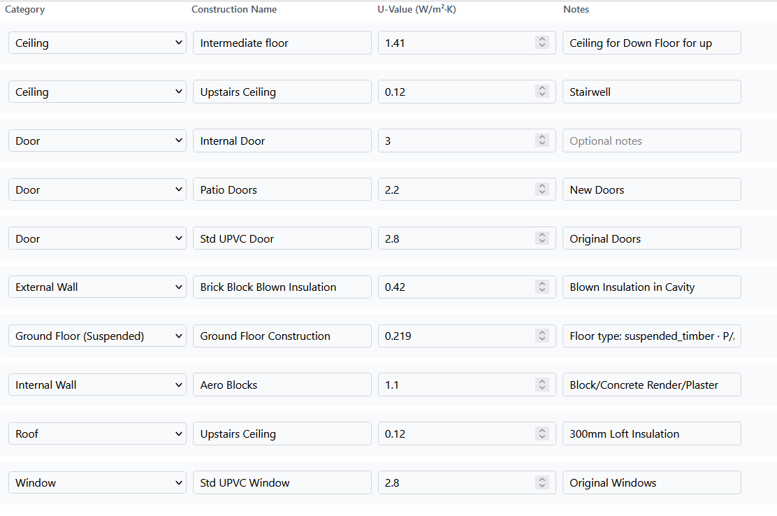

I'd also recommend you go over your element inputs just to check the assignment of U-values from your U-value library and some didn't quite match.
Hope that helps?

OK checked out the changes - made a couple of tweaks now I understand the logic

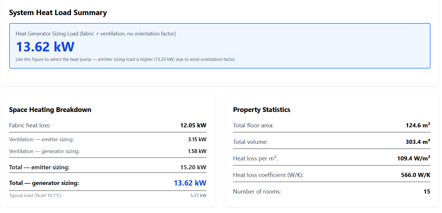

Last point - pretty sure it's ventilation losses that are driving the higher calculated heat loss
Fabric is now 4144 W
Ventilation is 3090 W
Anyway to reduce that ventilation factor? I guess I see a blower test in my future :D
It's a bit prescriptive on the ventilation, so there isn't anything immediately available to make adjustments to this ventilation factor. There are still some questions about how BS EN 12831:2017 treat ventilation and the CIBSE guide uses a bit of SAP in there. I'm going to have a think about this one. It's really the way it's calculating infiltration leakage which is giving you the high figure, but you've got to be a bit careful how you interpret the Ventilation - Emitter Sizing. This calculation isn't saying that you are going to use this amount of energy at a given time, which is your Fabric loss and Ventilation - Generator Sizing. The Ventilation - Emitter sizing, although provided as a total, should really be looked at in relation to individual rooms because it's essentially calculating the effect of high winds on each room based on the exposed area. So at any given time the rooms won't be losing all heat to the outside, but transferring to other rooms within the building. But high infiltration will increase the heat load within the room subject to high infiltration and so the standards are encouraging us to install slightly larger radiators and thus improve efficiency. Does this make sense?
Makes perfect sense - before I insulated between the joists of the ground floor with 75mm PIR you could feel a draft in most rooms when the wind got up - now it can be a bloody good gale outside and there is no drafts at all........ I know I've got the house reasonably well sealed hence the installation of a PIV unit to manage humidity and ACH's (But it's not MVHR :D )
