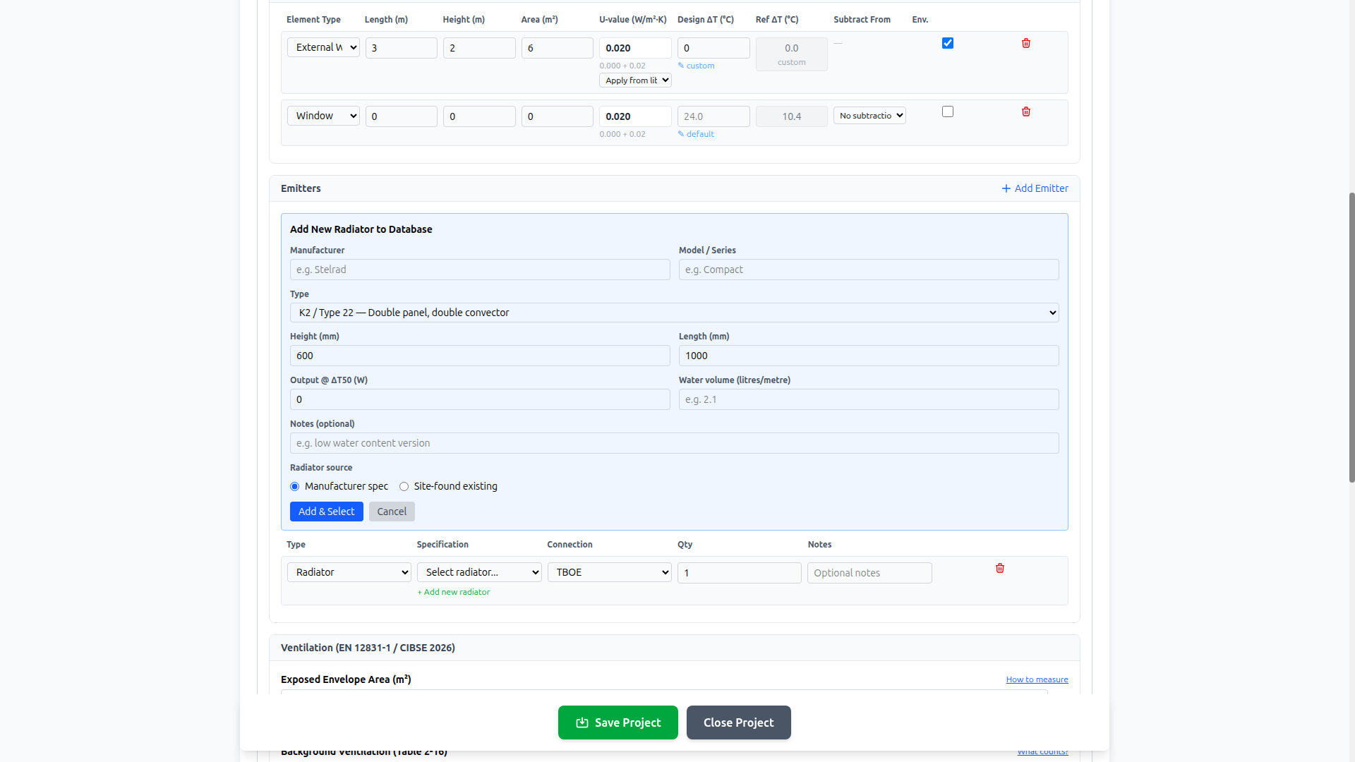

April 13Apr 13 OK few questions Rads Adding radiators to the database - is that to a central database so others can look up or just for the project in question What would I select as type for a 1800 x 578 double flat tube vertical rad I know the kW rating at T50 I know the volume of the rad (because I measured it on a drain down - call me sad if you like) but how would I calculate the litres/metre U-value (W/m²·K) I know the U-value for my external walls Brick 102mm Mineral wool in cavity 50 mm 100mm std aerated block 13mm plaster is 0.45 (well that's the closest approximation to what I have) So on external walls I should select a U Value of 0.45 but I can't seem to change it from the default 0.10 am I muddling my units?
April 13Apr 13 Author 1 hour ago, marshian said: Adding radiators to the database - is that to a central database so others can look up or just for the project in question Any radiators you add go into your own 'company' radiator database linked to you as a user, so if you had several projects, you'd build up your own database of radiators. Nobody else has access to those or can edit/change them, they're yours. In the wider version for managing several projects, there's even a project settings page where you can add edit and delete you own database. If you want access to this wider version with multi-project capability, ping me your registered email address and I'll change your settings to 'beta' test engineer in the system. 1 hour ago, marshian said: What would I select as type for a 1800 x 578 double flat tube vertical rad I'll add flat tube radiators to the type as a system addition, but for now, two column would work fine - the type doesn't really matter that much, it's more for your own reference. The important bits are output at DT50 and water volume really. And then size if you're putting a new one into a space... 1 hour ago, marshian said: I know the volume of the rad (because I measured it on a drain down - call me sad if you like) but how would I calculate the litres/metre Not at all, I've done that to check volume on existing rads myself, but luckily most rad manufacturers now provide l/m figures in the tech spec. Stelrad actually even provide Kv. To get the l/m min take your total measure volume and divide by length in meters - so in your case the 0.578m 1 hour ago, marshian said: U-value (W/m²·K) I know the U-value for my external walls Brick 102mm Mineral wool in cavity 50 mm 100mm std aerated block 13mm plaster is 0.45 (well that's the closest approximation to what I have) So on external walls I should select a U Value of 0.45 but I can't seem to change it from the default 0.10 am I muddling my units? Best thing to do in the workflow is add all your standard elements into the U-value tab and create your U-value library. Do this especially for all your floor U-values by using the Floor U-value calculator as floor U-values vary according to the Perimeter/Area ratio. Once that's in you'll get an automatic drop down when you add an element in the rooms tab. These will then auto-populate and add the thermal bridging addition. I've been back and forth on the editing of value directly in the room as if you skip creating the U-value library and you're working on a large project, inputing into individual room elements gets very tedious, which is partyl why I locked it to force users back to the U-value library. I ought to put a user hint in there about this. The other bit to bear in mind here is that if you add a door or window to the room, you'll get another automatic drop-down where you can select which element area this door or window needs to be subtracted from. So if you have an external wall added, this will be listed in the dropdown and you just apply it. The reason to do this is because this will apply the correct calculation for fabric loss, but at the same time used the full external element area for the ventilation & infiltration calculation. To make things easier to follow, I tend to add the wall element, then add any corresponding window or door to that element and subtract it. Then move onto the next element. Then in the elements also remember to change any internal element's Design Delta T (e.g.partition wall) to the difference between the two adjacent internal spaces and not leave it at default. Elements roof, ground floor suspended, external wall are all automatically added to exposed envelope so if you have a ceiling that is the external envelope, then you need to add this to exposed area by selecting Exp. I have on my to do list a load of videos to walk new users through the tool. If you spend a lot of time inputing this stuff, it follows pretty much a normal design workflow but it's not obvious at all for someone not in the industry. Edited April 13Apr 13 by SimonD
April 13Apr 13 20 minutes ago, SimonD said: Any radiators you add go into your own 'company' radiator database linked to you as a user, so if you had several projects, you'd build up your own database of radiators. Nobody else has access to those or can edit/change them, they're yours. In the wider version for managing several projects, there's even a project settings page where you can add edit and delete you own database. If you want access to this wider version with multi-project capability, ping me your registered email address and I'll change your settings to 'beta' test engineer in the system. email sent - to be honest adding rads has been my biggest issue - doesn't seem to want to save them! 20 minutes ago, SimonD said: I'll add flat tube radiators to the type as a system addition, but for now, two column would work fine - the type doesn't really matter that much, it's more for your own reference. The important bits are output at DT50 and water volume really. And then size if you're putting a new one into a space... I know all my rads are pretty much spot on size wise for flow temps I'm using and house heat loss - I've made all the mistakes and learnt from it - I'll use two column 20 minutes ago, SimonD said: Not at all, I've done that to check volume on existing rads myself, but luckily most rad manufacturers now provide l/m figures in the tech spec. Stelrad actually even provide Kv. To get the l/m min take your total measure volume and divide by length in meters - so in your case the 0.578m So even with a vertical rad that is 1800 mm high you divide the volume by the width? I get that for a panel rad it would work that way but thanks - good learning point 20 minutes ago, SimonD said: Best thing to do in the workflow is add all your standard elements into the U-value tab and create your U-value library. Do this especially for all your floor U-values by using the Floor U-value calculator as floor U-values vary according to the Perimeter/Area ratio. Once that's in you'll get an automatic drop down when you add an element in the rooms tab. These will then auto-populate and add the thermal bridging addition. I've been back and forth on the editing of value directly in the room as if you skip creating the U-value library and you're working on a large project, inputing into individual room elements gets very tedious, which is partyl why I locked it to force users back to the U-value library. I ought to put a user hint in there about this. Ahh this makes sense now - thank you I'll do that next time I'm back at it 20 minutes ago, SimonD said: The other bit to bear in mind here is that if you add a door or window to the room, you'll get another automatic drop-down where you can select which element area this door or window needs to be subtracted from. So if you have an external wall added, this will be listed in the dropdown and you just apply it. The reason to do this is because this will apply the correct calculation for fabric loss, but at the same time used the full external element area for the ventilation & infiltration calculation. To make things easier to follow, I tend to add the wall element, then add any corresponding window or door to that element and subtract it. Then move onto the next element. That was my approach after I screwed up the first room and didn't know which external wall I was adding a window too 20 minutes ago, SimonD said: Then in the elements also remember to change any internal element's Design Delta T (e.g.partition wall) to the difference between the two adjacent internal spaces and not leave it at default. Elements roof, ground floor suspended, external wall are all automatically added to exposed envelope so if you have a ceiling that is the external envelope, then you need to add this to exposed area by selecting Exp. I have on my to do list a load of videos to walk new users through the tool. If you spend a lot of time inputing this stuff, it follows pretty much a normal design workflow but it's not obvious at all for someone not in the industry. As I said - I like it and I haven't broke it yet which is what I'm normally paid to do
April 13Apr 13 Author 36 minutes ago, marshian said: mail sent - to be honest adding rads has been my biggest issue - doesn't seem to want to save them! Thanks for letting me know. That's my fault. I was playing around with users and authorisation earlier to create the new beta engineer test and in doing so seemed to break how radiators are saved to specific users - it was saving fine for anonymous but not any registered users! Anyway, it should be fixed now 😊 41 minutes ago, marshian said: So even with a vertical rad that is 1800 mm high you divide the volume by the width? I get that for a panel rad it would work that way but thanks - good learning point Yeah, the width is actually termed length in catalogues so you always have dimensions = height by length e.g. 600x1200 or 1800x445 42 minutes ago, marshian said: As I said - I like it and I haven't broke it yet which is what I'm normally paid to do Glad to hear you're getting on with it okay!
April 13Apr 13 1 hour ago, SimonD said: Thanks for letting me know. That's my fault. I was playing around with users and authorisation earlier to create the new beta engineer test and in doing so seemed to break how radiators are saved to specific users - it was saving fine for anonymous but not any registered users! Anyway, it should be fixed now 😊 Ahh good to know - I tried various methods and none seemed to work (As a registered user) 1 hour ago, SimonD said: Yeah, the width is actually termed length in catalogues so you always have dimensions = height by length e.g. 600x1200 or 1800x445 OK I get you but for me heat emitters are all about surface area (especially at low flow temps), flow rate and volume of water Take my 1800 x 578 vertical it has a volume of water of 10 Litres 10 litres divided by 0.578m width = 17.3 l/m 10 litres divided by 1.8 height = 5.5 l/m Compare that to my K33 1400 x 700 with a capacity of 14 Litres 14 litres divided by 1.4 = 10 l/m 14 litres divided by 0.7 = 20 l/m OK now I bloody get it - ignore me I'm stupid - it's basically looking at how much volume you have per m as a factor and you need to always use the width................... 1 hour ago, SimonD said: Glad to hear you're getting on with it okay! You've clearly put a lot of effort into it - it seems quite polished already - I do like the "not to current regs" pointers (I've got an 80's house - extended in naughties so stand no chance of being to current regs but I've improved it where I can

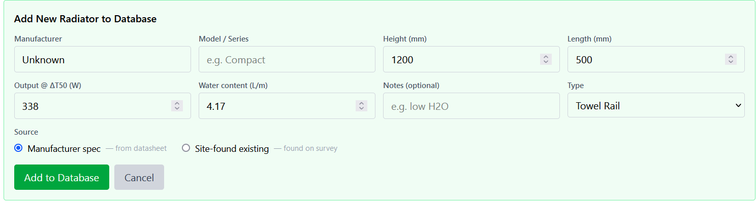

April 14Apr 14 One small bug I have found - when entering Rads everything works fine till you get to the l/m - it will only let you enter whole numbers (not number to two dec places) but once a whole number is entered you can increase or decrease it in steps of 0.01 - easily worked round but a little slow to get to the right value Edited April 14Apr 14 by marshian

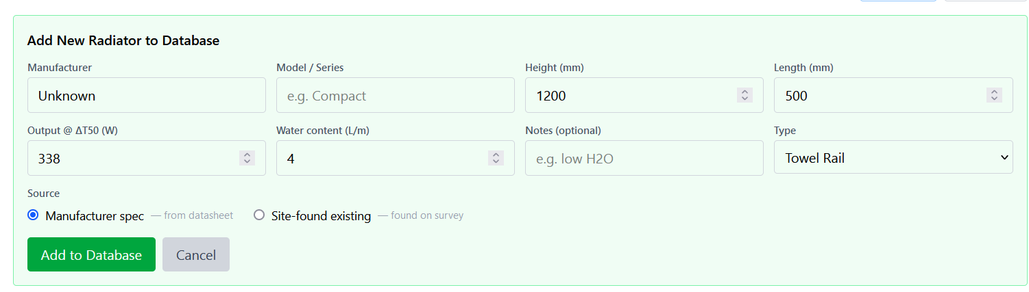

April 14Apr 14 Author 1 hour ago, marshian said: One small bug I have found - when entering Rads everything works fine till you get to the l/m - it will only let you enter whole numbers (not number to two dec places) but once a whole number is entered you can increase or decrease it in steps of 0.01 - easily worked round but a little slow to get to the right value Hmm interesting. The card you should be seeing looks like this: I wonder whether you have the older version of the app from before I sorted the radiator saving issue locally. Can you close your browser and/or do a hard refresh? On both my browsers - Chromium and Firefox, decimal entry in the form I have is fine from keyboard. and I have the add & select button rather than add to database. Would be interesting to see what you get following full refresh. Ah, no sorry! You're in the Radiator Library editor on the multi project beta! So the card is correct. Inputs on both my browsers work fine for decimals on water content. What browser are you using? Edited April 14Apr 14 by SimonD
