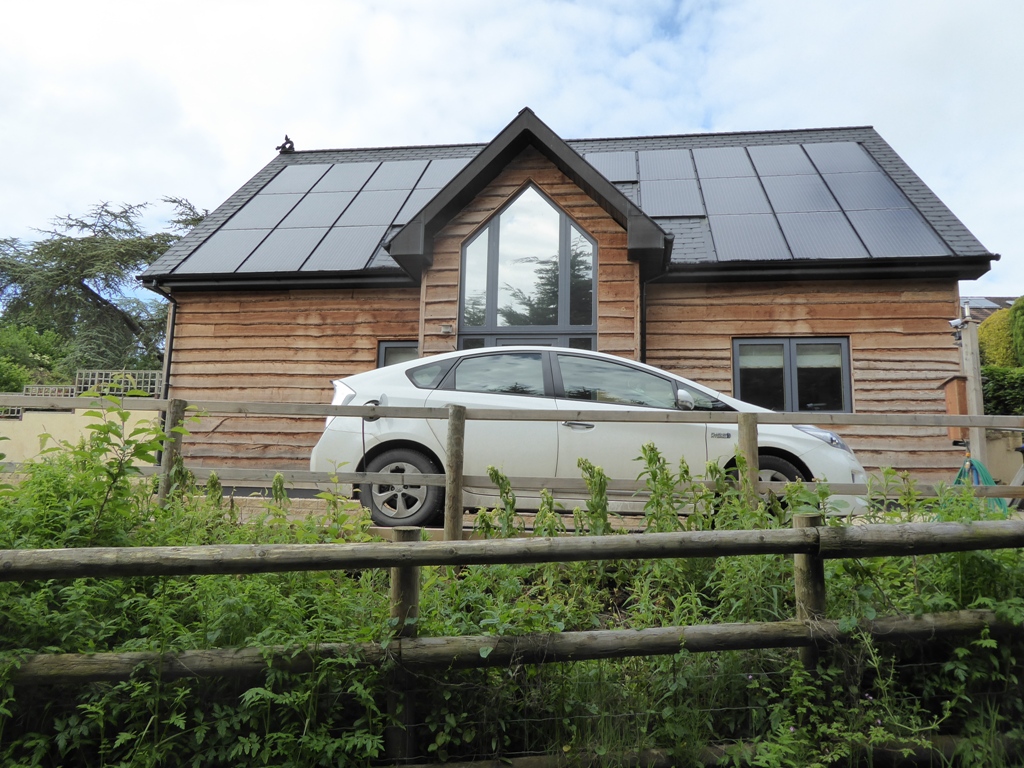

Jeremy Harris Posted February 7, 2018 Share Posted February 7, 2018 12 hours ago, Fredd said: fixing. the rails that hold them run horizontal across roof joists. to do it other way you would need more rails and the load would not be spread over the roof. on new build they are inset into the roof and go into the same tray as a velux window uses between the joists. No room to do them the other way. Not true. All the in roof systems we looked at allowed either portrait or landscape fitting, you just choose which you want. Mixing a matching isn't easy, so best to stick to one orientation, IMHO. We used the GSE integration system, in portrait mode: A house in the next village to me has just had the same in-roof GSE system fitted to a barn with the panels all in landscape orientation. From what I recall when we were looking, the other major in-roof manufacturer, Easy Roof (near identical to the GSE system) also allowed landscape orientation. Link to comment Share on other sites More sharing options...

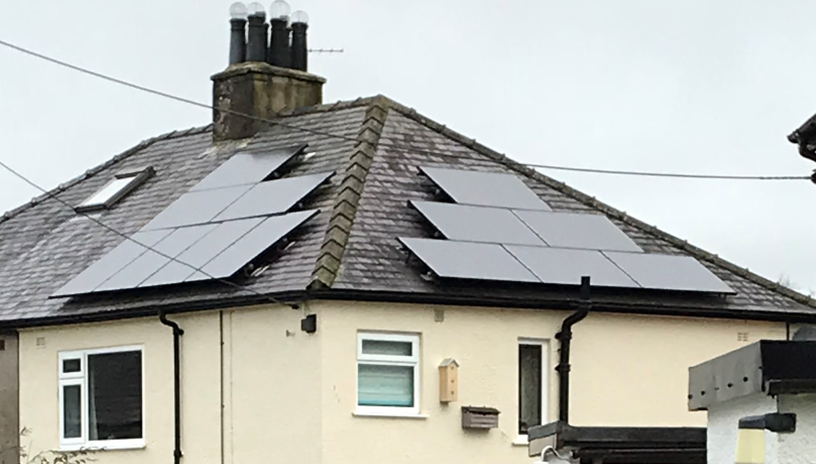

le-cerveau Posted February 11, 2018 Share Posted February 11, 2018 I was walking around today and noticed this roof: Panels in both orientations, even mixed on one face! Obviously trying to maximise the number of panels. Link to comment Share on other sites More sharing options...
SteamyTea Posted February 11, 2018 Share Posted February 11, 2018 1 hour ago, le-cerveau said: Panels in both orientations, even mixed on one face! Obviously trying to maximise the number of panels. Get lots like that down here, they have the same stupid roof shape. Someone used to make triangular modules, but they were not cost effective at all. Link to comment Share on other sites More sharing options...
