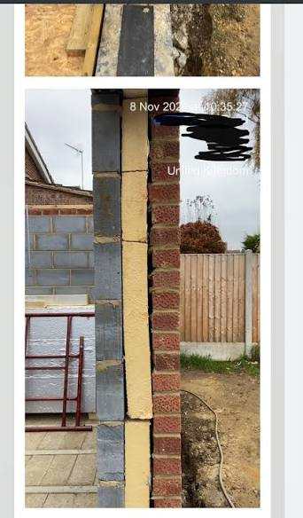

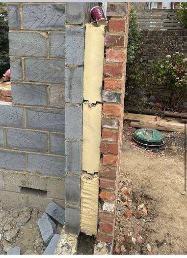

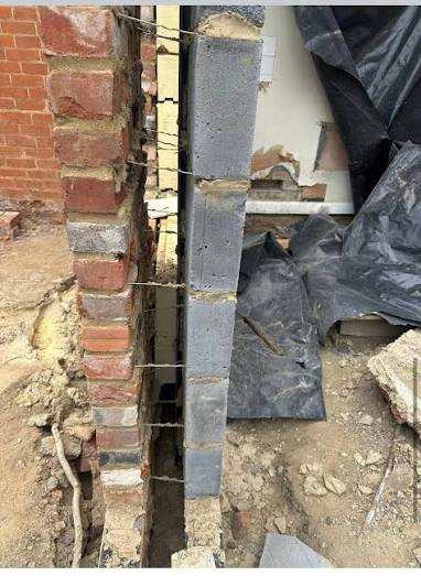

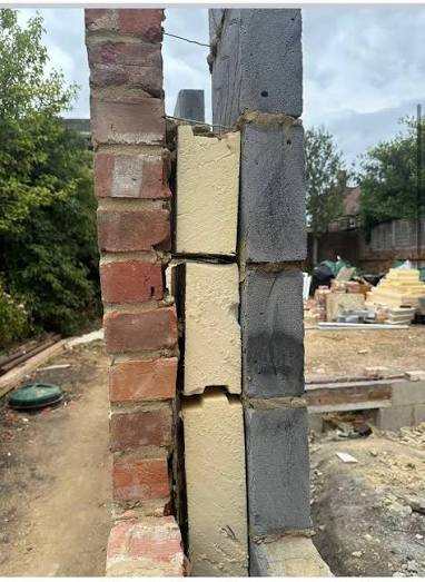

Iceverge Posted 1 hour ago Posted 1 hour ago Mineral wool batts. Absolutely not put boards. They're next to impossible to install properly in the real world
Andeh Posted 32 minutes ago Posted 32 minutes ago 1 hour ago, Mr Punter said: Dritherm 32 cavity slabs. This!
