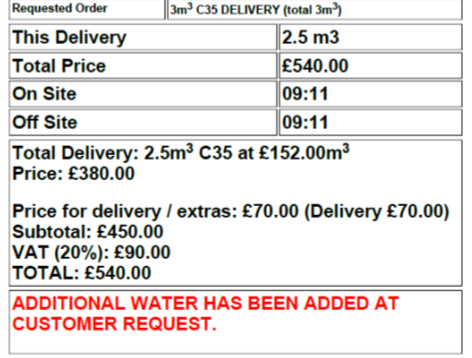

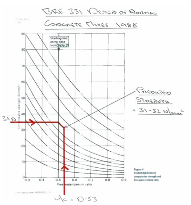

saveasteading Posted 4 hours ago Posted 4 hours ago Just now, Oz07 said: reckon they get told to because the mixes aren't upto spec. Valid theory. It certainly reduces their risk for any future problem. In reality, a lot of builders ask for extra water because it suits them and they don't know/ care that too much water is wrong. 1
