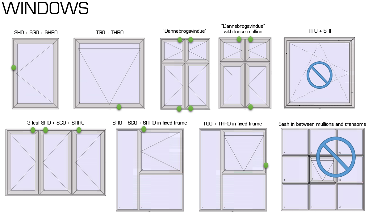

March 23Mar 23 Anyone found a nice solution to this, preferably hard-wired? By 'nice', I mean not too ugly and a thought out install into the window/door frame... I should say that I'm planning on external blinds and would like them to be smart enough to not come down when outward opening windows/doors are open. Edited March 23Mar 23 by Alan Ambrose

April 13Apr 13 Author Reporting back: Rationel has these as an option, but not, it seems for tilt-and-turn e.g.

June 8Jun 8 Author Yeah, OK I've learnt that while some windows suppliers are keen to claim they 'offer the open/close contact option' - when you ask them 'great, so where should I place my cable ducts then' they go all 'errr, nobody here knows, I'll have to check with the supplier'. So, my advice is to start this conversation v early.
June 9Jun 9 They don’t have a clue because they don’t check the details or enquire where the reed contacts come out of the frame. Most don’t even know where the reed contacts are located.

July 10Jul 10 Author Thanks. For anyone following along, it seems Rationel were somewhat unsure where there sensors were and said they couldn't do them on tilt-and-turn. 21Degrees claimed to be able to fit on anything and mostly knew where their sensors were.
