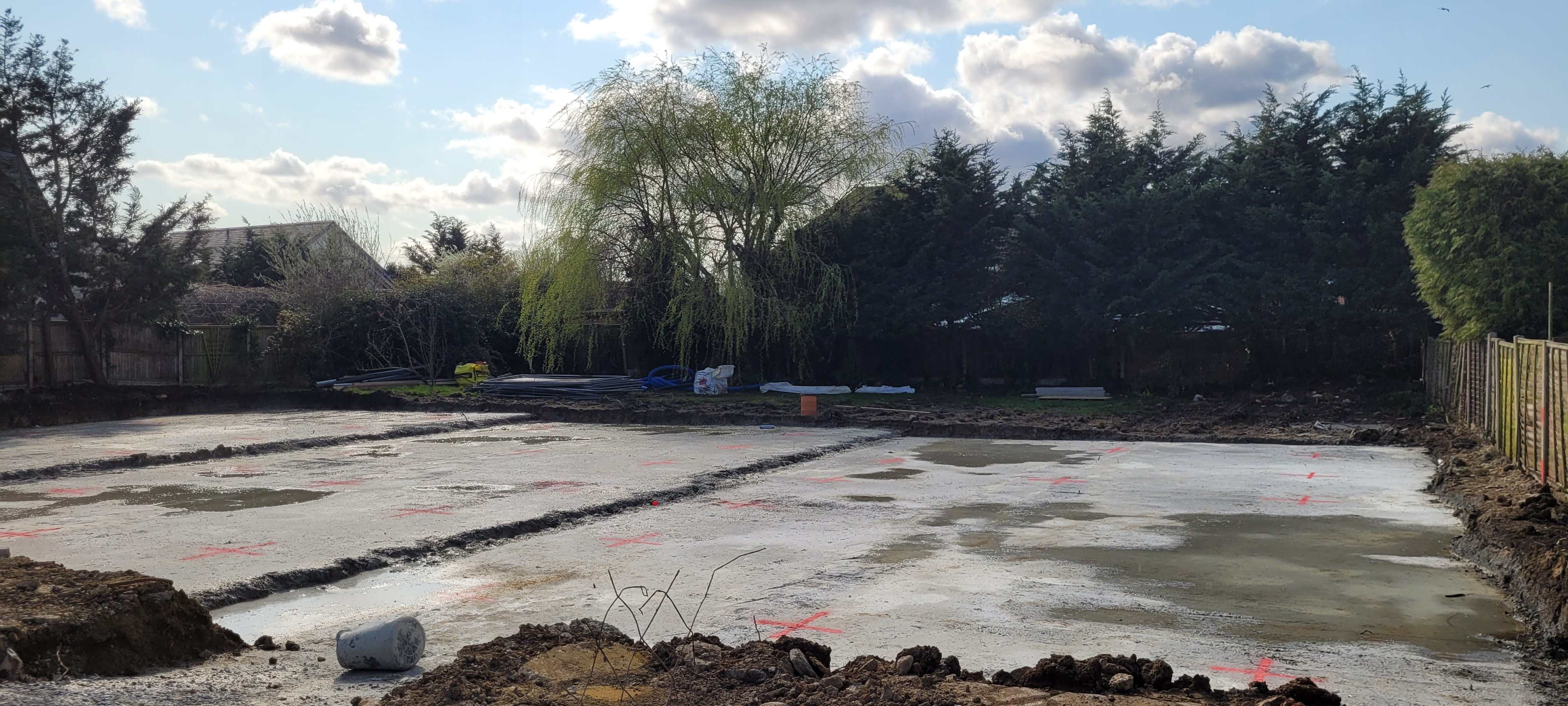

MikeSharp01 Posted March 15 Posted March 15 Round the corner from us they ar building 3 houses on a single plot. They have scrapped out three levels - the road rises past the plot, without any trenches just flat. On Thursday I noticed they were just pouring concrete onto these three flat levels, no services- nothing, you can see from the picture below what that looks like. Are they just short circuiting the passive slab build up to do without the N layers of type 1 and the pea shingle sub-base without any peripheral drainage or what what is going on top of these ponds of concrete?
Mr Punter Posted March 15 Posted March 15 Is it piling mats - concrete blinding to stabilise a piling rig?
MikeSharp01 Posted March 15 Author Posted March 15 7 hours ago, Mr Punter said: Is it piling mats - concrete blinding to stabilise a piling rig? the crosses might indicate that although they seem quite far apart for piles don't they? It will be interesting to see what happens next - I will report back.
Iceverge Posted March 15 Posted March 15 Very interesting. What was the sub grade like before they poured? Any mesh or rebar? Keep us posted
Iceverge Posted March 15 Posted March 15 Google tells me it may be blinding concrete. https://speedeck.uk/our-solutions/construction/working-platforms/ A thin layer of weak concrete in place of a thicker layer of compacted aggregate. The real foundations come later but it'll be a nice surface to work from and greatly reduces muck away and haulage etc...... Maybe @Gus Potter or @saveasteading could confirm?
Mr Punter Posted March 16 Posted March 16 14 hours ago, MikeSharp01 said: the crosses might indicate that although they seem quite far apart for piles don't they? It will be interesting to see what happens next - I will report back. They can often be at 4m centres.
Gus Potter Posted March 16 Posted March 16 23 hours ago, Iceverge said: The real foundations come later but it'll be a nice surface to work from and greatly reduces muck away and haulage etc. That looks a good theory.
MikeSharp01 Posted March 17 Author Posted March 17 On 15/03/2026 at 20:10, Iceverge said: Any mesh or rebar? Surface was flat clay - no rebar.
MikeSharp01 Posted March 17 Author Posted March 17 Yes it looks like pilling blinding as there is a pilling rig there today so good spot @Mr Punter. So they drill core drill through the blinding and then put the piles in all very neat and tidy - no mud other than what comes out of the hole! 2
