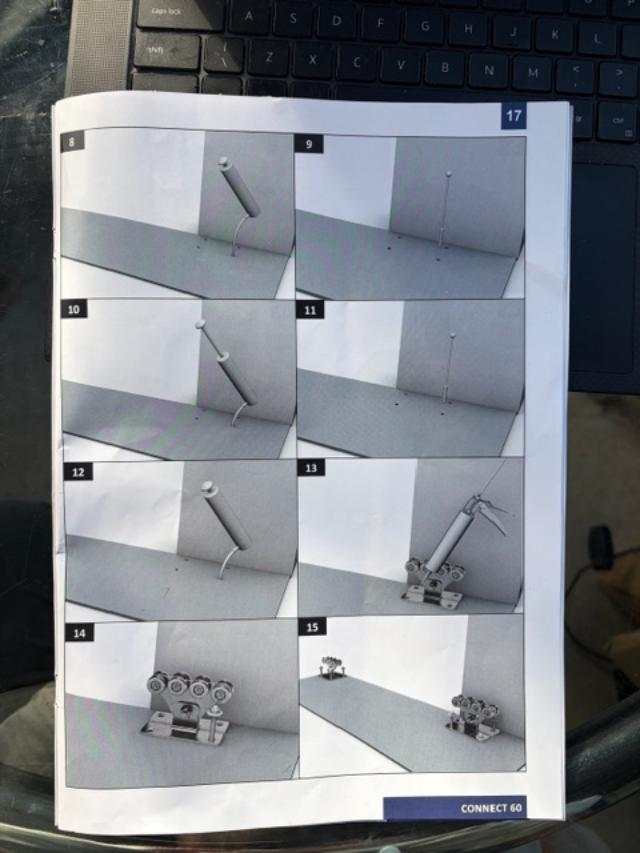

March 2Mar 2 Author Hi @Onoff @Conor too late now for the J bolts....the pad was placed ages ago. In any event here is the manual for the gate - it shows preparation for the fixings happening after the pad has gone in. No info on the diameter of bolt etc needed.
March 2Mar 2 Measure the holes in the rollers. Your stud should be snug but not tight. It is probably M12.
March 2Mar 2 58 minutes ago, markharro said: Hi @Onoff @Conor too late now for the J bolts....the pad was placed ages ago. In any event here is the manual for the gate - it shows preparation for the fixings happening after the pad has gone in. No info on the diameter of bolt etc needed. Look just like my rollers. 12mm resin anchors will be what you want.
March 2Mar 2 Author Thanks. I actually have a bit of 16mm threaded rod and it fits but maybe I want more wriggle room that I would get with 12mm to make sure I get both rollers in line? There is no guidance of the length of rod to bury in the concrete however? Also can anyone recommend a particular brand of resin? Do I need one of the tools shown to blown out the drill dust or will a vacuum do that?
March 2Mar 2 Use the fattest stud that will fit through the holes. Use the plate as a template. 100mm depth in the concrete should be fine and 2mm bigger diameter than the studs. Either a blow out tool or a hose to clean the holes.
March 2Mar 2 You need a fair bit of wiggle room in order to get everything lined up. And once you cast the bolts, you can't redo it. I used rawlplug resin. Edited March 2Mar 2 by Conor
