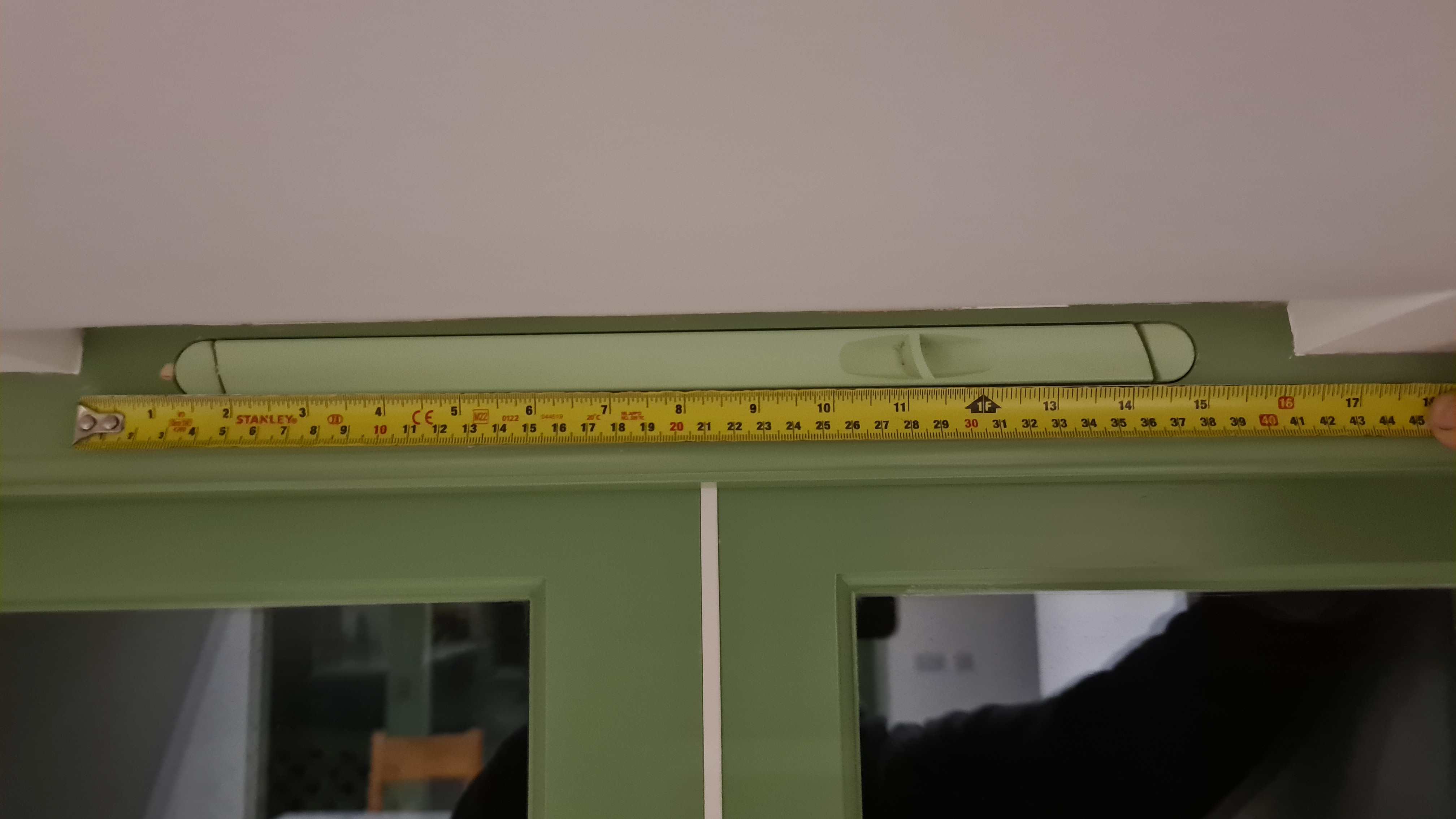

outside humidity has been between 70% and 100%
But when air is heated the dew point moves. We have a heated summer house it has dMEV fan, humidity inside hasn't been above 40% for that last month. We have bearly had a dry sunny day in the last month humidity outside closer to 100% most the time.

13 hours ago, JohnMo said:
Change the trickle vents to humidity activated one, but only in dry rooms (bedroom, living room etc).  Seal up any in wet rooms
https://www.ironmongerydirect.co.uk/product/trimvent-xr16-upvctimber-window-vent-recessed-352-x-16mm-white-906766
I think that these are the trickle vents that we have, I've looked and can't seem to find a  humidity controlled replacement, I think that they are the cheapest the Joinery company could be bothered to find.
Only source of heat is from body, cooking and showering.
There's your second issue, not just ventilation, no heating.
First hit in Google
https://www.bpdstore.co.uk/glidevale-energy-saver-humidity-sensitive-trickle-ventilator/p/182
