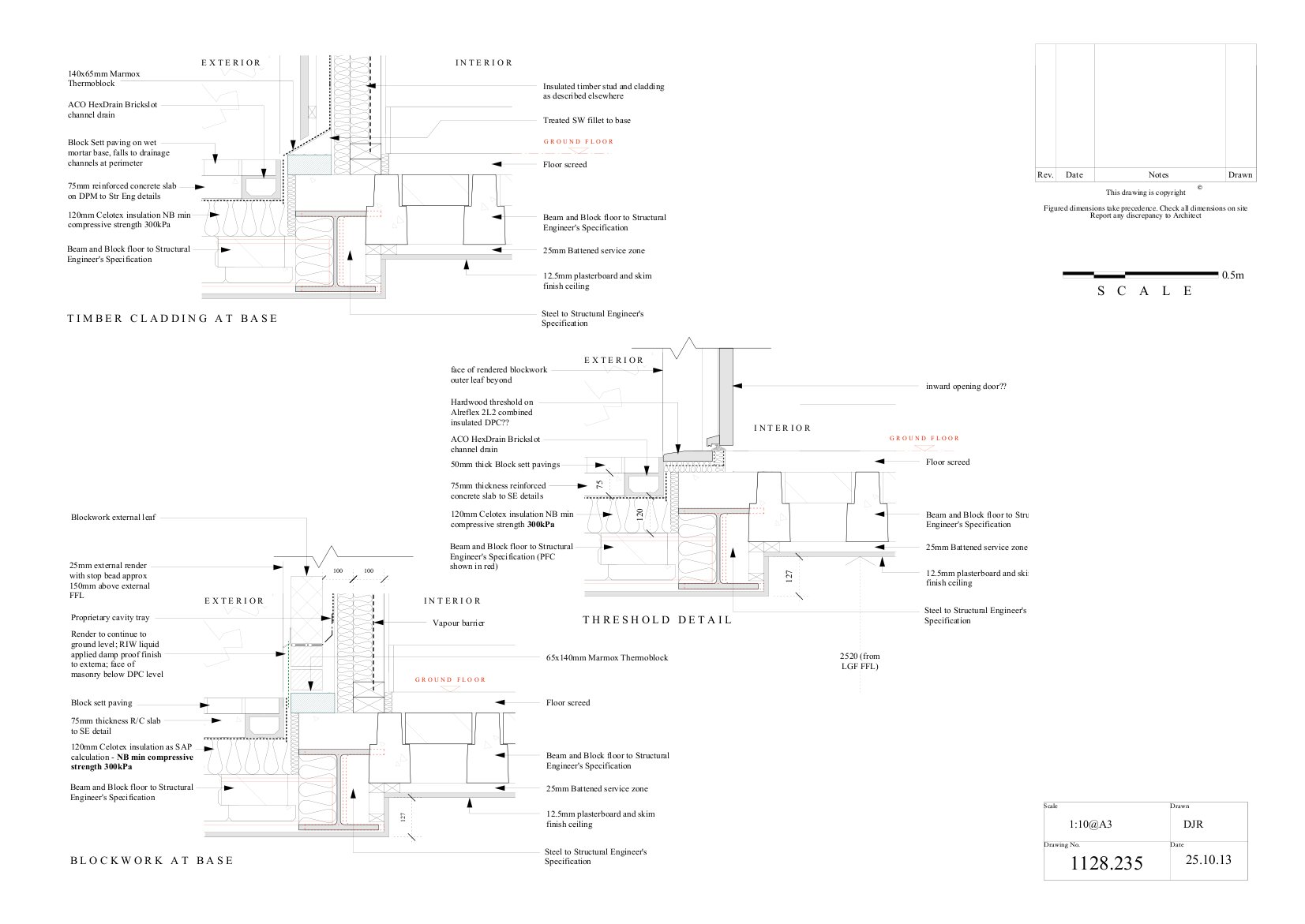

PeterW Posted January 24, 2018 Posted January 24, 2018 You need to know what they are being designed for - from your picture you want flush roof lights that are set into a solid concrete surface. The kerbs for this are very different to the kerbs for those set onto a timber roof with a membrane and potentially something like a green roof around them. Detail is the key here as done wrong, they will leak !!! Can you post a section of the buildup of the roof around the roof light from the architects spec and at least with that you have a chance to get some informed decisions.
Pocster Posted January 24, 2018 Author Posted January 24, 2018 (edited) 13 minutes ago, PeterW said: You need to know what they are being designed for - from your picture you want flush roof lights that are set into a solid concrete surface. The kerbs for this are very different to the kerbs for those set onto a timber roof with a membrane and potentially something like a green roof around them. Detail is the key here as done wrong, they will leak !!! Can you post a section of the buildup of the roof around the roof light from the architects spec and at least with that you have a chance to get some informed decisions. Here's the only detail for the roof/drive. So the roof lights up stands must sit on the beam & block floor ( suspect I will need to build this up with blocks to get the height) the roof lights cant be driven on so foot traffic only ! Edited January 24, 2018 by pocster
Pocster Posted February 1, 2018 Author Posted February 1, 2018 Right!, Been looking into this more!. Certainly not paying nearly 1K for 4 up stands! They do seem simple enough to build. My plan, (I need to gain maybe 25cm). Is to put concrete blocks around the opening then make wooden 'wedges' to gain the slope. Wedges can be 'open' so insulation can be inserted. Ply on both sides to hold insulation in place. Also (as this is a driveway i.e. with chipping for driveway blocks) ; insulation outside around the upstand to increase u but also to protect EDPM from chipping. Internally insulated plasterboard up to glass. Hence why a good few companies don't sell up stands (I guess no-one pays 200 quid for 4 bits of wood!)
