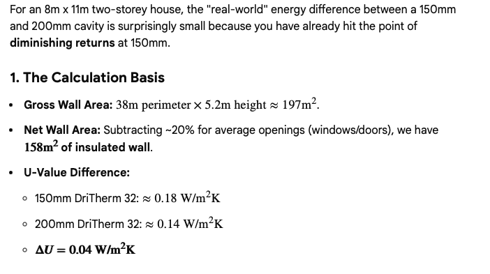

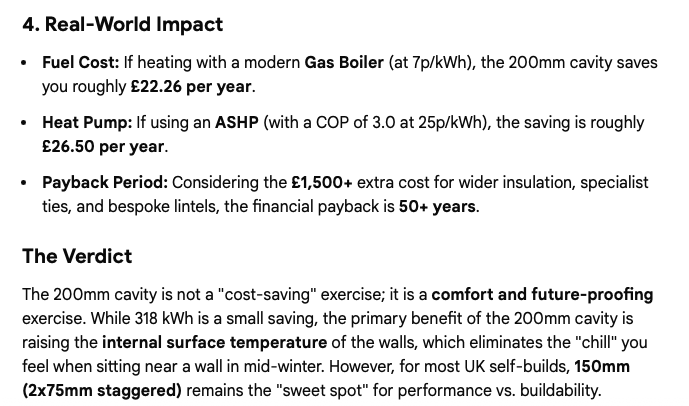

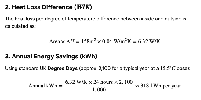

Was weighing up this choice recently leaning towards 200mm cavity. I've built last 2 houses at 150mm. I plumbed the numbers into Google AI just to see what it thought on a 8x11m box 2 storey house. If the info it gave me back is right then I'd probably stick at 150mm. I thought it wouldn't be too much dearer but I think things will add up. I do remember someone @Mr Punter? Saying it was best to internally insulate the additional 50mm to keep everything more standard, footing width, ties, closers, lintels etc. The energy savings just don't seem worth it 50+ year payback and if you are constrained on overall size of dwelling your losing 2 or 3% in net floorspace. Anyone else make this decision and why?

Your form factor is good, it's a rectangular box. So U value effect is different from a poor form factor (like our house).
I would look at a slight bigger scale than just the walls, so floor windows/doors and roof. Get a bigger picture.
Note: Passivhaus required U value changes with form factor.

Anyway forgetting windows for now because I'm just looking at whether its worth increasing insulation width. I don't think it is.
