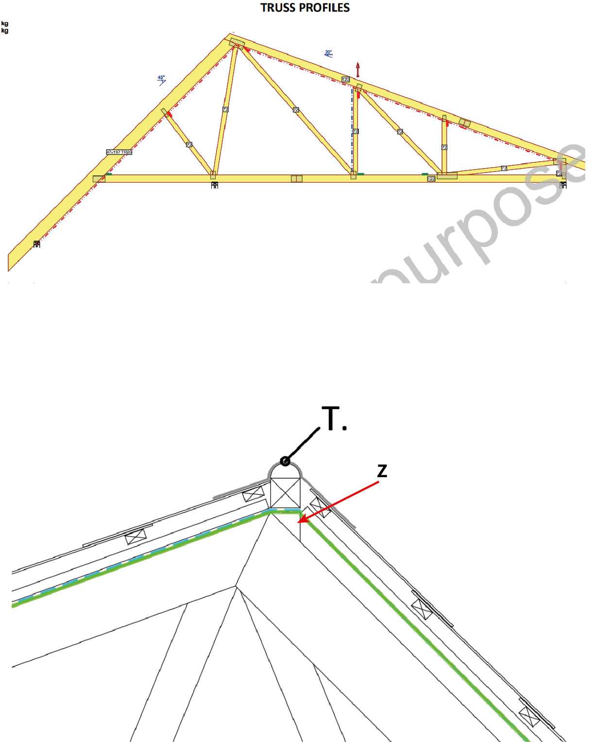

We are up to wall plate and having the Truss designed this week for an asysmetrical roof profile (see drawing attached). The architech has come up with a neat solution to allow for a flat ridge with what looks like a triangular section (Z) for support. The Truss designer hasn't included it, and the roof installer says its for the tiler/roofer to sort out. Can any one help unpick this? What is Z? Why isn't it provided for by the Truss supplier? Who has responsiblity for organising the timber for Z? Your wisdom would be very welcome, many thanks.

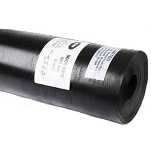

Construction: brick and block 200mm cavity. We have not long installed the first floor joists but being advised to use a different cavity tray above the first floor windows. We have installed Catnic Thermally Broken Lintels and used RIW Sheetseal 9000 at 600mm wide to form the cavity trays on the groundf floor windows . These were a snug fit over the lintels. However, for the first floor we have been advised that it’s best not to use the Sheetseal 9000 because of the 'reduced weight bearing' and look instead for a high bond DPC. So now trying to source a good quality flexible DPC 600mm wide. Would appreciate any suggestions. The alternative is to consider pre-formed cavity trays if I can souce them for a cavity this size. Many thanks
