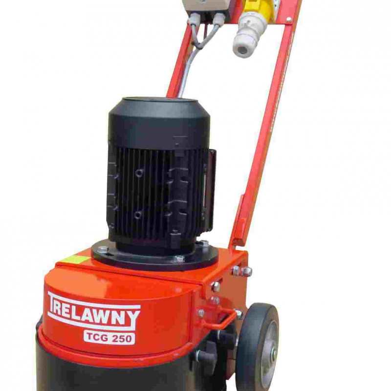

I have a concrete floor for a garage that was poured late last year, it unfortunately had some rain on it before it was set so the top surface is not great. Probably be quite dusty when I finally get a roof over it and it eventually gets a chance to dry out.
I'm wondering if it's worth trying to grind back, my local hire place has this sort of machine:
Is this the right approach to improving it? Or something else? Or maybe I'm over thinking it for a garage and should just live with it.

You want one with diamond discs. That looks like one with the "scabbling blocks". Useless for what you need.
The ones with diamond discs seem rather hard to hire.
How big an area. I did a double garage sized area of very rough tamped concrete with a Hilti hand held one. Bloody hard work mind!

They also have this, which has 250mm dia diamond disc.
It's a big enough area, about 70m2. I wouldn't fancy going at it with anything handheld!
Don't underestimate the potential costs of using one of these. The wear charges on diamond discs is eye-watering.
When we did our spalled garage floor (about 45 m2) with something like this a few years ago, I think the wear charge would have been hundreds of quid on top of the hire (we got it through my wife's family's plant hire company, so thankfully we didn't have to cover it).
Admittedly the slab had been there for several years, so under the spalling the concrete was very hard, and I had to take quite a lot off to get it even roughly flat, but just be aware of the potential costs.
An alternative would be to scrabble with something like your first machine to remove anything loose, then a primer to stabilise, followed by a thin layer of epoxy floor covering to smooth over any residual roughness.
