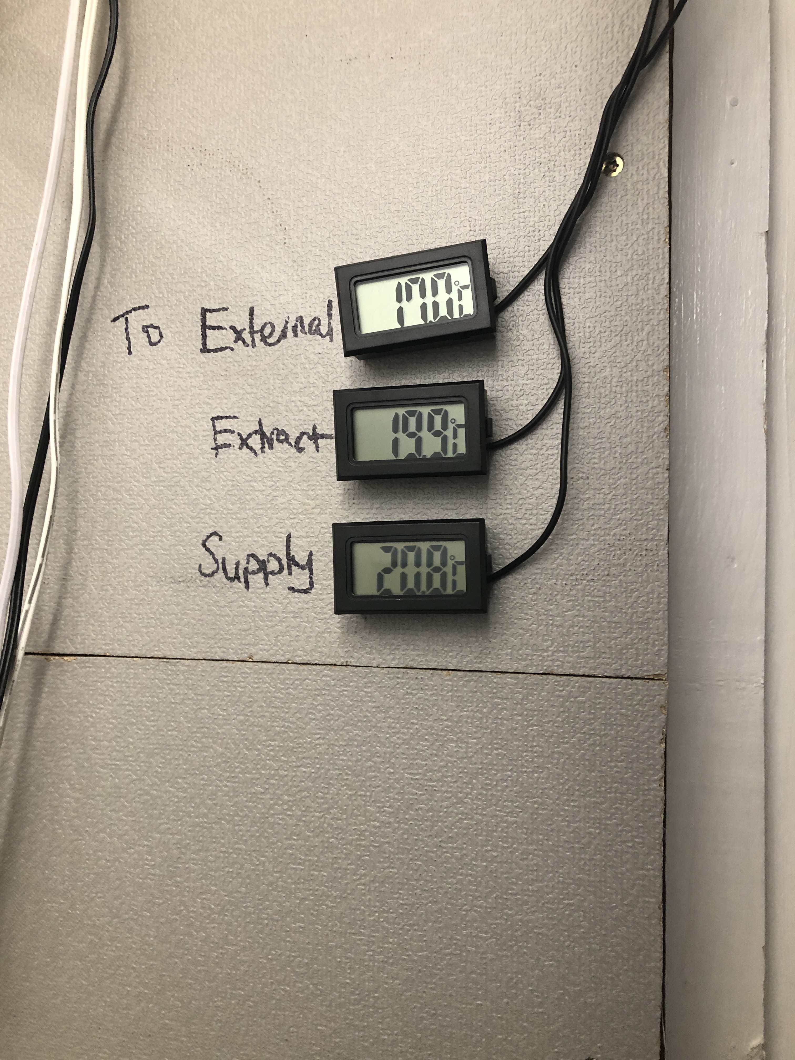

Couple of years back i bought some cheap temperature sensors off amazon just out of curiousity, as although the unit has its own temperature readings, they don’t include the temperature going back into the property, only extract, inlet and exhaust.
Now I’m sure for a long time everything seemed feasible temperature wise, the extract was around the temperature of the bungalow, and the supply was slightly lower as you’d expect, some small losses.
Now it’s constantly higher than the extract, which is obviously not possible, there is no magic heater or anything in the ducting. You’re probably thinking, just cheap sensors that aren’t reading right, i thought so too, so i swapped the supply and extract ones round and the ‘bad’ reading followed (and yes I relocated them on the wall correctly too! lol).

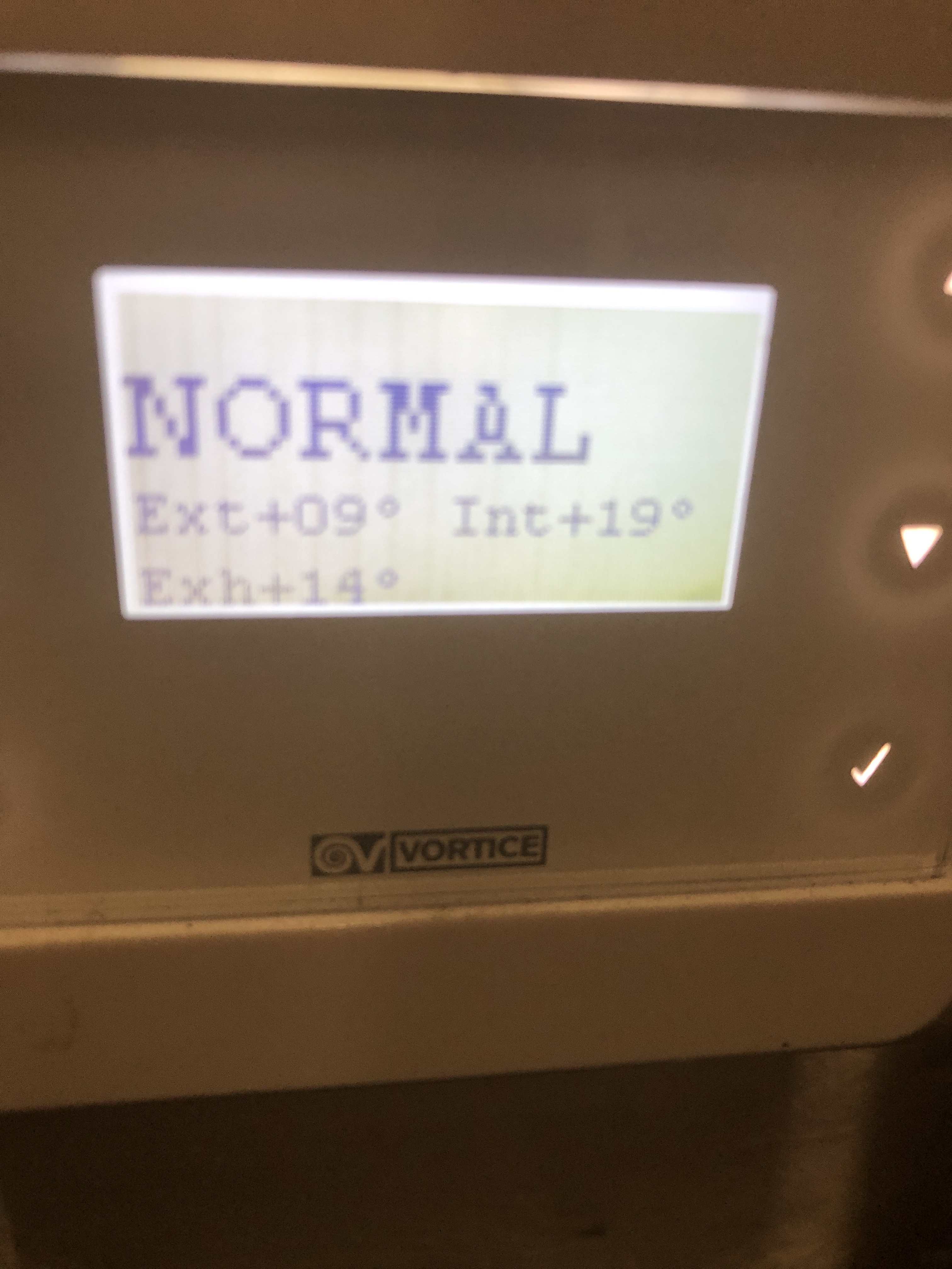

Yesterday I had the unit all apart and checked everything, cleaned the G3 filter which is has on its extract side, and washed the heat exchanger out (though to be honest, aside from dust on the filter, it all looks like brand new in there), and it this point i moved the sensor which I had on the intake, to the exhaust just to see what temperature it showed compared with the units own sensors, and I was surprised to see it showing 17C, with an outside temp of 9C currently.
Now the units own sensors shows 14C as the exhaust temp, and the sensors are literally next to each other, but could just be the poor quality sensors again?
My main concern is the fact the supply seems to be warmer than the extract?! The air coming out of the ceiling valves using an IR thermometer shows between 18.8 and 19.5C depending on how far the pipe run is, which seems feasible.

No heaters in situ and like I said I’ve swapped the thermometers around and the error always stays the same, yes they are defo labelled correctly, have checked a million times myself months.
They are only cheap thermometers agreed, so how about the readings from the unit itself, do they seem right? I’ve just nothing to compare against and this is the only MVHR I’ve ever owned.

For clarification for my unit:
Ext - External - Temperature of the fresh air coming into the system
Exh - Exhaust - Temperature of the stale air once it has passed through the heat exchanger
Int - Internal - Temperature of the stale air coming into the system before heat exchanger
My unit doesn't have a supply temperature sensor, which is why i added some of my own, but they were only cheapy

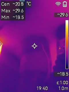

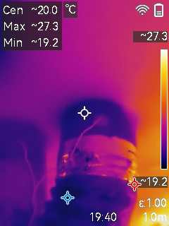

So after around a week with the new fan speeds, it’s got the exhaust value down a couple of degrees without changing the supply temperature so that’s good, but the supply is still warmer than the extract.
decided to get the thermal camera on it and it gives a similar reading
extract pipe
supply pipe
observe the centre value as this was pointed at the plastic PVC pipe which is same on both and not reflective
