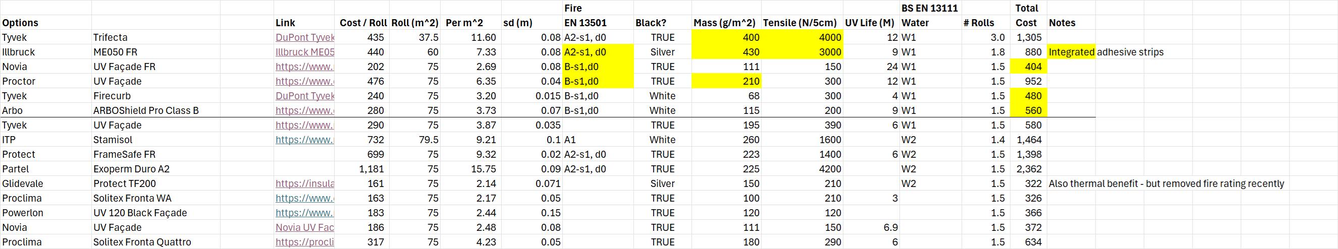

Alan Ambrose Posted February 19 Author Posted February 19 As usual, I've got into this in an 'over-enthusiastic' manner... I see some membranes with fire ratings of A1, A2 (OK for high rises), B1 (does burn a bit) or none (you can bet it burns). I see some with UV ratings of from 3 to 12 months (or none at all). I see water penetration of W1 (just doesn't) and W2 (leaks a bit). Some at 2 quid / m^2, some 8x that. Question is: how much do we care? how much does BC care? I'm thinking all re clad timber frame, of course.
Nickfromwales Posted February 19 Posted February 19 2 hours ago, Alan Ambrose said: As usual, I've got into this in an 'over-enthusiastic' manner... I see some membranes with fire ratings of A1, A2 (OK for high rises), B1 (does burn a bit) or none (you can bet it burns). I see some with UV ratings of from 3 to 12 months (or none at all). I see water penetration of W1 (just doesn't) and W2 (leaks a bit). Some at 2 quid / m^2, some 8x that. Question is: how much do we care? how much does BC care? I'm thinking all re clad timber frame, of course. Cover the expensive membrane with cheap visqueen and dispose of it later. Zero UV getting through that. 1
Alan Ambrose Posted February 21 Author Posted February 21 Yeah, that's a good solution. Here's my OCD non-exhaustive mini-analysis for anyone that cares: I figure I want W1 & fire protection, so am inclined to use Illbruck ME050 FR. 1
