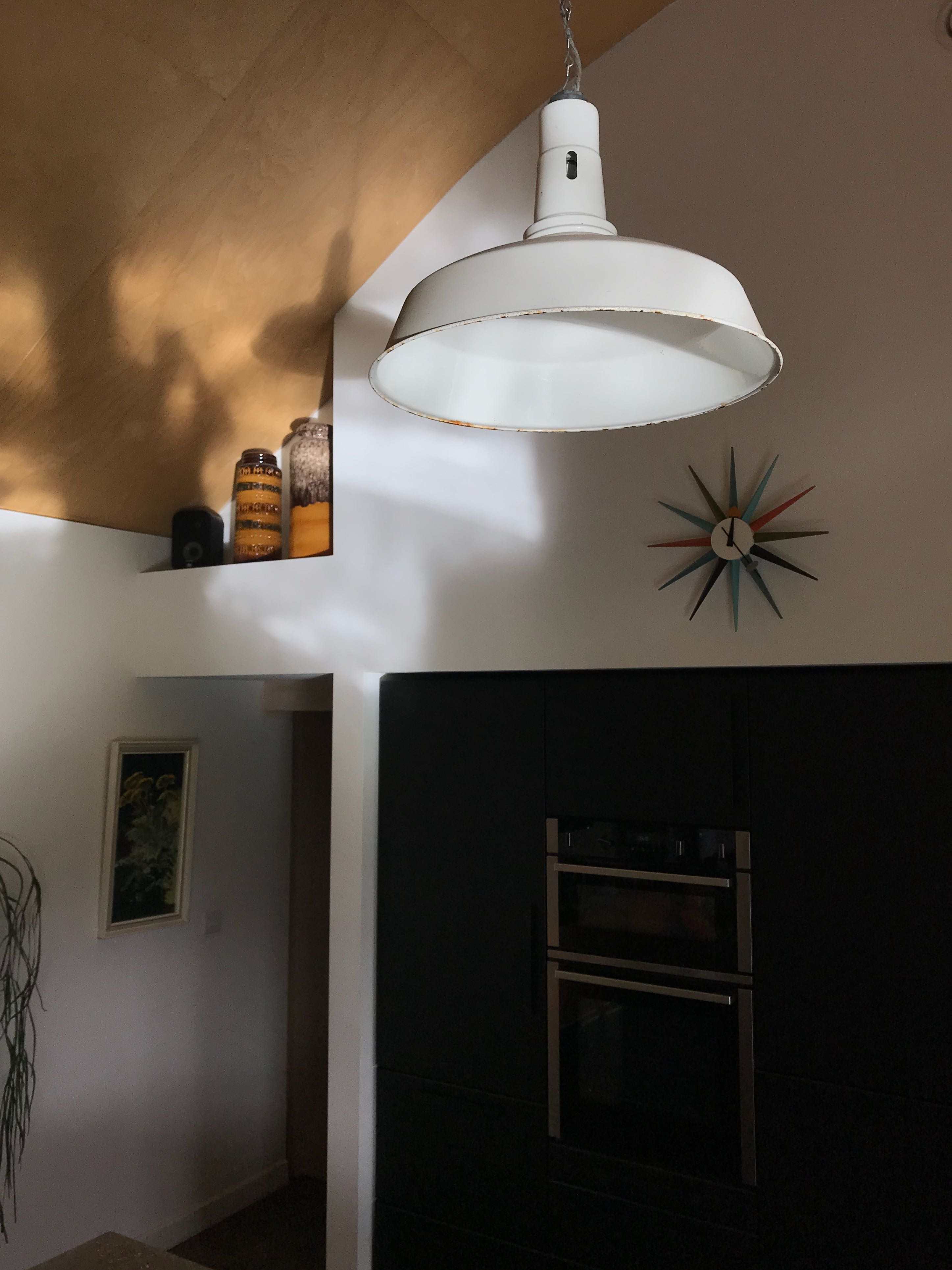

January 16Jan 16 We have 3 of these at 1800k each, plus 6 spots behind at 4000k (3 in background of picture) The 3 bulbs are adequate for us. I think 3000k strip LED would be fine

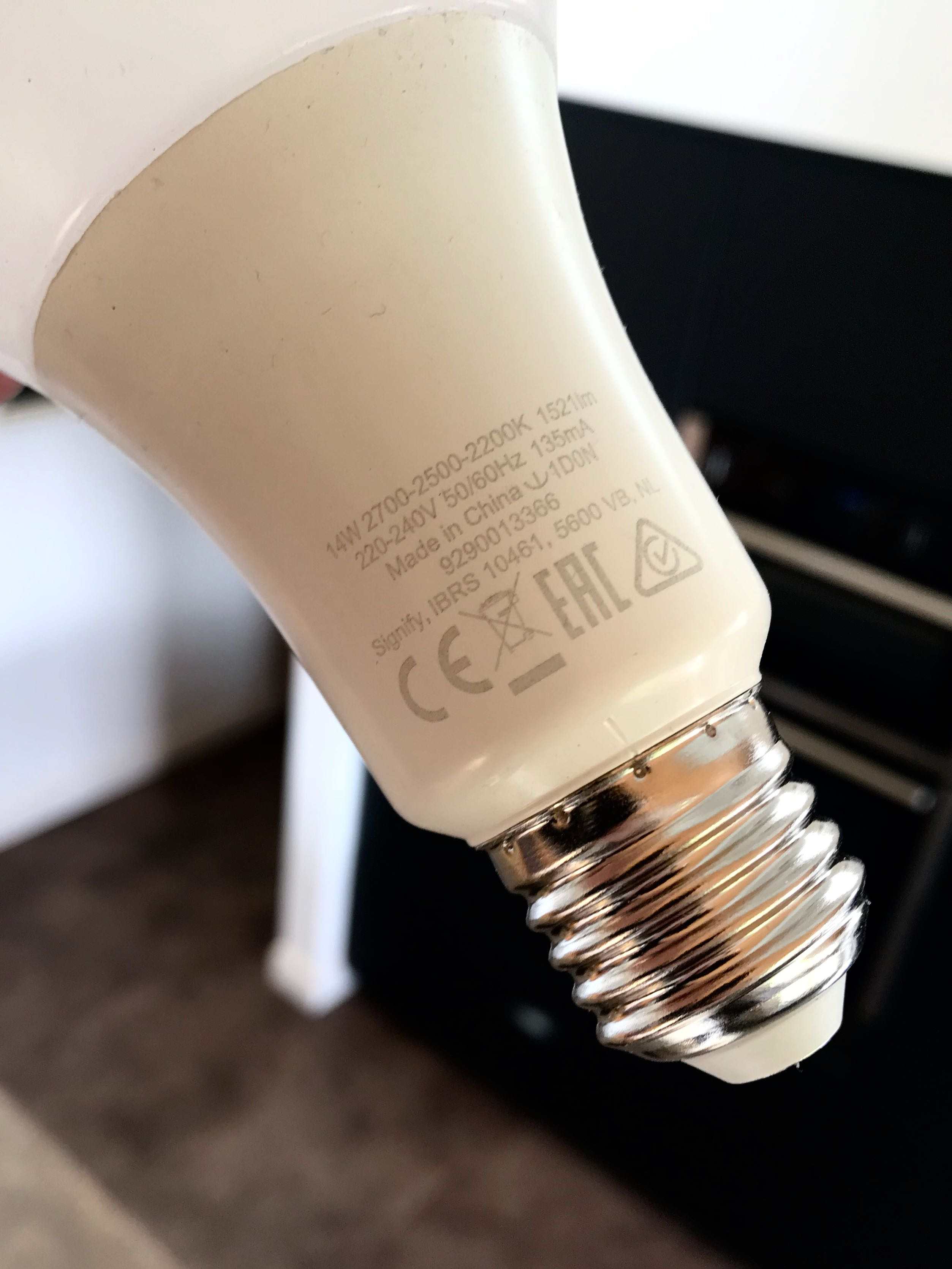

January 16Jan 16 We have a single pendants above the island and dining table, 4 floor lamps and 2 wall Anglepoise. Bit of chaos but it works for us. 3000K seems just right. Fitted with a Philips 14W 2700/2500/2200K which works off the wall switch. Can you find a LED with adjustable temperatures? Brightness is also a consideration. As @Mike consistency throughout the room if possible.

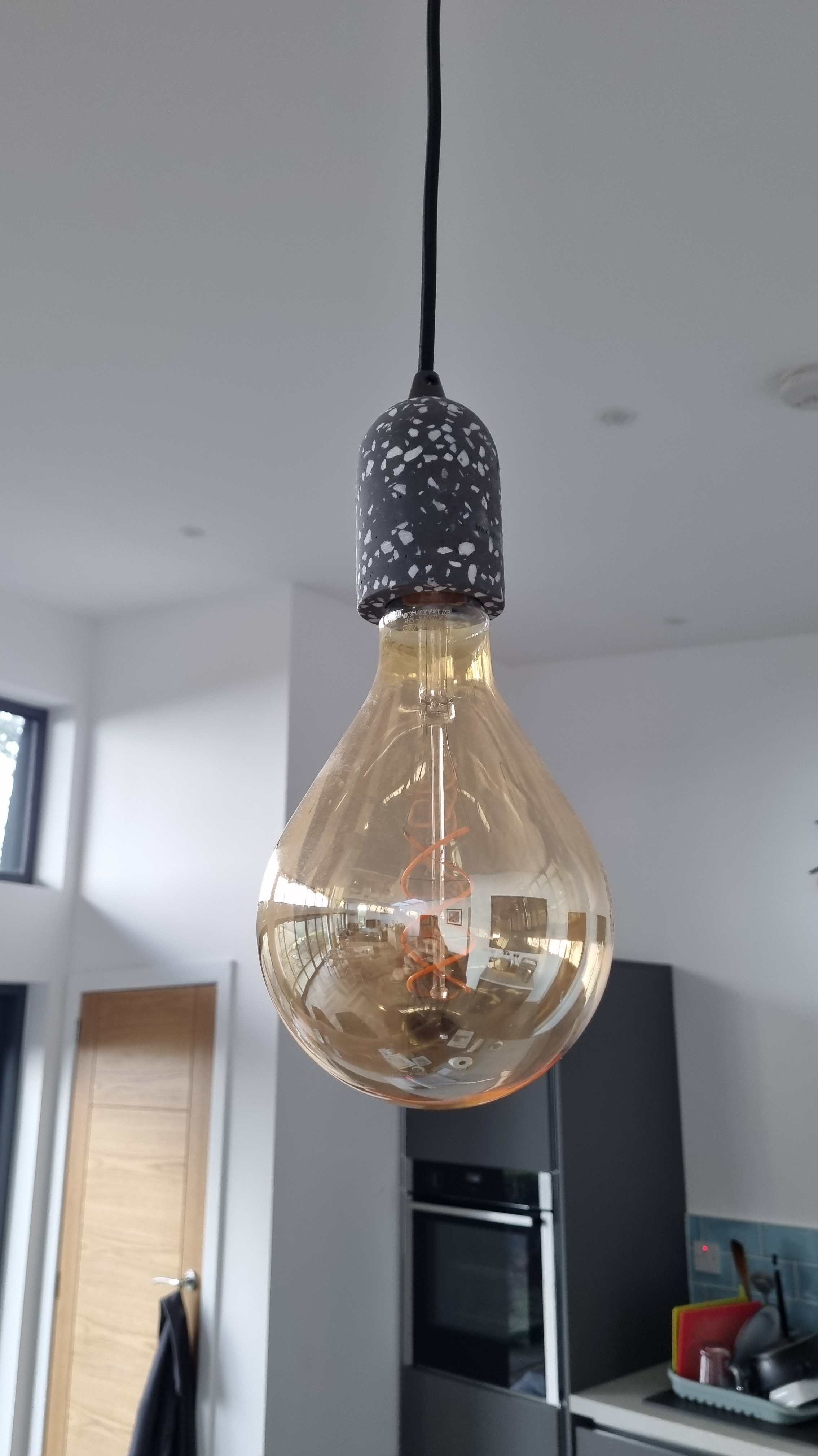

January 17Jan 17 We're really fussy about lighting and are often disappointed with what options are available. For our island we wanted a visible filament, good colour rendition (>90 CRI with decent R9 performance), ideally ST64 shape (but GLS if necessary) and dim-to-warm functionality as it is in a 'family room' that really does needs different lighting at different times of day/use. A lot of boxes to tick and I found a grand total of one option and that was the Philips Master Value series: (shown here at quite a low level hence more towards the 2200K end of the range) They took a bit of effort to drive with a Varilight Pro dimmer as they take a bit of a kick to reliably turn on at very low levels but with some help from Varilight got there in the end. That's a long way of saying 'warm white' in answer to your question, although I would say accurate colour rendition is just as important in a kitchen. Edited January 17Jan 17 by MJNewton
January 17Jan 17 We used Philips master value throughout. Warm white. Edited January 17Jan 17 by bmj1
