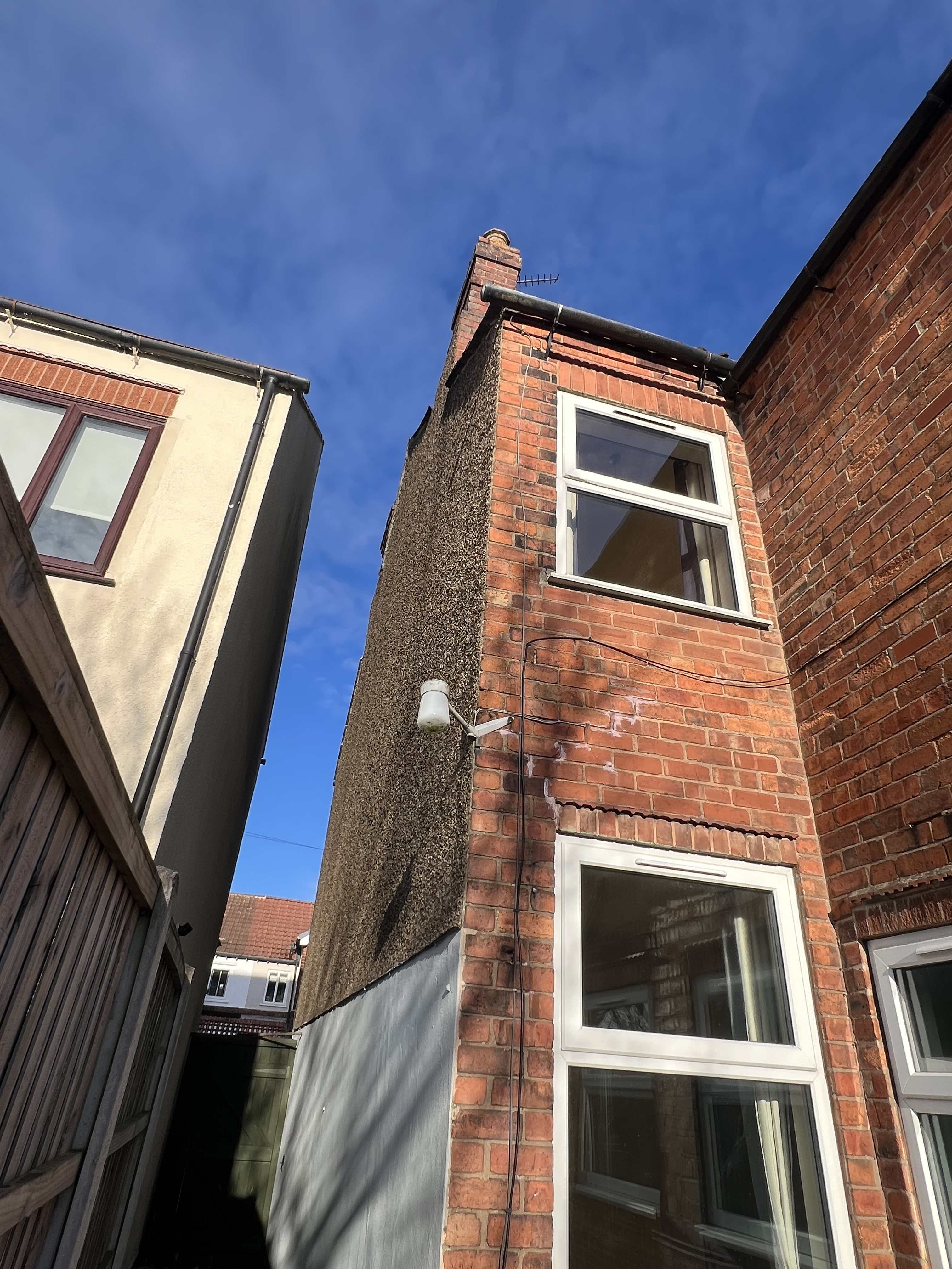

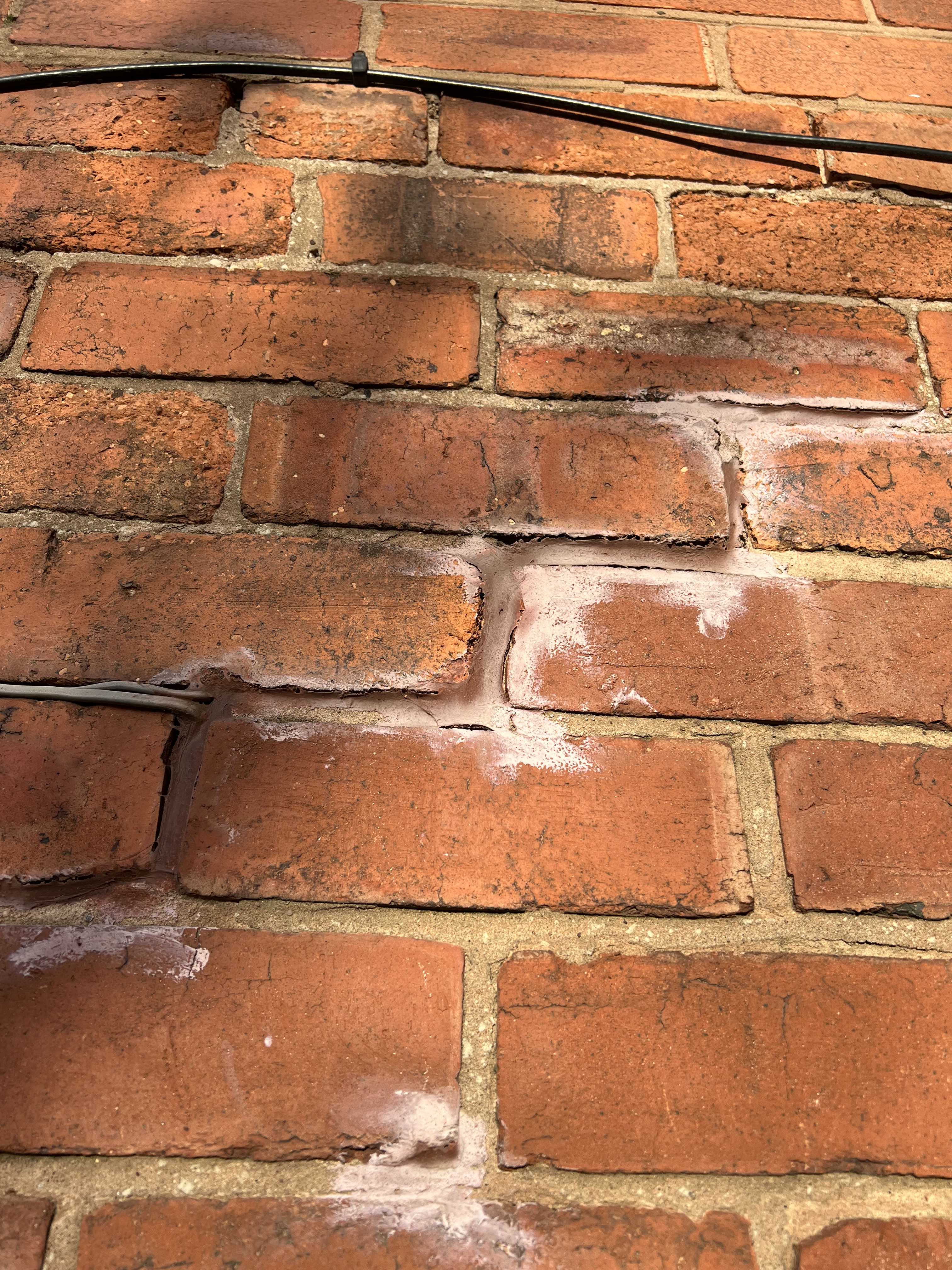

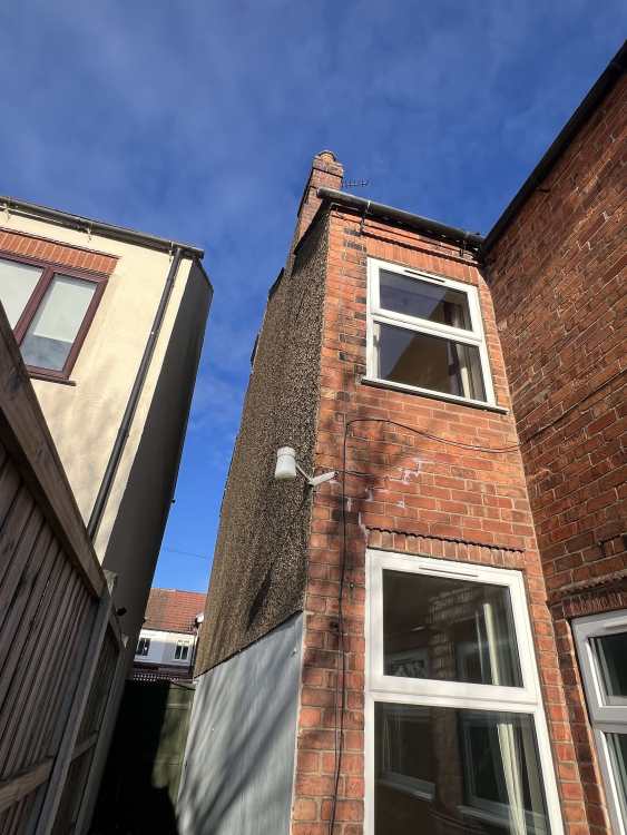

Whats the crack Posted January 15 Posted January 15 Was just wondering if I could ask if this crack is a concern. It seems to have been repaired with a relatively soft filler a bit similar to a test texture of mastic. i’ve been told it may be due to the house having had old wooden lentils that have now been replaced and filled use in packers which may have moved slightly? i’m not sure about the tiles on the roof either? Any help or guidance would be appreciated.

Alan Ambrose Posted January 15 Posted January 15 (edited) >>> old wooden lentils With gruel? People were a lot poorer in those days. Yeah it does look like it propagated from the window aperture and then died out doesn't it. You have steel lintels now? The fix looks a bit of a bodge. You could get someone up there on a ladder, clean it up and re-grout properly. Then see if it re-appears over the next few years. Edited January 15 by Alan Ambrose 1 1
Whats the crack Posted January 15 Author Posted January 15 Thanks for the info. It’s a new house purchase you see, but I didn’t want to buy it if there’s any subsidence or major structural issues. So I’m not too sure about the steel lentil. It sounds like it’s not a big concern at the minute then?
Nickfromwales Posted January 15 Posted January 15 Likely that the original windows were solid timber, maybe a hardwood, so when the windows were changed to UPVC the external face course of brickwork had a chance to drop slightly. Back in the day the windows would have gone in as the wall was going up, and they would have bricked to them / on top of them. A lot of bay windows fail after the original hardwood windows have been removed as useless fitters don’t realise they were sharing the load through the frames / mullions. Not a worry, very typical, just needs pointing again to do the job a bit better. 1

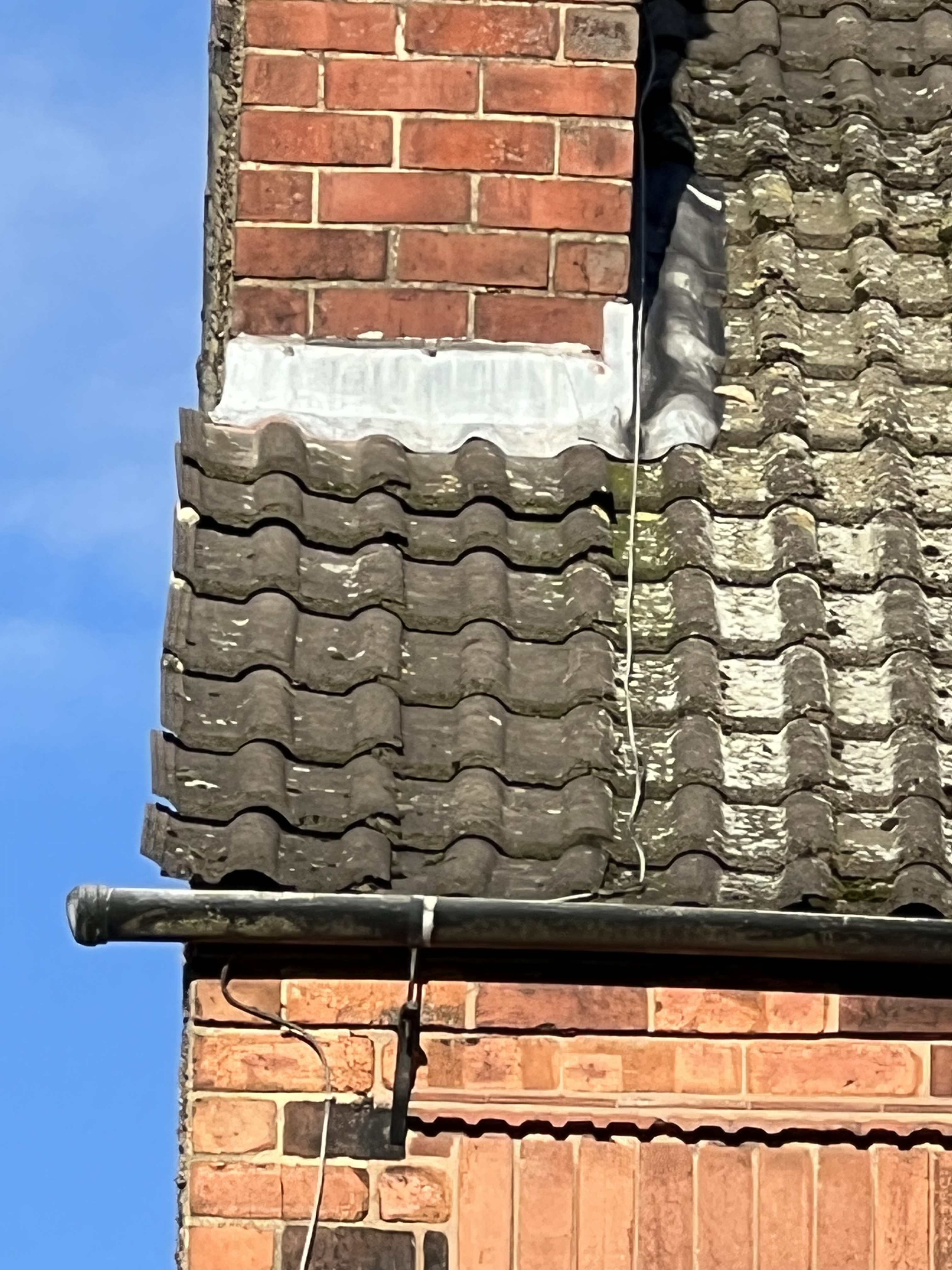

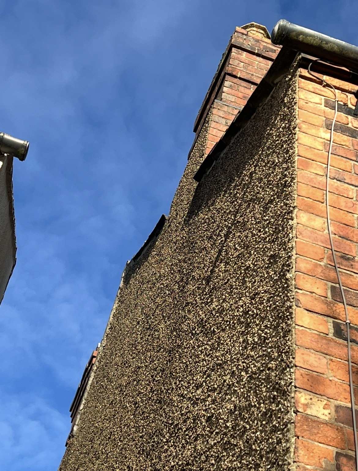

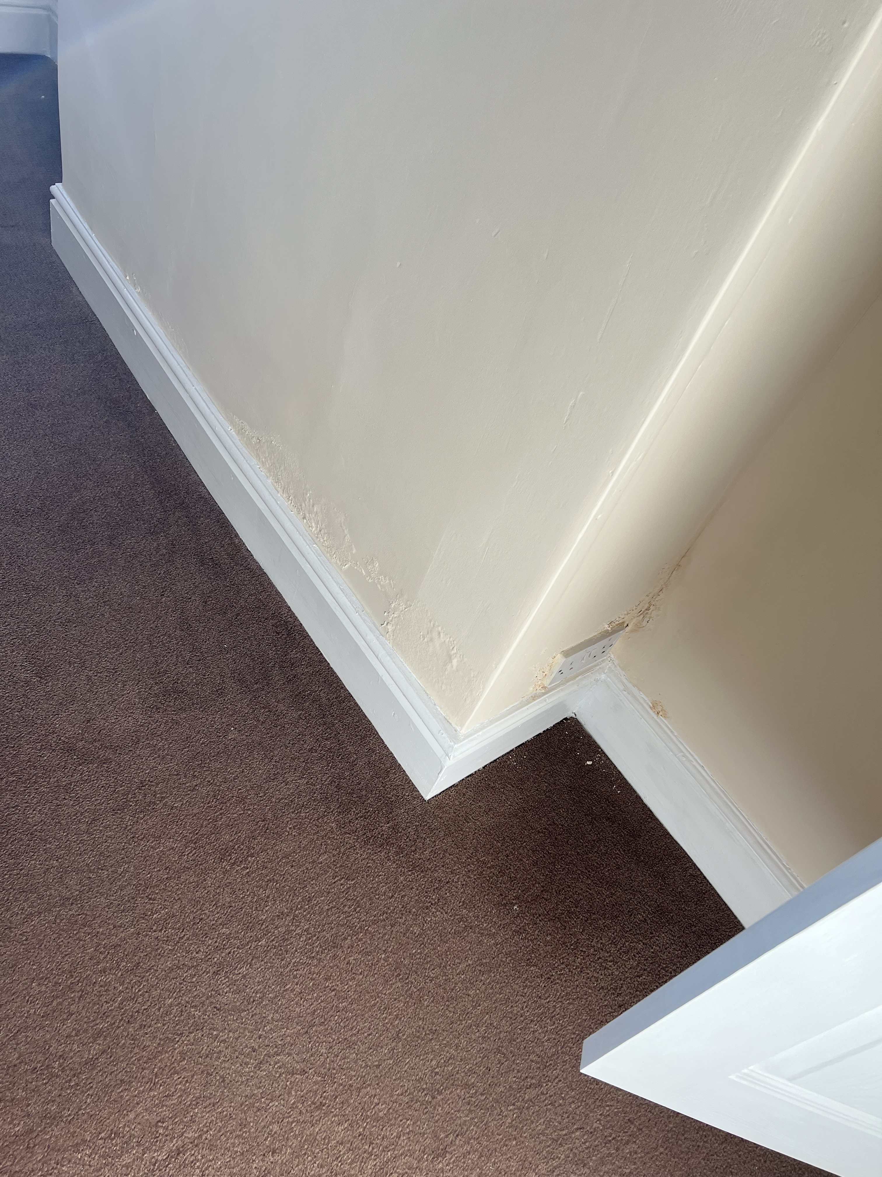

Whats the crack Posted January 15 Author Posted January 15 Thanks guys you’ve put my mind at rest. Any thoughts on the roof? I’ve been told that the tiles should’ve been cut flush to the wall, there is some damp on the chimney breast in the house. But there’s no ventilation on it either. I’m thinking it could be a quick fix of putting event on the chimney breast and having the tiles cut and levelled properly?
