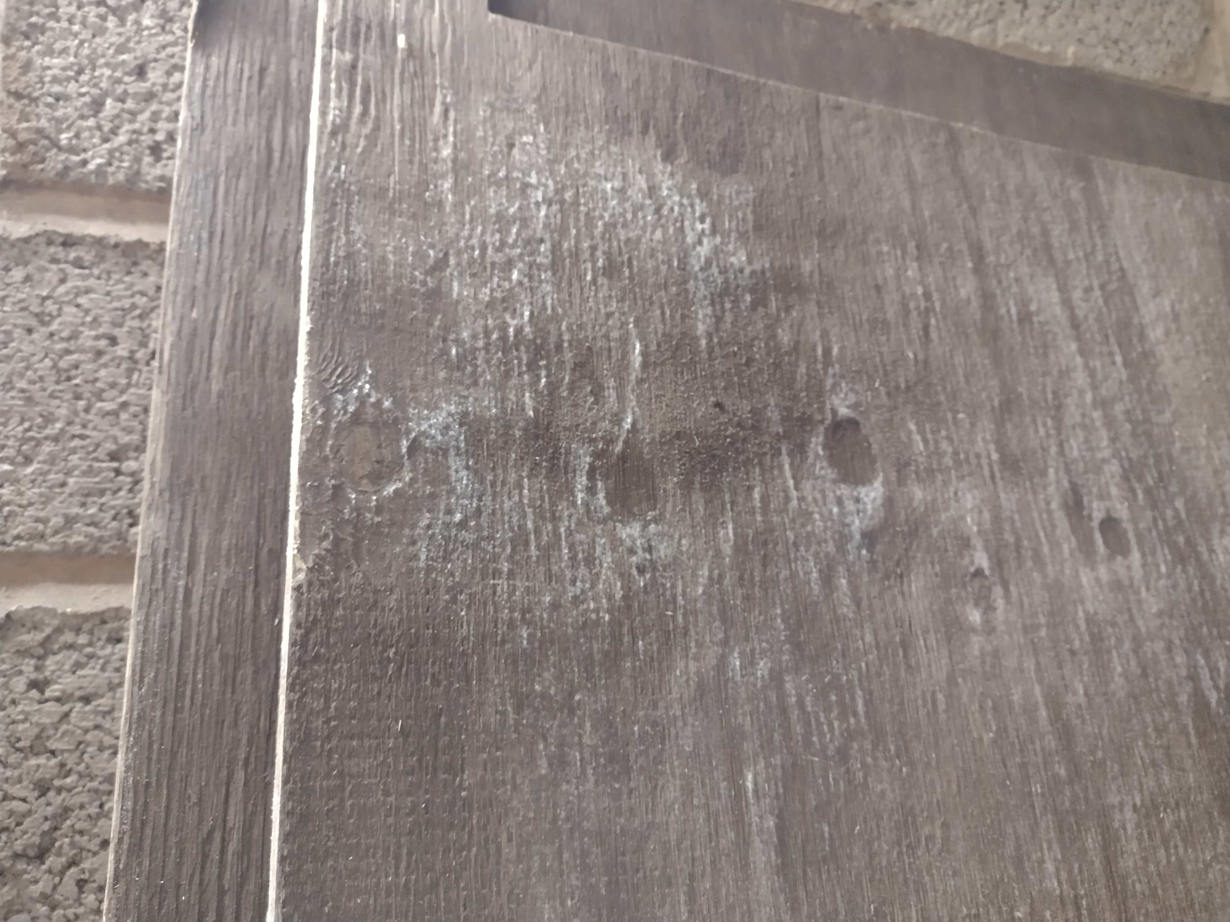

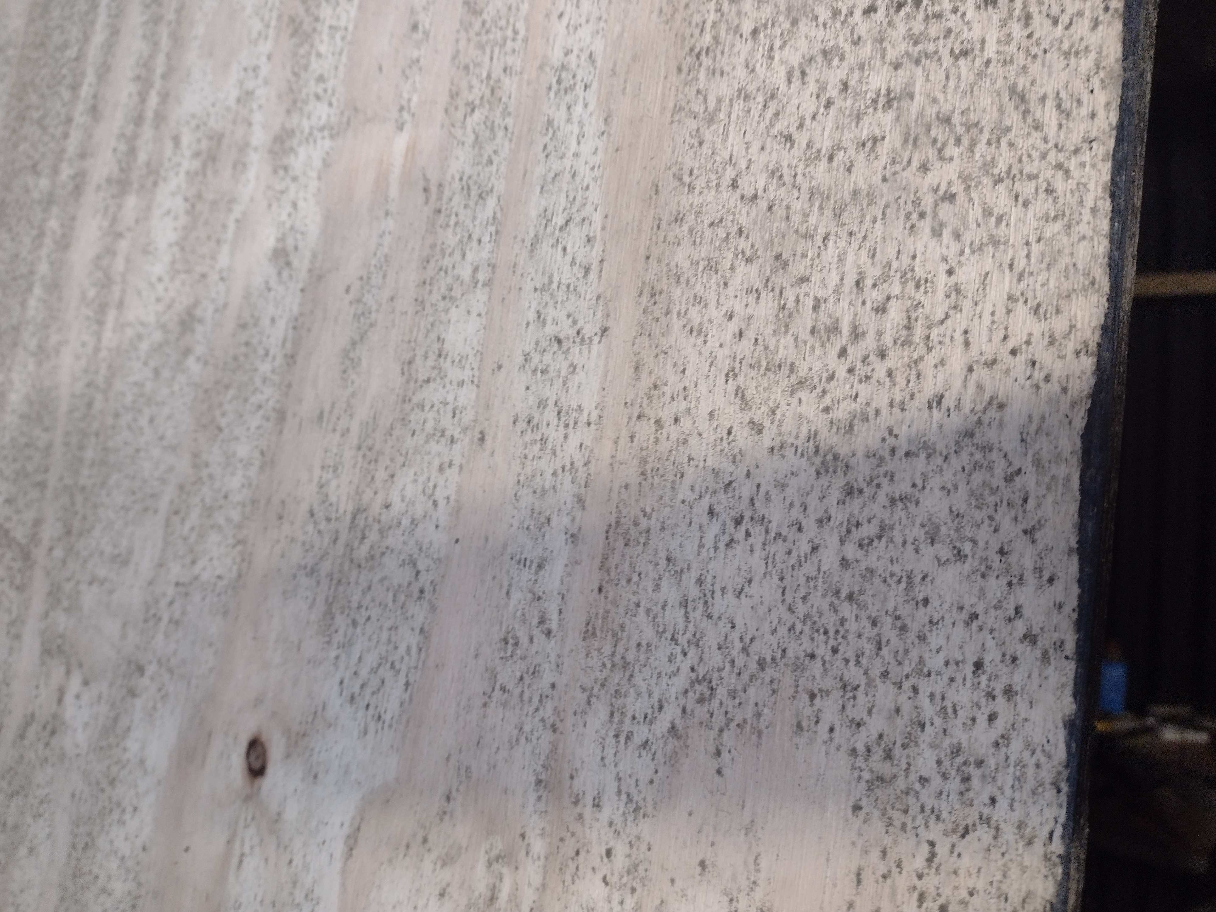

Hi I have some ply wood boards stored in my workshop I am going to use for the floor on my shepherds hut however the boards seem to developed mould on any surfaces exposed to the air. I had six of them standing upright and the ones in the middle seems to be ok. This has thrown a spanner in the works. I have removed the mould using either a belt sander or wire brush, but is the wood ok to use now? Should I apply some sort of mould killer? And should I then protect the wood with tung oil or varnish or something prior to using it for construction? I don't want everything moulding once the hut is made and standing out in the field.
Nb I'm quite surprised about this mould growth as no other timber in my workshop has mould on it, it's only the ply wood boards

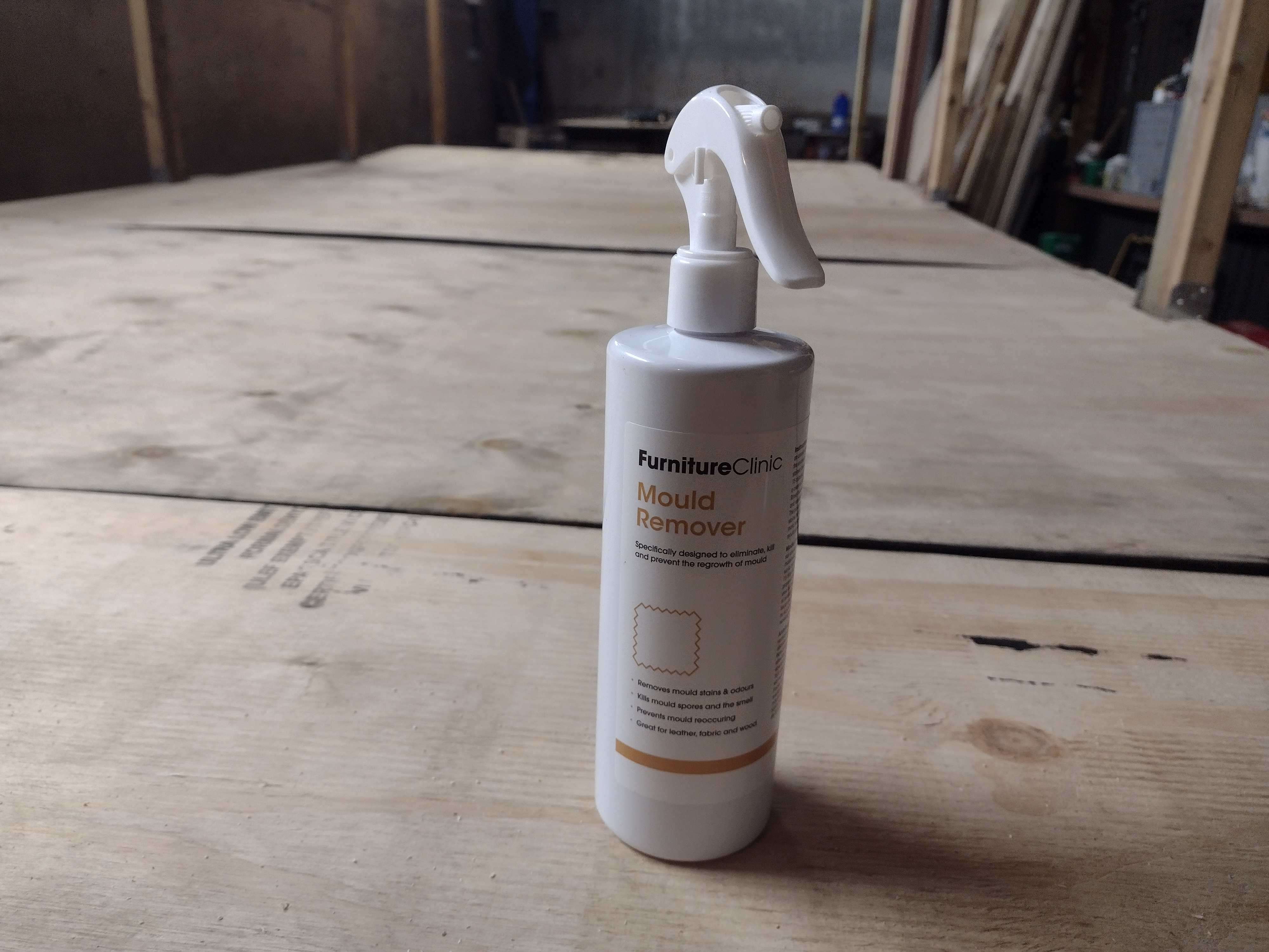

I bleached washed them after sanding/ wire brushing and then I used a proper mould killer as pictured. I used a mask when applying teh mould killer but not whikle sanding however I was standing next my open workshop door whilst sanding so I had access to fresh air but duly noted for the future re masks and sanding.

The mould is back on 2 out of the 5 plywood boards to be used as the sub floor of the shepherds hut. Ffs. How much of problem could this be does anyone know?? Can I just scrub it off and start building or do I need to buy more mould remover? Too many setbacks here, can anyone recommend a good mould remover apparently the I used wasn't up to the job.
