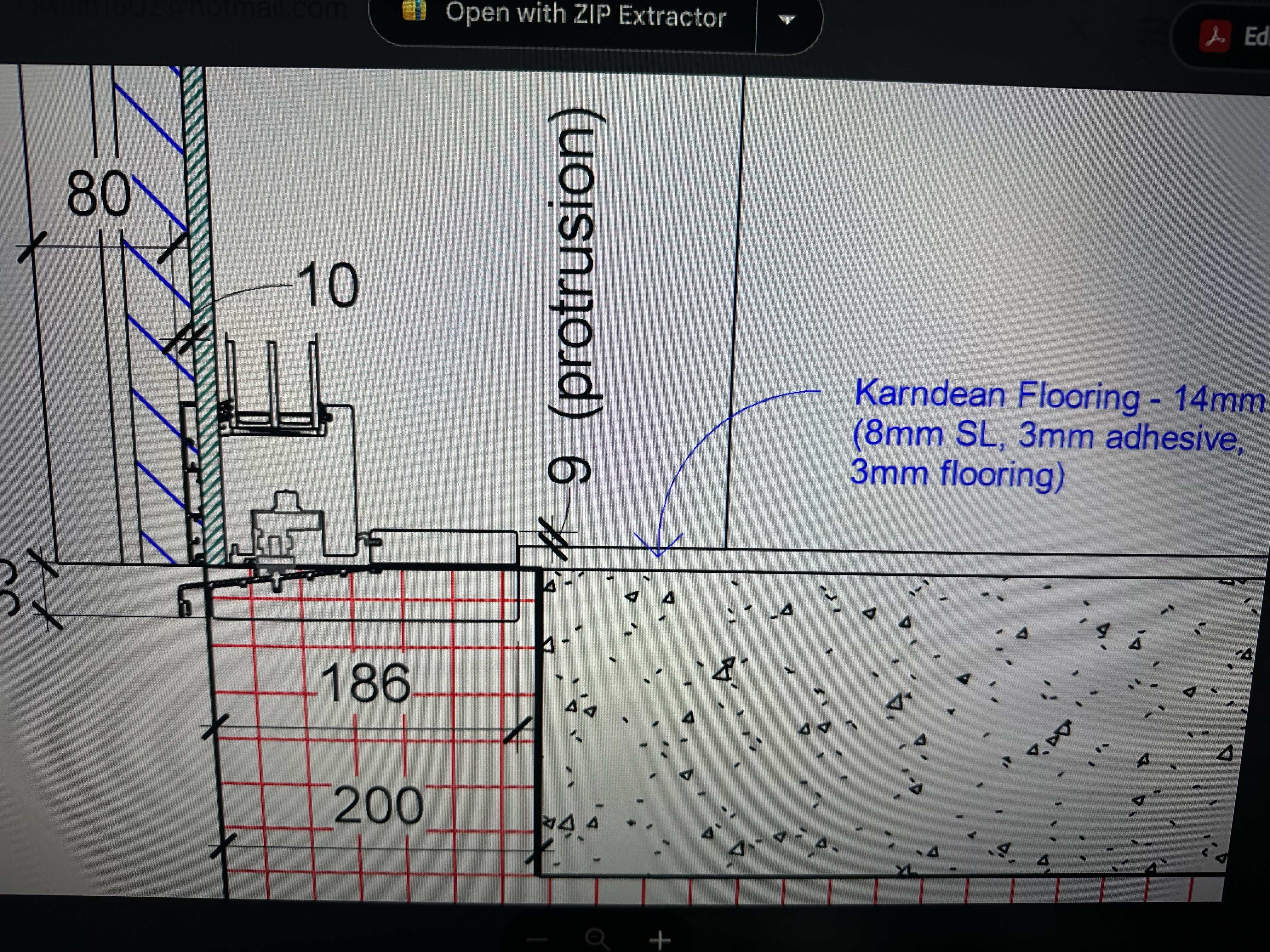

flanagaj Posted January 6 Posted January 6 When we had our technical drawings done for building regulations submission, we hadn't finalised the sliding patio doors and windows, but we knew the sizes. So now, we are thinking about getting started, I've now got loads of questions. 1) Footing details (already discussed this on BH) 2) Level threshold detail, but the build up detail is dependent on the door frame manufacturer Do most people give their tech architect all this information upfront, to enable the associated junction details to be created?
Nickfromwales Posted January 6 Posted January 6 39 minutes ago, flanagaj said: When we had our technical drawings done for building regulations submission, we hadn't finalised the sliding patio doors and windows, but we knew the sizes. So now, we are thinking about getting started, I've now got loads of questions. 1) Footing details (already discussed this on BH) 2) Level threshold detail, but the build up detail is dependent on the door frame manufacturer Do most people give their tech architect all this information upfront, to enable the associated junction details to be created? Give it to the architect if you want to burn money, or get it near as damn it before doing so and reduce the pain. This is an example of what I'm currently producing with a client, Norrsken doors and windows. You can draw this out on paper just as easily and then present to the architect to make it look pretty. 1
flanagaj Posted January 6 Author Posted January 6 16 minutes ago, Nickfromwales said: Give it to the architect if you want to burn money, or get it near as damn it before doing so and reduce the pain. This is an example of what I'm currently producing with a client, Norrsken doors and windows. You can draw this out on paper just as easily and then present to the architect to make it look pretty. I think I need to get on and get details finalised, but I didn't want to get too specific now regarding floor finishes. I've decided to cancel the idea of a power floated floor. Nice idea, but just too much chance of it looking xxxx or going badly wrong.

Nickfromwales Posted January 7 Posted January 7 13 hours ago, flanagaj said: I think I need to get on and get details finalised, but I didn't want to get too specific now regarding floor finishes. I've decided to cancel the idea of a power floated floor. Nice idea, but just too much chance of it looking xxxx or going badly wrong. Only if you use inexperienced (or shite) contractors. You’ll notice in the detail I shared that I’ve allowed for the floated concrete slab to be self levelled, and then feathered to allow a specific level at the threshold (Karndean LVT for this particular clients project) which gives room for ‘human / installer error’. If you’ve discounted a power floated slab, what’s the alternative? 1
Nickfromwales Posted January 7 Posted January 7 To clarify, I’d never assume a slab would be good enough to take to a threshold with zero tolerance allowed. I always assume that we need to build up at the openings (doorways and sliders etc) where you need to be level and just shy of flush for aesthetics. 1
flanagaj Posted January 7 Author Posted January 7 8 hours ago, Nickfromwales said: If you’ve discounted a power floated slab, what’s the alternative? Conventional floor build up. Eg, screed on top of insulation.
Nickfromwales Posted January 7 Posted January 7 3 hours ago, flanagaj said: Conventional floor build up. Eg, screed on top of insulation. Give me the slab every damn day of the week. 1
