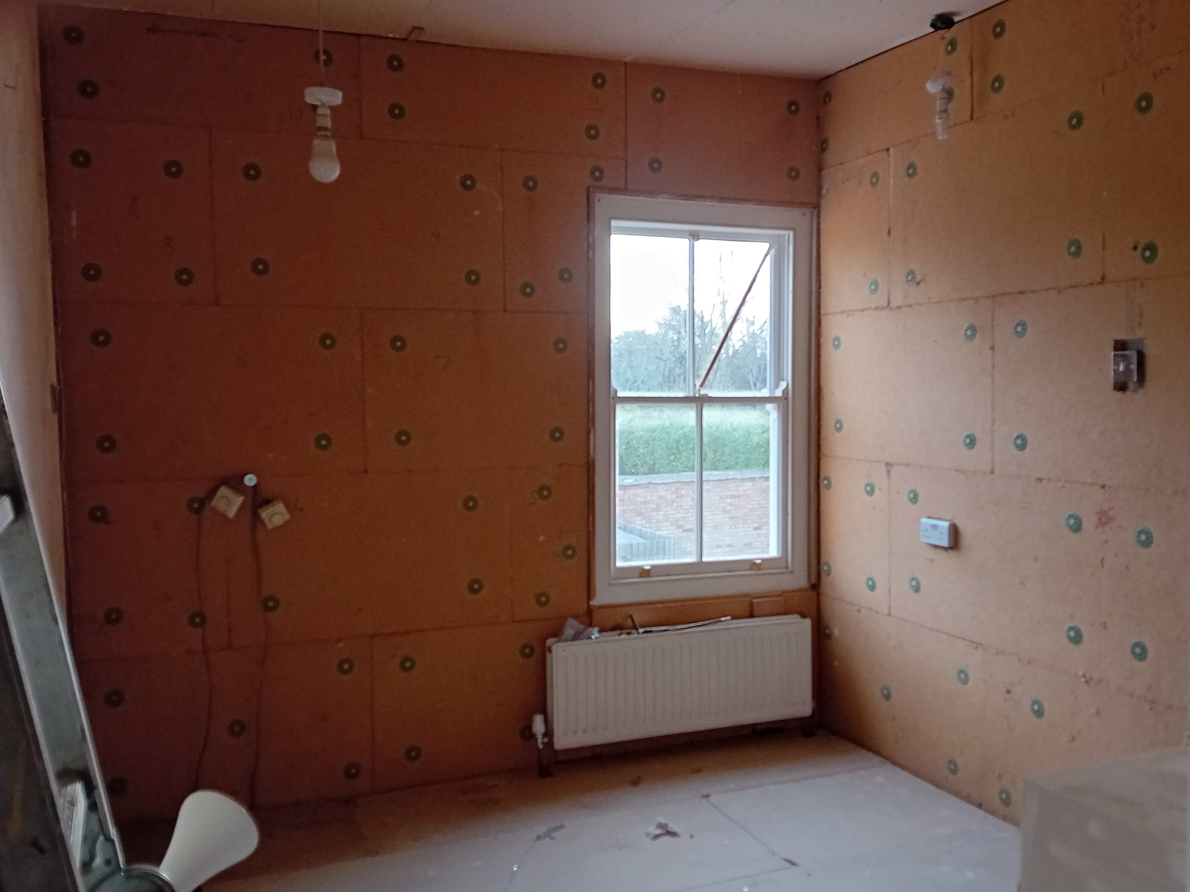

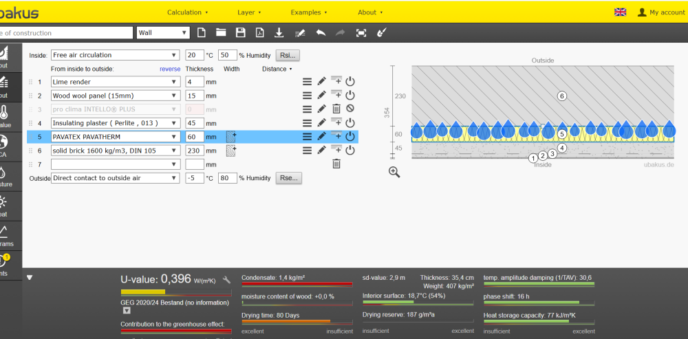

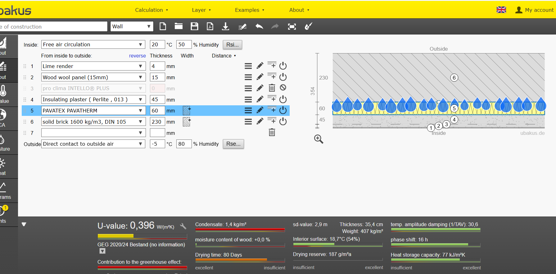

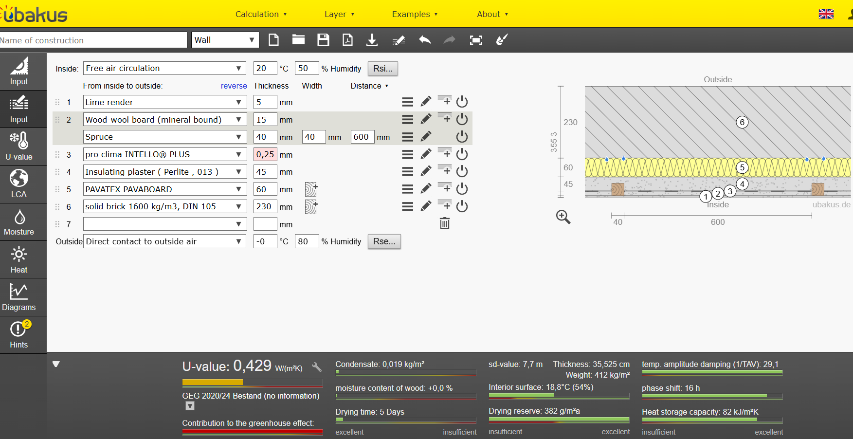

Neverfinished Posted 8 hours ago Author Posted 8 hours ago Hi everyone. Thought I ought to return to this, my blog, & give an update on my progress re. this 'o-so-small' a job of hemp insulation to just 2 outside facing walls, details as described at the outset in my initial blog . . & then a few more questions to you guys if I may !! I indeed proceeded to apply to B.C. who in their own time looked at the intended job & merely listened without objections as I suggested "It'll be difficult to meet U-value regs, given that the wall/s insulation 'build-up' is somewhat governed by need to avoid condensation issues/risks", &, he didn't question or refer me to U-value requirements in any way & seemed to go happily on his way -It being an 1897 terrace in a conservation area they seem keen to support such heritage work in our town. And this brings me to ask for your views re. my layers of build-up: From outside to in, its:- 230mm solid old red-brick; 60mm Pavatex WF (already afixed as seen in pic. above in this blog); Going forward now, I'm applying 45ish mm hemp-lime plaster, though have become concerned that with this much depth & weight it might all fall off before its set! - SO . . I've decided to create a simple timber 40mm deep 'partition wall', screwing it onto the WF (thru to the outer bricks), then apply the hemp'coarse stuff' into all the battened sections of the partition,thus providing a greater surface area too for the plaster to stick to. Then addition of 15mm wood wool boards fixed on to the partition; lime-plaster skim finish. . . . I think this is the most likely way for success - any comments appreciated. Also I've been on Ubakus, to get some kind of condensation analysis. (Can't afford a WUFI). Take a look at the attachment on here - but note:- I've had to substitute materials listed 'in Ubacus' to an extent, for those materials I'm actually going to use - but is an interesting outcome - it shows a serious condensation risk. By further playing with the addition of a VCL - Pro Clima Intello+ (see it greyed out in the current pic.) by 'turning this item back-on' the analysis then shows NO raindrops, ie no condensation !! So . .this suggests I ought add such a VCL into the 'build-up' - expensive but presumably worthwhile adding in a VCL as long as I can get it air tight (always difficult) . . any comments re. all this would be most helpful. Many thanks.
Iceverge Posted 8 hours ago Posted 8 hours ago U Balkus only takes a static shot of the situation at one temperature. -5 outside (you can change this). Unless you live in Baffin Island this weather is unlightly. If you raise the external temperature to something positive you'll see the condensation risk disappears. As long as you don't have to raise it too high, say much above 7 to 8 deg your wall will be drying for more of the year than wetting and it'll be fine. Remember diffusion is only a tiny part of how water makes it way into the wall. Air leaks through bad airtightness are far more significant. Pay attention to external driven rain on old buildings too. Something like a Auto Brick oil will repel water without compromising the walls ability to dry out.
